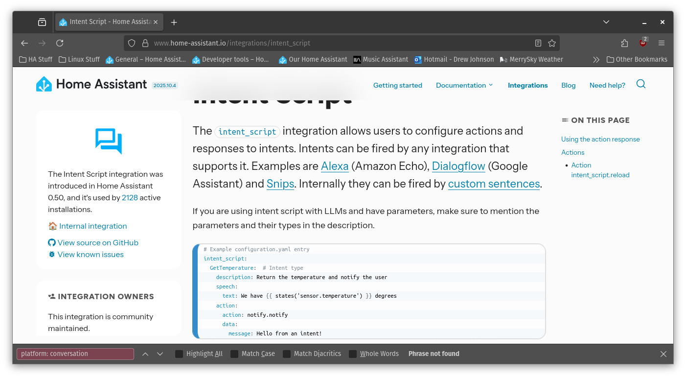

Show me where it’s documented (and I mean a screenshot not a vague reference to first example because the screenshot and link above is the authoritative source and trigger is not on that page)

Now intent_scripts fail silently if they’re not formatted correctly and can’t be called. (sound familiar? You are describing the exact thing that happens when you have a badly formated intent_script ) so… I get that YOU THINK it’s supported can it be possible you’re wrong and the guy who does LLMs ansld one of the best template code users on the site both tell you to try something different?
The following is a screen shot from the address you state you are using, which includes the “first example” you state contains the configuration variable “trigger”. It contains no such configuration variable, and please note the page search results at the bottom show that the phrase “platform: conversation” is not found anywhere on the page:

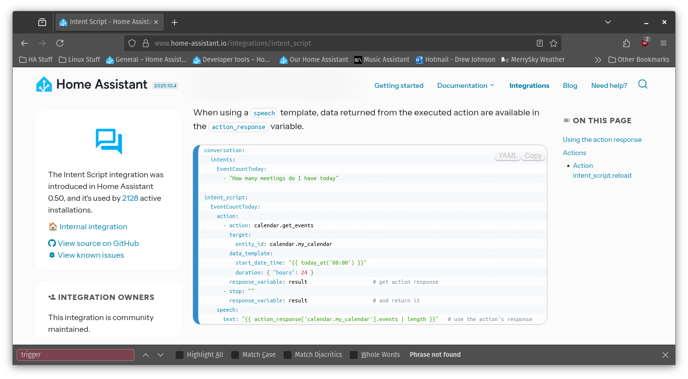

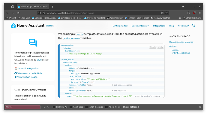

This second screenshot from the same address is of the only other example on the page, note that the page search results at the bottom show that the word “trigger” is not found anywhere on the page:
At this point, between Nathan and I, screenshots have been posted that cover the entire page you claim as your reference. The word “trigger” is demonstrably not found on the page.
Scripts in HA do not have triggers, that includes Intent Scripts.
Please note, there is a Sentence/Conversation trigger which is available in Automations and Trigger-based template entities… it’s just not valid in Intent Scripts.
