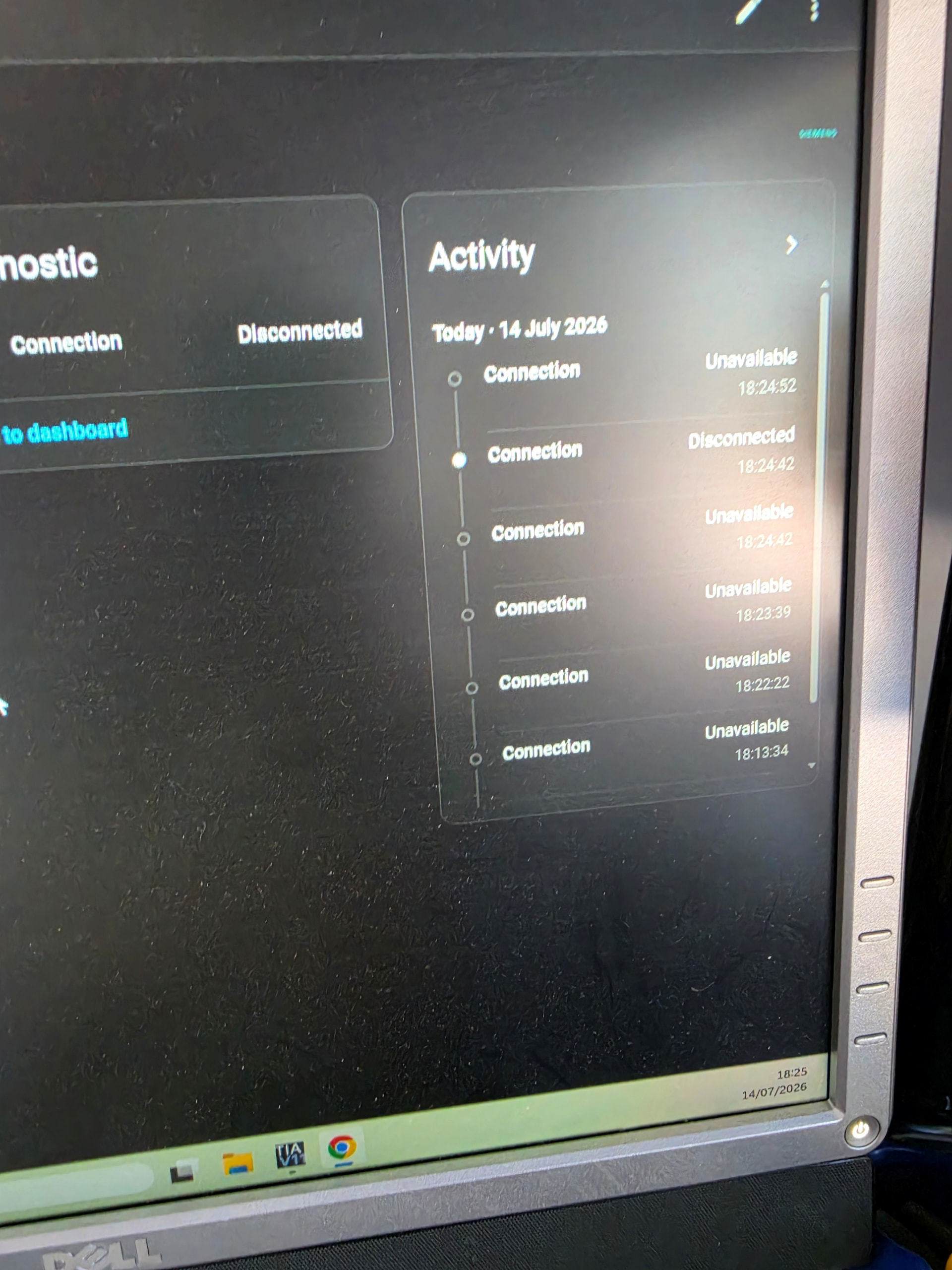

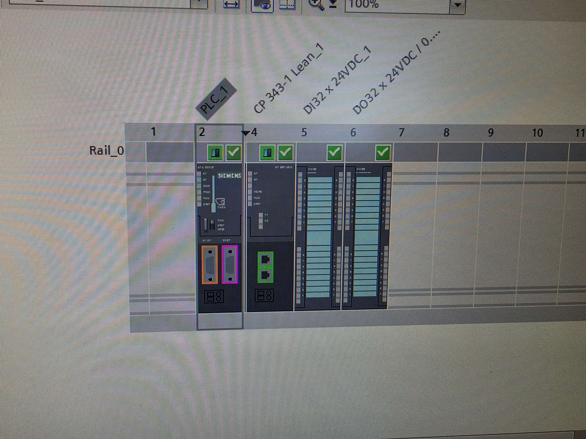

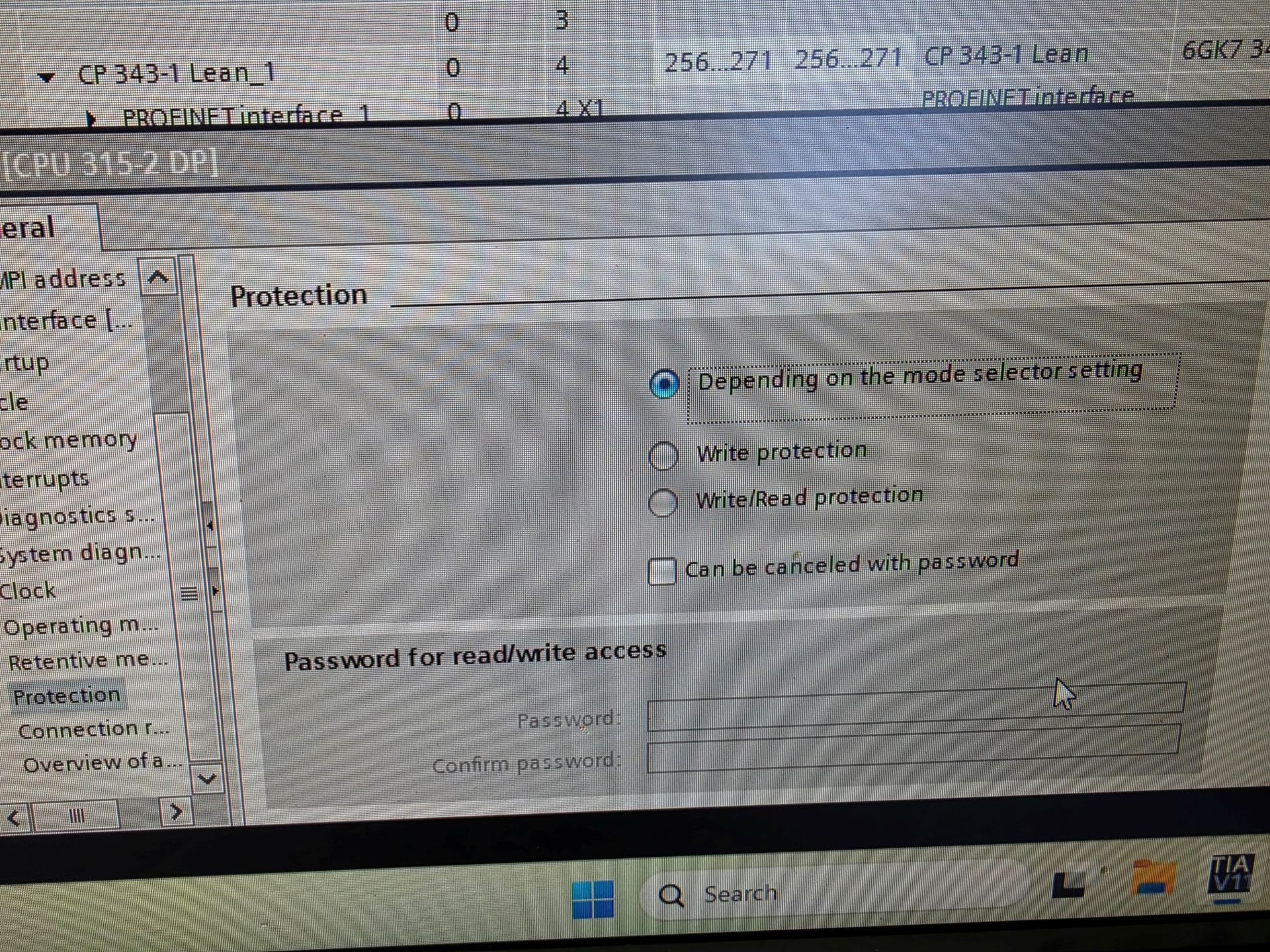

I have been trying to get this integration working with a S7 300 CPU315-2DP AND CP 343-1 LEAN COMMS.
I have made connection with TIA Portal 11 and everything is setup with no errors.
I am then trying to create the connection in the integration, it looks as though it finds the CP but when i check it says Unavailable.
When I try and make the connection with the LAN cable disconnected on the S& setup fails so it must be doing something?
This error originated from a custom integration.
Logger: custom_components.s7plc.coordinator
Source: custom_components/s7plc/coordinator.py:913
Integration: Siemens S7 (documentation, issues)
First occurred: 14 July 2026 at 18:31:01 (12905 occurrences)
Last logged: 12:25:35
Read error
  File "/config/custom_components/s7plc/coordinator.py", line 536, in _retry
    return await result
  File "/usr/local/lib/python3.14/site-packages/pyS7/async_client.py", line 615, in read
    regular_data = response.parse()
  File "/usr/local/lib/python3.14/site-packages/pyS7/responses.py", line 257, in parse
    return parse_optimized_read_response(
        bytes_responses=self.responses, tags_map=self.tags_map
  File "/usr/local/lib/python3.14/site-packages/pyS7/responses.py", line 440, in parse_optimized_read_response
    raise S7ReadResponseError(
        f"{packed_tag}: {_return_code_name(return_code)}"
pyS7.errors.S7ReadResponseError: S7Tag(memory_area=<MemoryArea.DB: 132>, db_number=1, data_type=<DataType.BIT: 1>, start=7, bit_offset=4, length=1): OBJECT_DOES_NOT_EXIST
  File "/config/custom_components/s7plc/coordinator.py", line 913, in _read_all
    results.update(await self._read_batch(plans_batch))
  File "/config/custom_components/s7plc/coordinator.py", line 806, in _read_batch
    values = await self._retry(
        lambda: self._client.read(tags, optimize=self._optimize_read)
  File "/config/custom_components/s7plc/coordinator.py", line 638, in _retry
    raise RuntimeError(
    ...<2 lines>...
    ) from last_exc
RuntimeError: Operation failed after 4 attempts (s7_response): S7Tag(memory_area=<MemoryArea.DB: 132>, db_number=1, data_type=<DataType.BIT: 1>, start=7, bit_offset=4, length=1): OBJECT_DOES_NOT_EXIST
Source: custom_components/s7plc/coordinator.py:816
Batch read failed for 1 tags: Operation failed after 4 attempts (s7_response): S7Tag(memory_area=<MemoryArea.DB: 132>, db_number=1, data_type=<DataType.BIT: 1>, start=7, bit_offset=4, length=1): OBJECT_DOES_NOT_EXIST
Batch read failed for 2 tags: Operation failed after 4 attempts (s7_response): S7Tag(memory_area=<MemoryArea.DB: 132>, db_number=1, data_type=<DataType.BIT: 1>, start=7, bit_offset=4, length=1): OBJECT_DOES_NOT_EXIST
Logger: pyS7.async_client
Source: custom_components/s7plc/coordinator.py:239
First occurred: 14 July 2026 at 18:22:42 (8 occurrences)
Last logged: 14 July 2026 at 18:29:51
Socket error during communication: [Errno 104] Connection reset by peer
Communication error during connection setup: Socket error during communication: [Errno 104] Connection reset by peer
Failed to connect to 192.168.0.95:102: [Errno 113] Connect call failed ('192.168.0.95', 102)
Any ideas please?
