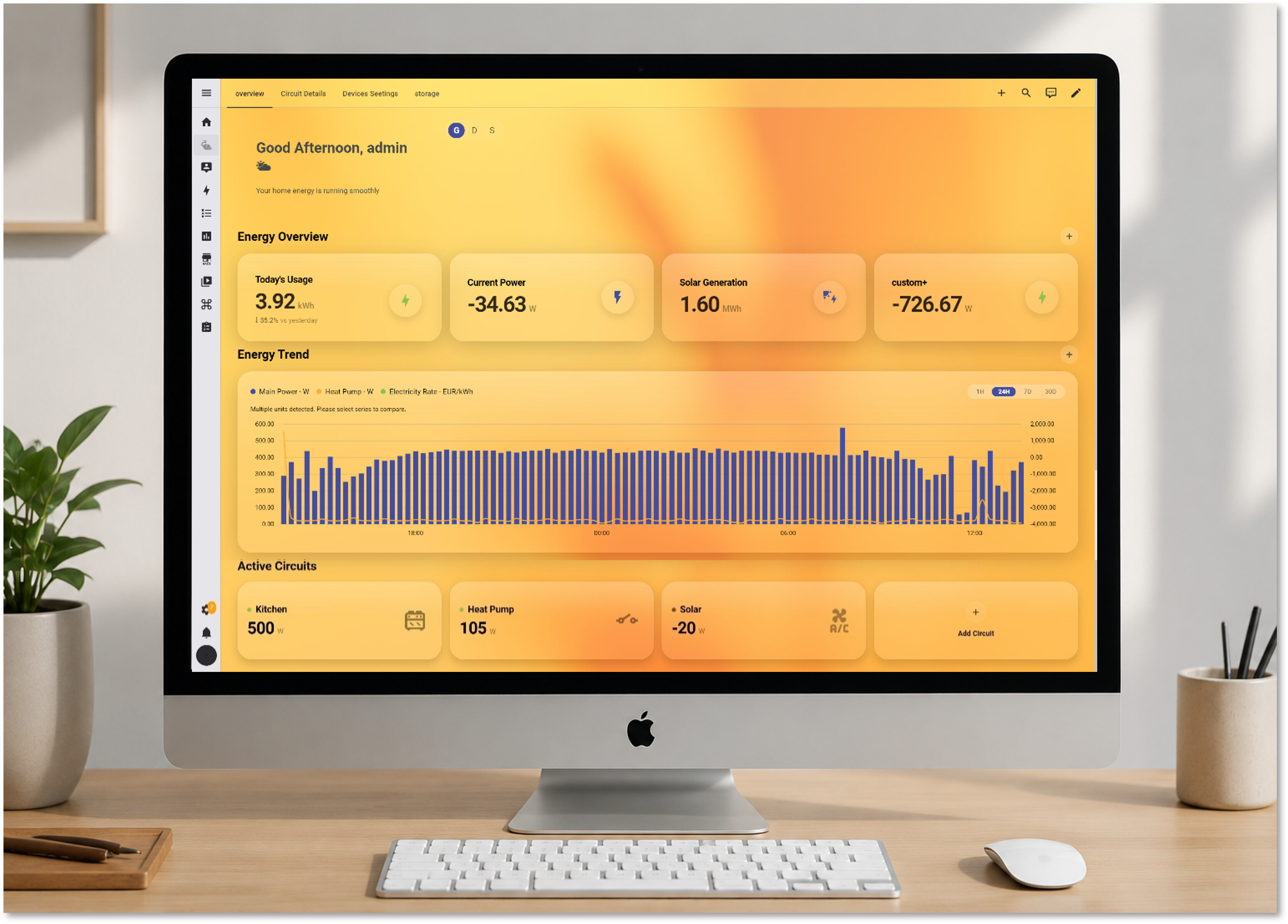

(Dashboard overview image here)
The overall design is inspired by modern smart home applications. Rather than presenting energy data as a collection of numbers, the goal is to provide a clearer overview of how energy is being used throughout the home.
The dashboard currently consists of three main sections. Energy KPI provides a quick overview of key energy metrics such as current power, today’s energy usage, energy cost, and other customizable indicators. It supports flexible configuration of Home Assistant entities, custom titles, icons, and units, automatic power and energy unit conversion, and easy card management directly from the user interface. Energy Trend is designed to visualize how energy data changes over time. Since many energy sensors update very frequently, displaying every raw data point can result in noisy charts, so the Trend card uses smoothed curves by default to highlight overall trends while also offering a precise mode for viewing the original data. It currently supports multiple data series, different chart modes, configurable time ranges, and multiple Y-axes. Circuit Monitoring focuses on the real-time status of individual electrical circuits, displaying information such as power consumption, device icons, status indicators, and last update times to help users quickly identify high-power devices or unusual circuit activity.

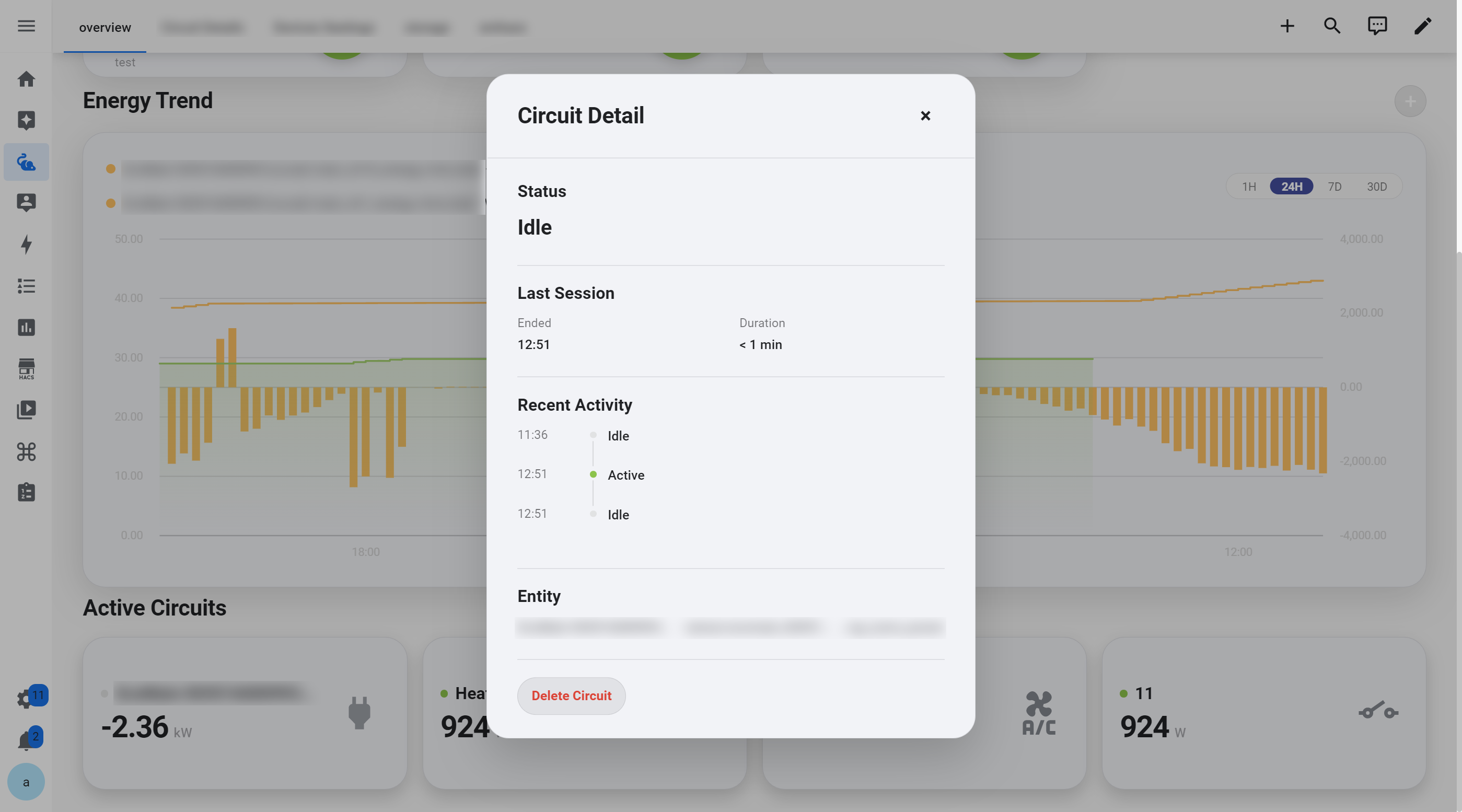

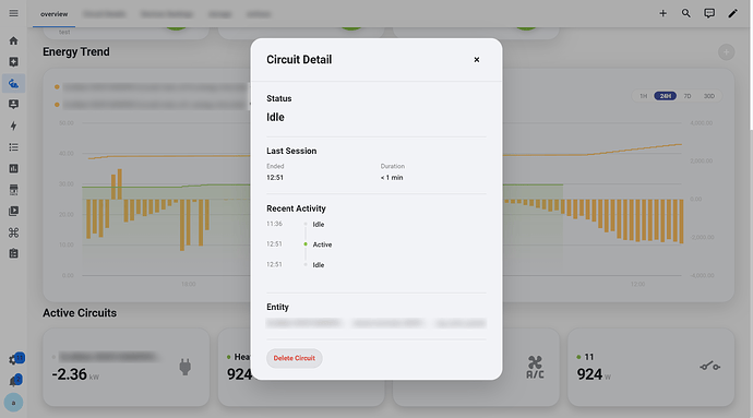

The biggest change is a clearer separation between viewing and editing. Clicking a card on the dashboard is now reserved for viewing more detailed information, rather than mixing viewing and configuration into the same interaction. The existing + button remains the main entry point for managing which cards are displayed. !
I also added a Home Assistant-style visual configuration editor for the card groups. KPI, Trend and Circuit sections can now be configured through a more native editing workflow instead of relying primarily on interactions inside the dashboard itself.
Individual card editing has moved into this configuration experience as well. For KPI and Circuit, clicking a card directly in the editor preview opens its individual settings, so the dashboard itself can remain focused on everyday use while configuration stays inside Home Assistant’s editing flow.

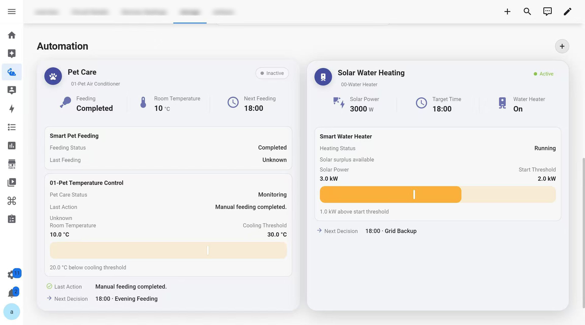

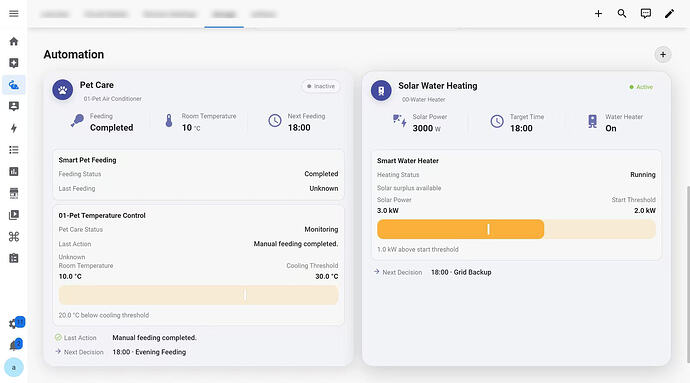

New — Automation Scenarios
This update introduces Automation Scenario, designed to bring Home Assistant automations directly into the Dashboard.
A real-world home scenario often involves more than a single Automation. It may include multiple automations, sensors, and devices working together. Automation Scenario brings these related elements into a single Scenario, turning separate automation rules into a more complete experience that is easier to understand and control.
Three examples are currently included:
· Solar Water Heating
· EV Smart Charging
· Pet Care
You can also start from Custom / Blank to create your own Scenario using your own entities and existing Automations.
Each Scenario focuses on the information that matters most for that use case, including current status, key data, automation activity, progress or thresholds, as well as Last Action and Next Decision. This makes it easier to understand what the scenario is doing now and what it is likely to do next.
Clicking a Scenario opens a unified control panel for everyday interaction. Users can adjust scenario modes and strategies, control related devices, enable or disable linked automations, and use Manual Override when needed.
More detailed setup is handled through the visual configuration editor. Here, users can configure what appears in each Scenario, including live information, status and progress displays, scenario controls, device controls, and the grouping and linking of existing Home Assistant Automations or Blueprints.
Automation Scenario follows the same design and interaction language as the existing KPI, Trend, and Circuit cards, extending the dashboard from simply viewing energy data to also understanding and interacting with how the home responds to it.
A complete Home Assistant Automation YAML is included below using Solar Water Heating as an example. You can expand the section to view and copy the full configuration.
Solar Water Heating
This example automatically controls the water heater based on available solar power:
· When solar power stays above 2000 W for 10 seconds, the water heater turns on and switches to the Solar strategy.
· When solar power stays below 800 W for 30 seconds and it is before 17:00, heating stops and waits for solar power to recover.
· After 17:00, if heating is still needed, the water heater turns on and switches to the Grid strategy.
· When Manual Override is enabled, the automation will not run.
