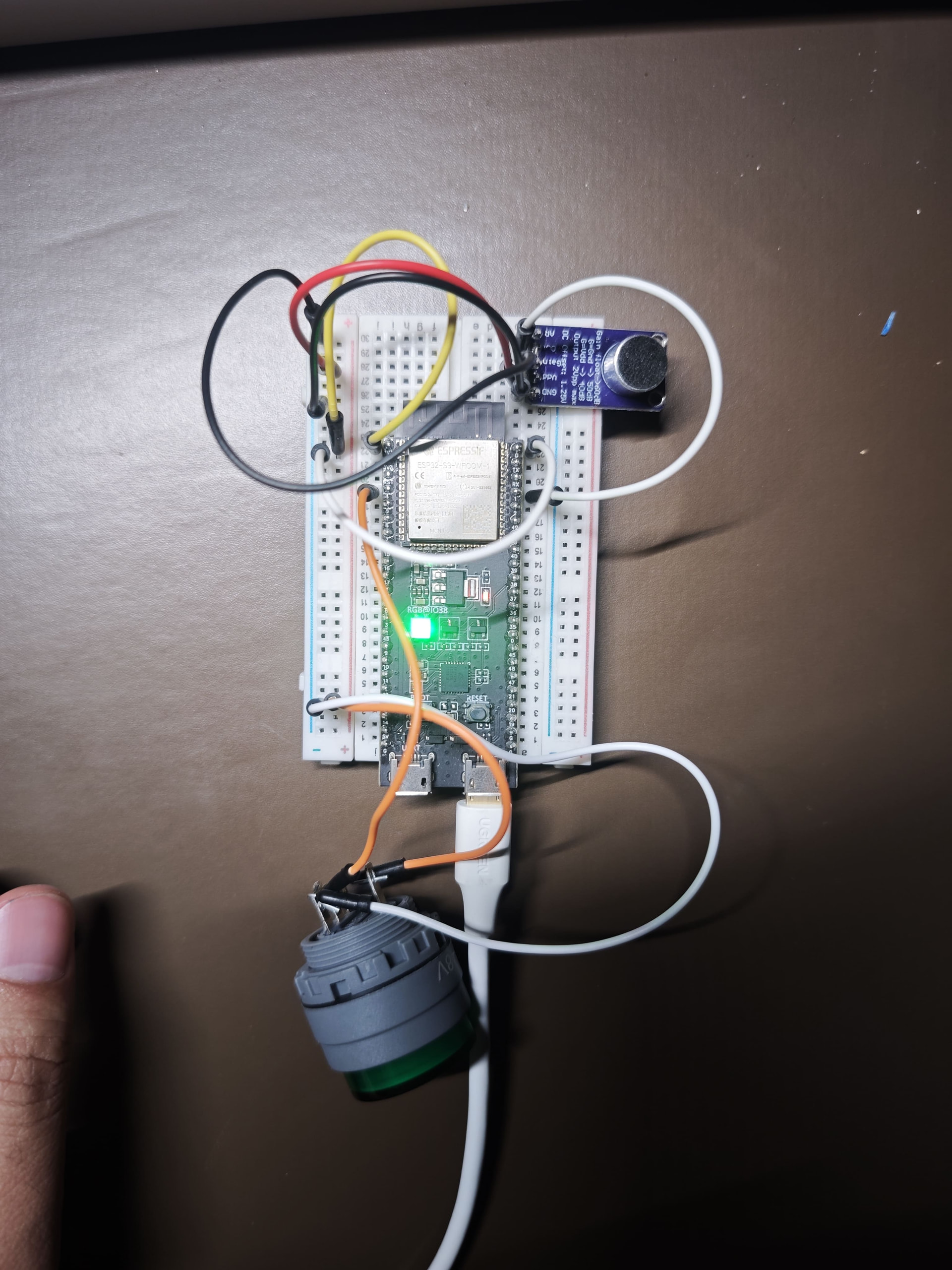

Hardware
| Component | Cost |
| ESP32-S3-DevKitC (WROOM-1 N8) | already owned |
| MAX9814 electret mic with AGC | ¥5-6 (~$0.80) |
| Momentary push button | ¥2 (~$0.30) |
| Total BOM | ~¥8 (~$1.10) |
3 wires: GPIO1 (ADC) → MAX9814 OUT, GPIO4 → button → GND. Solder GAIN to GND for 50dB desktop sensitivity.
Stage: This is a functional demo/prototype. Future hardware iterations may evolve into a smart knob form factor — a rotary encoder with push-to-talk, volume control, and a small display — staying on the desk as a dedicated intercom controller.
