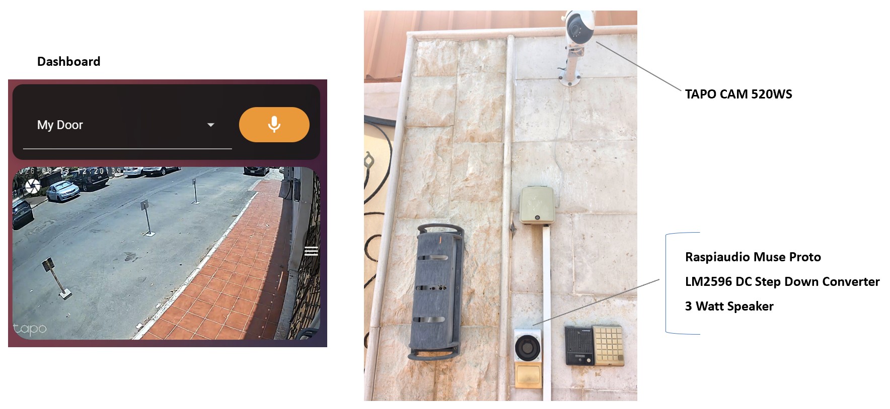

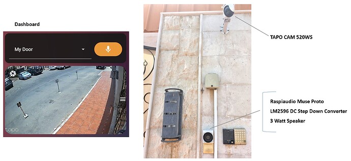

This project is a solution to a problem I was facing. I wanted to talk to the person at my door without using my camera’s two-way audio go2rtc, which was not working for me.
I tried several solutions with my Tapo 520WS camera, but I couldn’t get the two-way audio to work reliably. So, I built a simple alternative using Home Assistant and a Raspiaudio Muse Proto.
How it works
When someone rings the intercom:
I press a button in Home Assistant dashboard to record my voice as an MP3 file using the Voice Recorder Card: https://github.com/kukuxx/HA-Voice-Recorder-Card & sends the recorded file immediately to the Raspiaudio Muse Proto, which is connected to a 3W speaker near the door and the camera, so the person at the gate can hear me.
I can hear the person at the gate through the camera and communicate with them: they can hear my voice through the speaker, and I can hear their voice through the camera using https://github.com/dermotduffy/advanced-camera-card

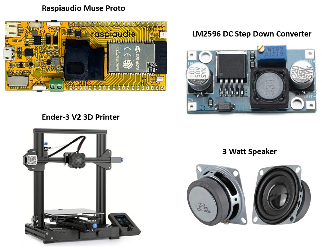

- Any type of camera installed at the gate.
- Raspiaudio Muse Proto, flash it with (ESPHome Media Players)
- 3W speaker.
- 9V → 5V step-down converter (LM2596).
- Wires & 3D-printed case (https://www.thingiverse.com/thing:5569337)

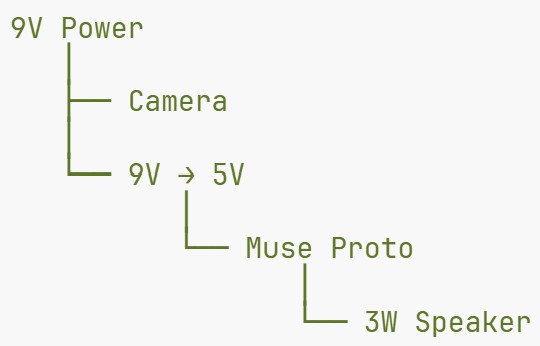

I use the camera’s existing 9V power supply.
