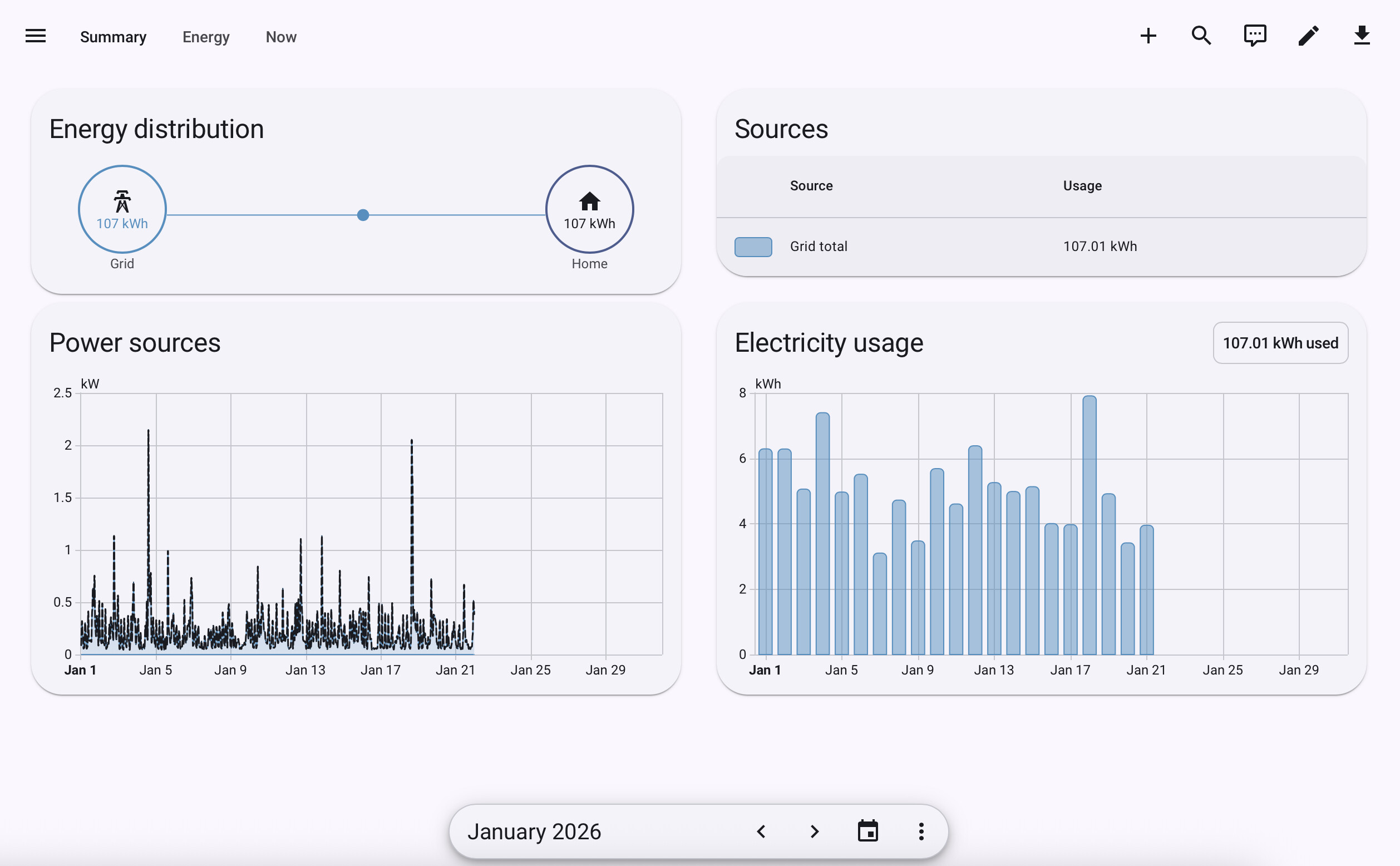

In the meantime, the consumption recorded on the day of 16th August 2025 was 13.951 kwh on Leneda, but it was registered into Home Assistant for 1th August 2025 between 4AM to 5AM. Not sure if this was intended or a side effect of Home Assistant recorder setup.
Here is my attempt at a custom integration for Leneda. I hope it could be of help to you all. I am able to pull the power and energy data into a couple of sensors that show up in the Energy dashboard.

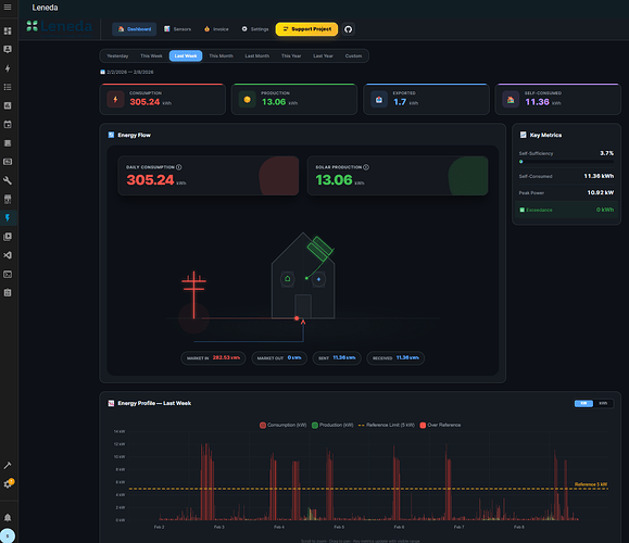

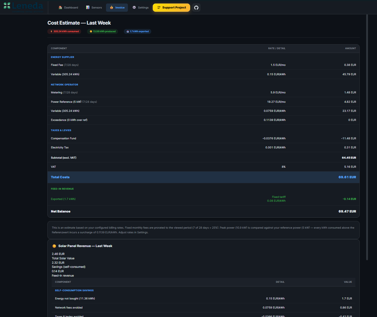

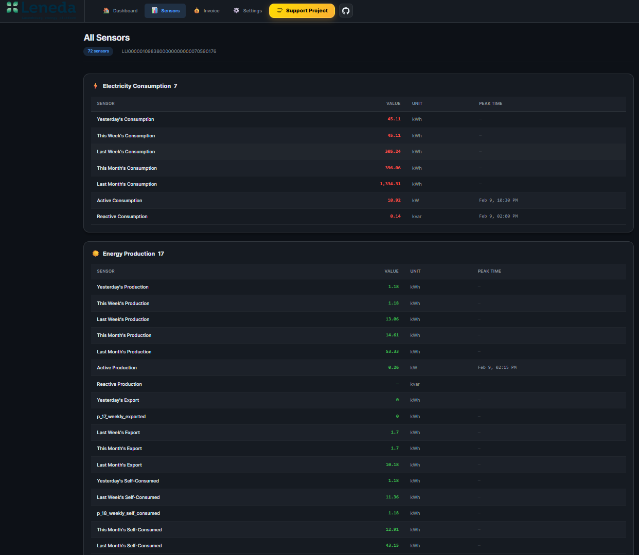

Updating an old post: here are the two options I’m aware of. I’m using the Leneda Power one in HACS, I can’t vouch for the other but it looks good.
