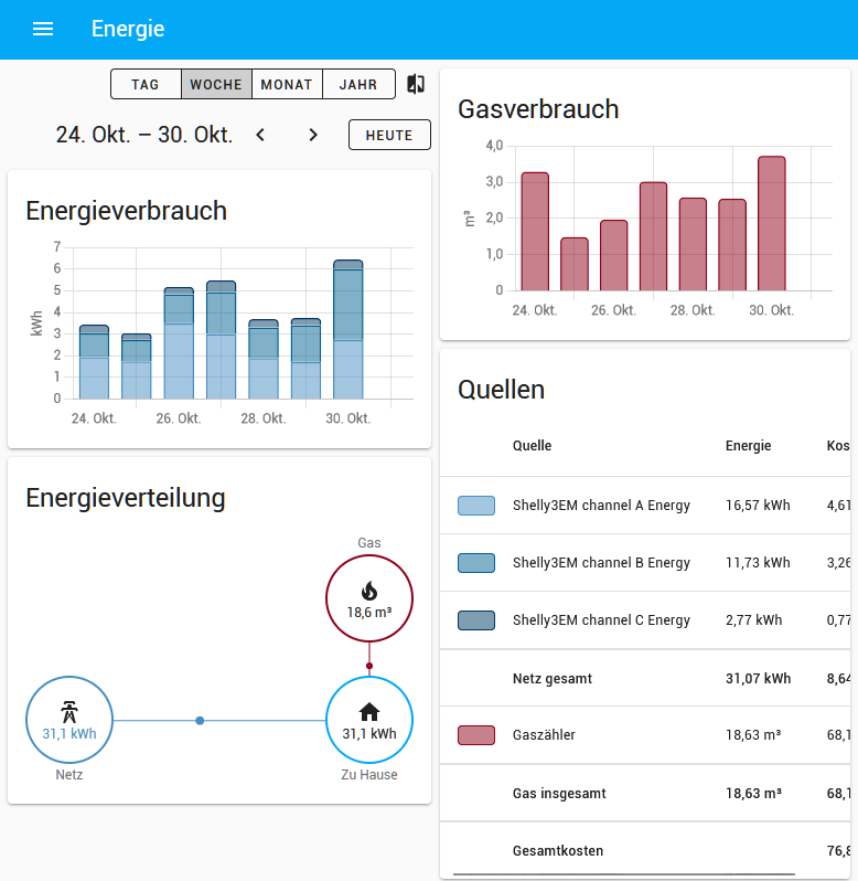

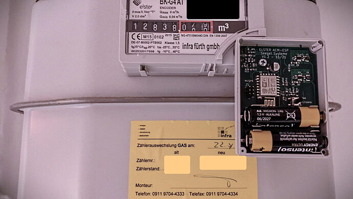

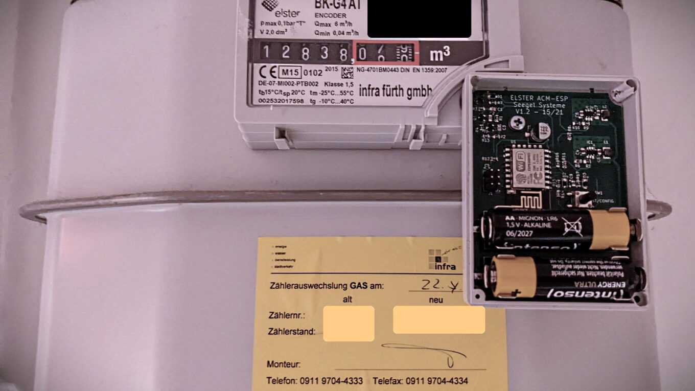

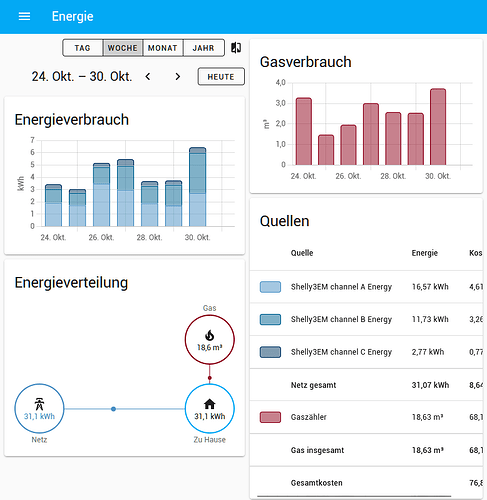

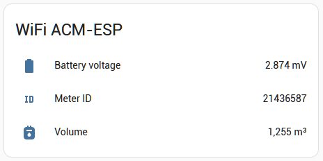

I built an interface called WiFi ACM-ESP, based on an ESP8266 which can be connected to BK-G4…A gasmeters. It reports the values of the meter via MQTT autodiscovery to home assistant or other targets. The readings are always absolute as the meter has optical encoders.
