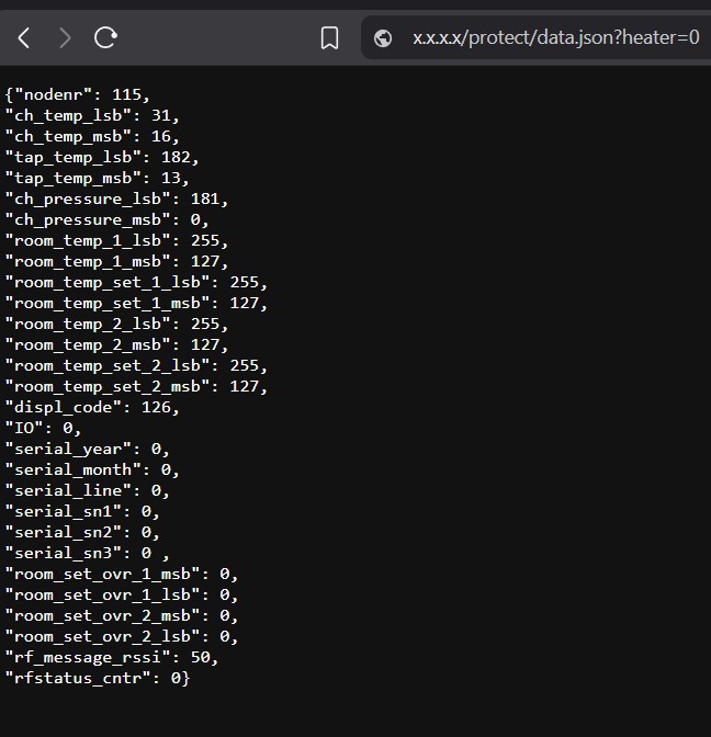

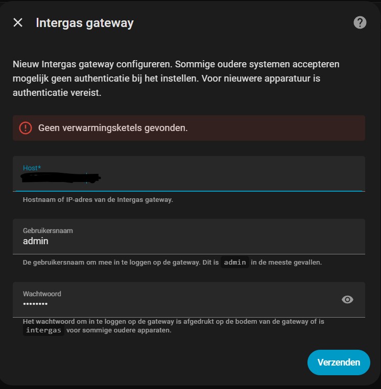

Hi All,
Tried to install a new Intergas Incomfort Gateway, and in the app I’m seeing my Heater. When I connect tot GW with an browser the heater is also showing.
When I rum the integration it says “geen verwarmingsketels gevonden”.
when i rum: http://x.x.x.x/protect/data.json?heater=0 (with my GW adres) it shows info of the heater.
Can somebody help me to solve this?
