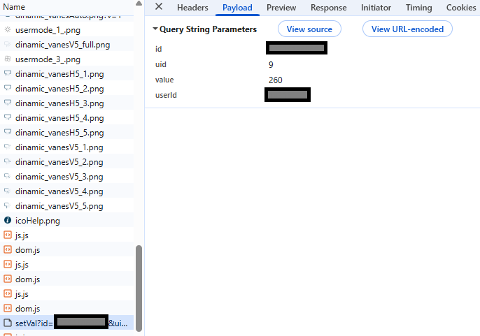

I’ve read that their web API is read-only, but then I have to ask my silly question: how is it possible, then, if their web API is read-only that in fact I can exercise control to my AC unit using their website? Isn’t it my web browser, by loading a bunch of HTMLs, JavaScripts, CSS, etc that sends HTTPS traffic to their web server and this causes a control operation to my AC unit?
Couldn’t this be “simulated” using a Python script? Maybe capturing what does a web browser when sending a command would reveal what can be the correct way of exercising control via their web-based interface.
Here’s the login capture, removed my personal data for obvious reasons:
The received token is used in cookies afterwards thoughout all the session for all web requests.
And setting a temperature looks like this, from my web browser:
I think that completely avoiding the push socket is doable. I don’t say it’s easy, but should be doable, as a web browser ran locally on my computer is capable of doing. We should be able to make the same requests and use their web path. This will avoid future issues with their push socket and permanent connections, which for sure was not their intended use.

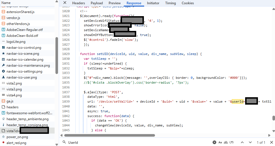

EDIT: I just tried a little bit more to understand what my browser does, and I find how my userId is determined, which is a parameter for setting values to my AC unit:
When loading the control panel after clicking “Control” on the main page after login, it shows the list of devices in my account and one of them with all its status is displayed. In vista we can find a set of JS functions, one of which is setUID. I think this is the gold we were looking for.
What’s your opinion? Is it something doable, are there any technical issue I didn’t found that makes the web interface read-only for PyIntesisHome?
