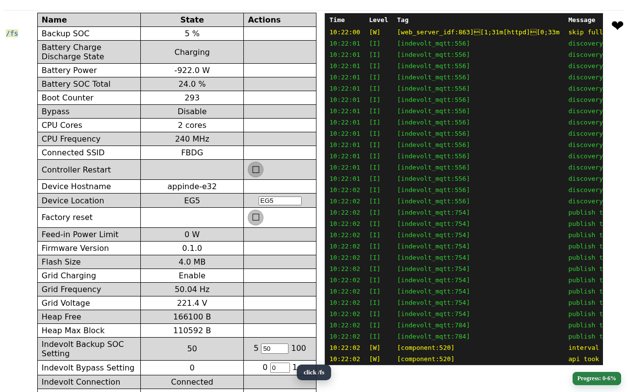

However, my focus is not on LVGL-based rendering, but on HTML.
The foundation is a web-based file-server approach that supports uploading and downloading application files.
I use AlpineJS as the reactive framework, stored on the controller, so there are no external dependencies.
Right now, I’m working on an ESPHome application for the Indevolt SolidFlex balcony power system with LiFePO batteries.
Once all data sources are connected, UI changes no longer require recompiling controller code. You only need to upload the modified web pages.
Here is a short GIF animation of the UI.
ui-flow
Interesting. To make sure I’m following, you are showing an html page in a widget on the esphome device?
The ESPHome controller serves the HTML page, but it’s rendered client-side in the browser using Alpine.js.
