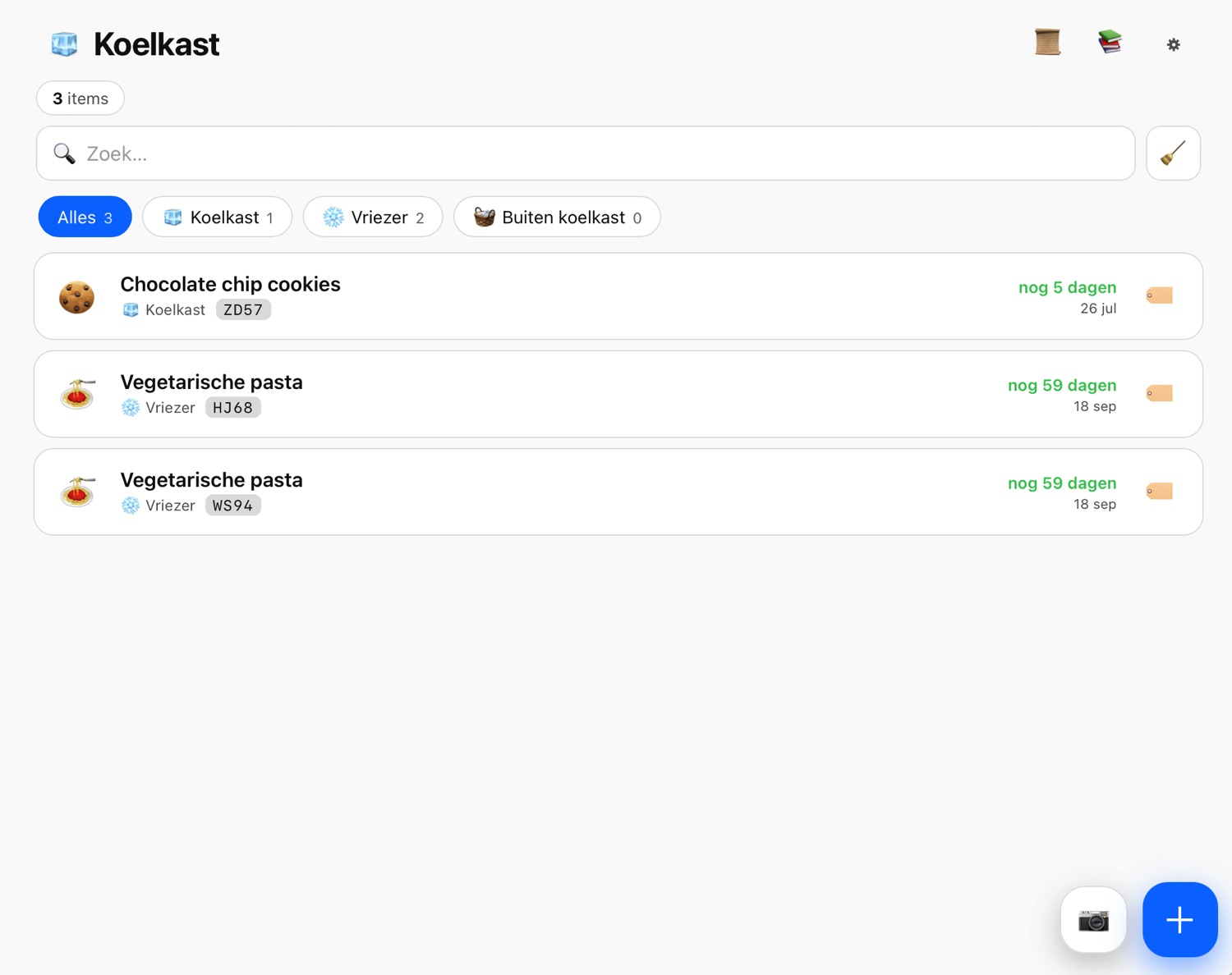

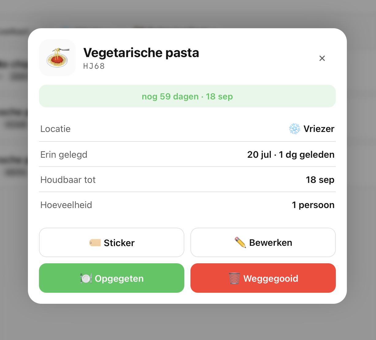

I want to share something I’ve been building over the last couple of days: Fridge Assistant, a native Home Assistant custom integration that turns your fridge, freezer and pantry into a proper searchable inventory. I love it!
Why I built this
The usual story: food going bad in the back of the fridge, freezer containers with no idea what’s inside or since when, and me constantly forgetting what I actually have before doing groceries. I looked around for something that would fit into Home Assistant natively instead of yet another standalone app on my phone, and didn’t find quite what I wanted
What it actually does
A few things I’m genuinely proud of:
  • :spiral_calendar: Automatic expiry dates. Type “milk” or “leftover lasagna” and it estimates how long it keeps, per location (fridge/freezer/pantry), from a built-in database of ~99 products and dishes. It’s deliberately conservative about matching, it’ll ask rather than silently guess wrong (typing “pizza” won’t quietly turn into “cheese”).
  • :sparkles: AI estimates for anything else, using whatever conversation agent you already have set up in Home Assistant (OpenAI, Anthropic, Gemini, Ollama, whatever), or a direct OpenAI key if you’d rather. Ask it about something obscure and it gives you a food-safety-minded shelf life, category, emoji and a storage tip, editable before you save. You can save it as a template with one tap so it knows it next time.

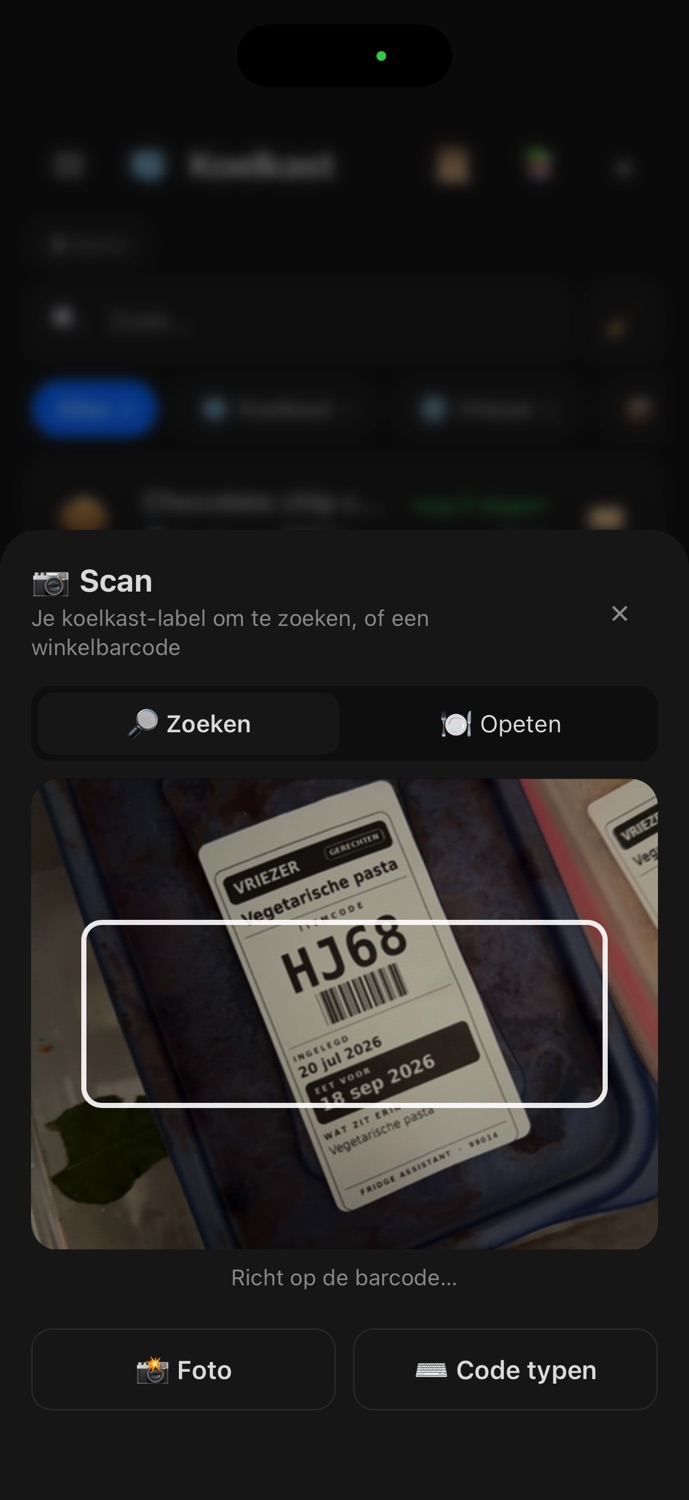

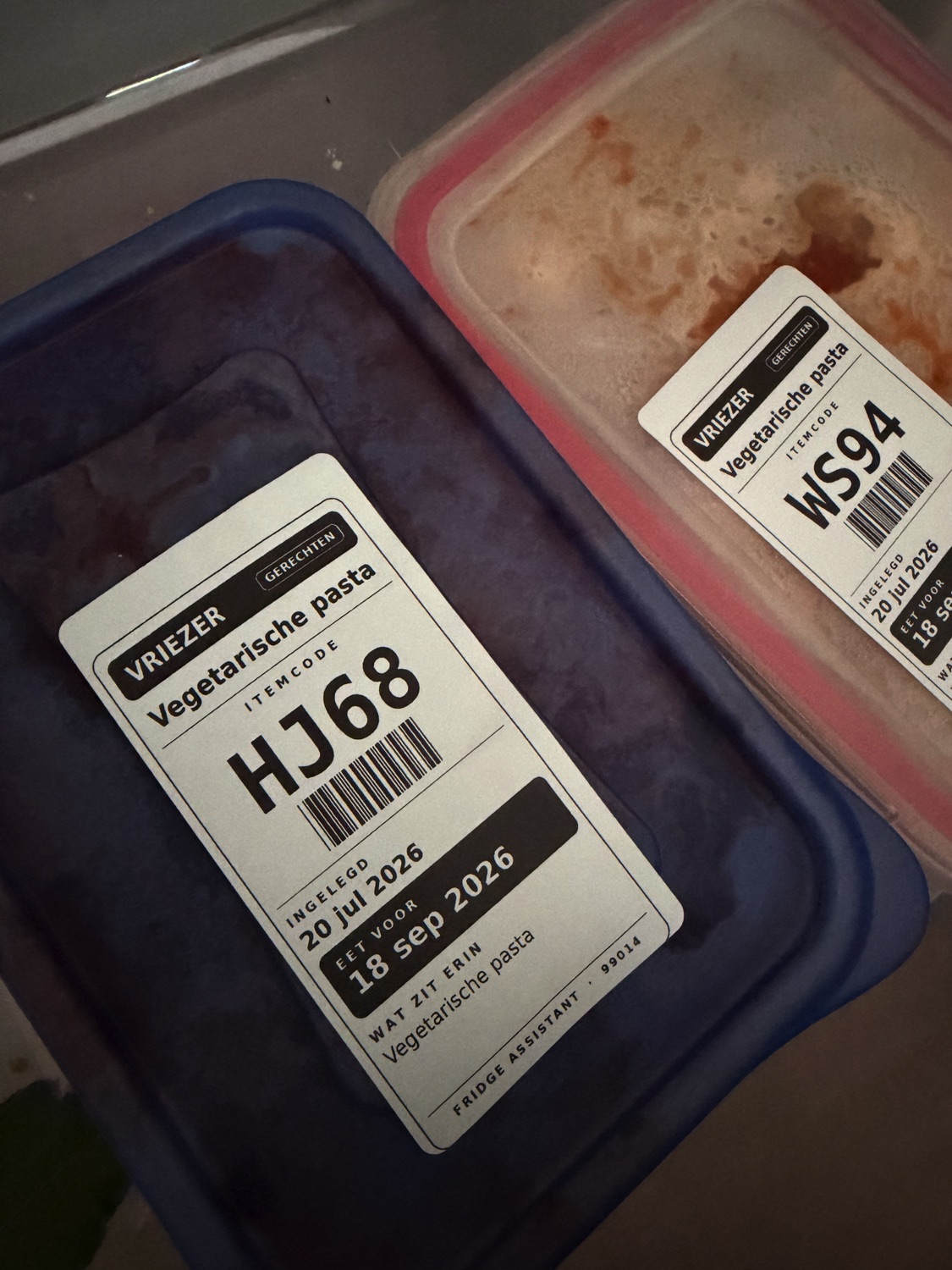

  • :label: Printed stickers, for the real pros. Every item gets a unique little code (AB12-style), and if you hook up the companion label printer add-on, you get an actual physical sticker with a scannable barcode, sized for a DYMO 99014 label. I’m running it on a DYMO LabelWriter 400 in my kitchen and it genuinely feels like a proper labeling system now, not a toy.
  • :camera: Barcode scanner, right from your phone camera. Scan your own printed sticker and the item pops up instantly. Scan a retail barcode (an actual product from the shop) and it looks it up against Open Food Facts and pre-fills the name, category, quantity and photo for you — you just confirm location and date. Works on iOS too (bundled ZXing decoder, since Safari doesn’t have the native barcode API).

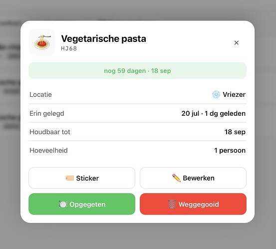

  • :bust_in_silhouette: Multi-person tracking. Every item remembers who put it in (with their HA person avatar), and finishing something, eaten or tossed, gets logged with who/when in a full history you can page through. Every finish action can be undone.
  • :bell: Daily notifications for anything expiring soon or already past date, and a one-tap clean-up mode to clear out everything that’s gone off.

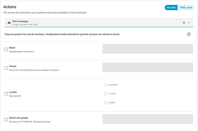

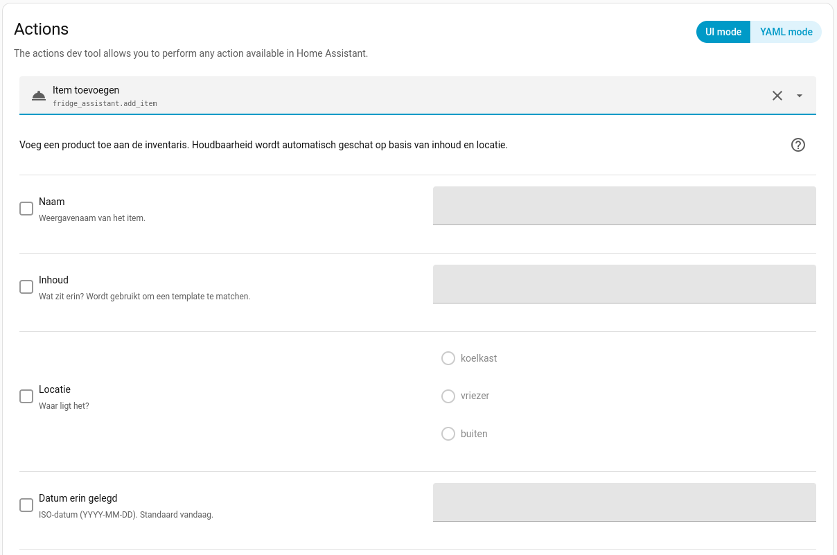

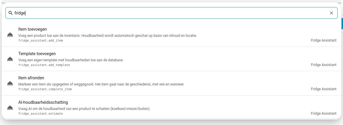

If I use Developer Tools | Actions all the fridge_assistant actions are in Dutch.

Thanks, i use another openai model that works. The language problem and this openAI problem is fixed in the repo now, so if you install or update it it’s fixed!

That was it. Got the scanner now, but no scan - just “Point at the barcode”. Permissions thing on the phone?
