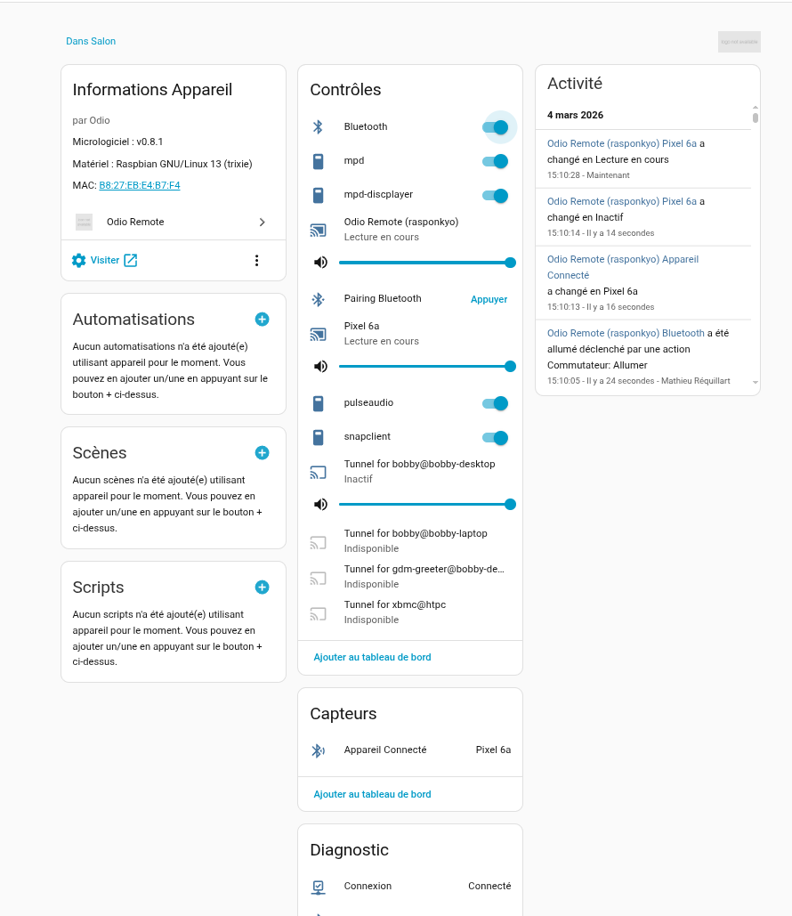

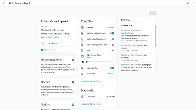

Your Linux machine can be auto-discovered via Zeroconf (mDNS) . Everything groups under a single “Odio Remote (hostname)” device. Backends are configured server-side, HA discovers them automatically via the API.
Entities
  • media_player.odio_remote_[hostname]: Main hub. Global PulseAudio/PipeWire volume & mute. State: playing / idle / off.
  • media_player per mapped systemd service (e.g. mpd.service): Start/stop + volume/mute via Pulse/PipeWire.
  • media_player per remote tunnel client: Volume/mute for PipeWire tunnel clients from other hosts.
  • button: Power off / reboot (if power backend is enabled).
  • switch per user service: Direct start/stop toggle.
  • binary_sensor: API connectivity status (diagnostic).

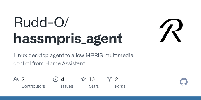

Did you know about this?
Has auth, supports MPRIS media players as entities in HA, event push instead of polling (instant updates).

Just released v0.7.0 of odio-api Release v0.7.0 · b0bbywan/go-odio-api · GitHub with bluetooth sink support.
I’ll add MPRIS and Bluetooth support to Odio-ha when I migrate it to SSE. It should be released in the coming weeks, I’ll make a complete new post then.
SSE has landed on go-odio-api v0.8.1 ! Release v0.8.1 · b0bbywan/go-odio-api · GitHub.
Extremely lightweight, runs on my Raspberry B+ from 2016 with less than 20Mb of RAM
odia-ha 0.5.1 already available on HACS with SSE Support. Odio-ha now reacts immediately and issues caused by polling have completely disappeared.
odio-ha 0.6.0-rc.1 in pre-release on HACS for bluetooth management entities
