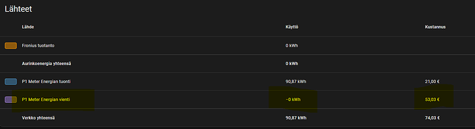

I have the strangest problem. Yesterday my Energy dashboard suddenly jumped and started showing a 53,03€ expense for energy export but at the same the entity tracking energy export stayed the same (texts not in English, sorry):

The expense is a separate statistic that is individually editable, separate from the consumption.
It will be called sensor.[whatever your consumption entity]_cost
I didn’t find one with the _cost -suffix but there was one with _compensation. It didn’t show any outliers but by trying hour by hour I was able to find the invalid number and now it is fixed.
