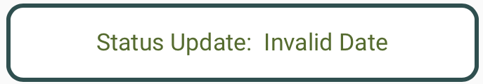

I’m using custom:button-card to display the date an entity was last updated, which is basically the state of the entity. On my iPad, I get “Invalid Date”, but on Android and PC devices the date displays without error.
I’m not sure if it’s a formatting error in my HA code, or if there’s some setting I need to change on the iPad. The HA app is the most recent version, and the iPad mini is also on the updated software version (15.8.5).
On the PC and Android, it looks like this:
screenshot1
On the iPad, using the Home Assistant app, it looks like this:
The custom:button-card code is below, where the formatted date is a custom field:

I don’t usually agree with iOS but that is not valid. But I guess android and PC just doesn’t care.
Why do you remove the colon?
