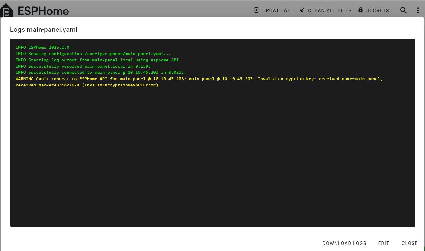

I flashed a new Emporia Vue 3 via USB serial and the device is showing as online in HA>ESPHome (also responds to ping). When I view the logs for the device, it is showing a “InvalidEncryptionKeyAPIError”.
I thought I skipped the encryption step when flashing the Vue 3, but obviously not. Is opening it up and reflashing my only move or can re-flashing be done with the fallback/ad-hoc network shown in the .yaml?

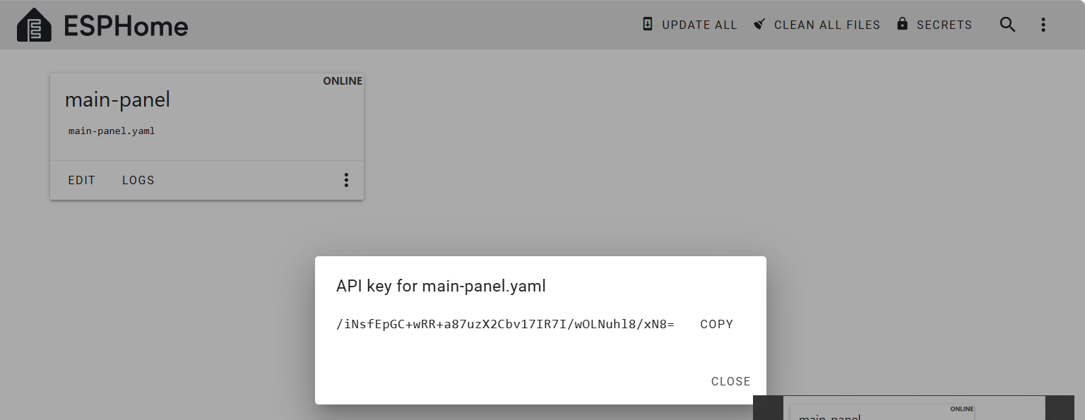

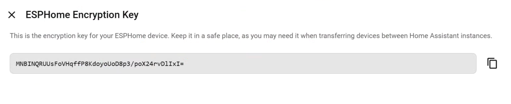

I’m seeing 2 different encryption keys in ESPHome and Integrations. Can this be causing the issue?

Key shown in ESPhome, screenshot in the previous post is from integrations (new user, can’t add more than 1 screenshot to a post).
InvalidEncryptionKey error from logs:
