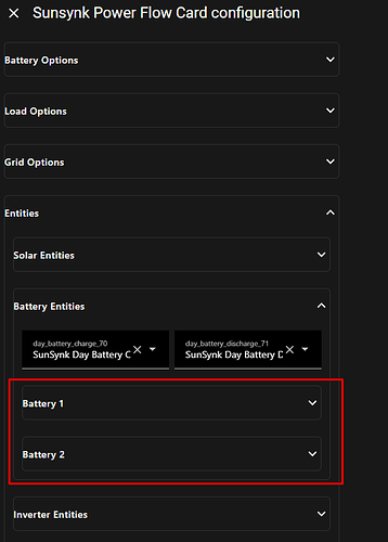

I have just downloaded and installed the latest version. When defining 2 batteries, using the visual editor, I do not get 2 sets of battery entities only one. Can anyone give me a suggestion what I am doing wrong.
2 battery images show up in the graphic but not the entities for them.
Thanks
Under entities, Battery Entities

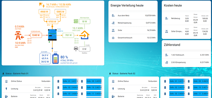

Multi battery support is great. I think you were talking at one stage about having upto 4 batteries.
That would be very useful as I have two batteries in the battery spot, but then additional batteries in the Aux power spot so I can monitor…
Is more batteries still on your development path?
Looks like it’s something related to the dynamic_colour: setting. If you explicitly set this to false under load and battery does it fix it?
I think there will only be 2 virtual batteries (made up of one or more physical batteries), but I’m still looking at ways to show the physical batteries as well, for those that have access to BMS data
This should be fixed now In 6.5.2.

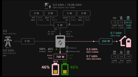

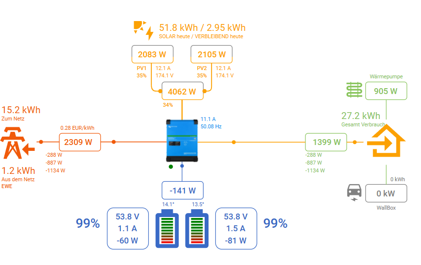

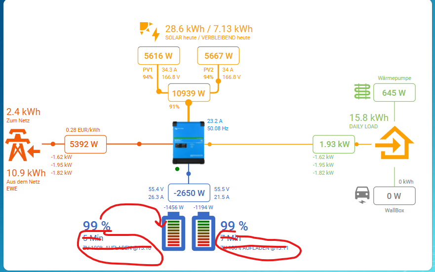

Hello, how can I show several batteries in the display? I have created two batteries. However, the charging power is only displayed for one battery.
I have it, it is displayed in the wide screen. Unfortunately, it doesn’t look that great visually.
A view of the battery as with the solar would be nice.
the translation of the daily consumption would have to be translated into german (Tages Verbrauch)

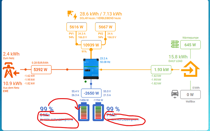

I would like to have the info hidden and the left SOC flush with the battery
I’ve made some updates to the battery layout in v6.6.4. GIve it a try.
You can hide the remaining runtime by setting the battery energy to 0 i.e. energy: 0
You should also set hide_soc: true
The Daily Load is translated but is a configurable attribute and for some reason it sometimes shows the English translation the first time you load the card. Try select your language again or empty the front end cache and it should fix it.

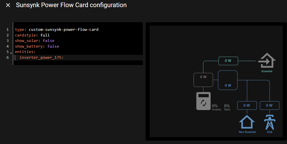

I’m trying to use this card but my screen is solid black. There are no errors in the log or on the screen so I have no idea why it’s not rendering. An invalid entity name perhaps but which one(s)? I have changed a few of the colors just in case it was rendering everything in black.
Try with an empty config
type: custom:sunsynk-power-flow-card
cardstyle: full
show_solar: false
show_battery: false
entities:
  inverter_power_175:
