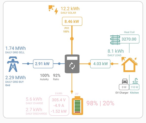

The entity of charging power is configured on 1 digit after the dot, but the visualization shows 2 digits after dot.
You can set that using the decimal places parameter

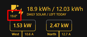

@slipx06 Just a suggestion - could you include an option to select an entity to display a Temperature, and maybe display in the top left corner ?
It is sometimes useful to know the outdoor temperature when looking at the generation and power flow
Hi @championc
It’s possible to display this under the sun if you configure the environment_temp: entity
