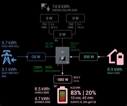

Recently added a 2nd battery to my system and in order to show it in the card, i had to enable the wide view option. But this somehow ruined the size of the text and it is barely visible now. I’ve played with the card size options but no effect. I am showing this card on a 12 inch tablet.
Any advice how to make it more visible?
Picture 1 is wide enabled while picture 2 is disabled and hence more visible.
@slipx06 - any kind of ideas to try or this is by design?
Thanks in advance!
You can try using the layout-card for your view. If you choose grid layout and set your width and height to both 100% it will fill the container.

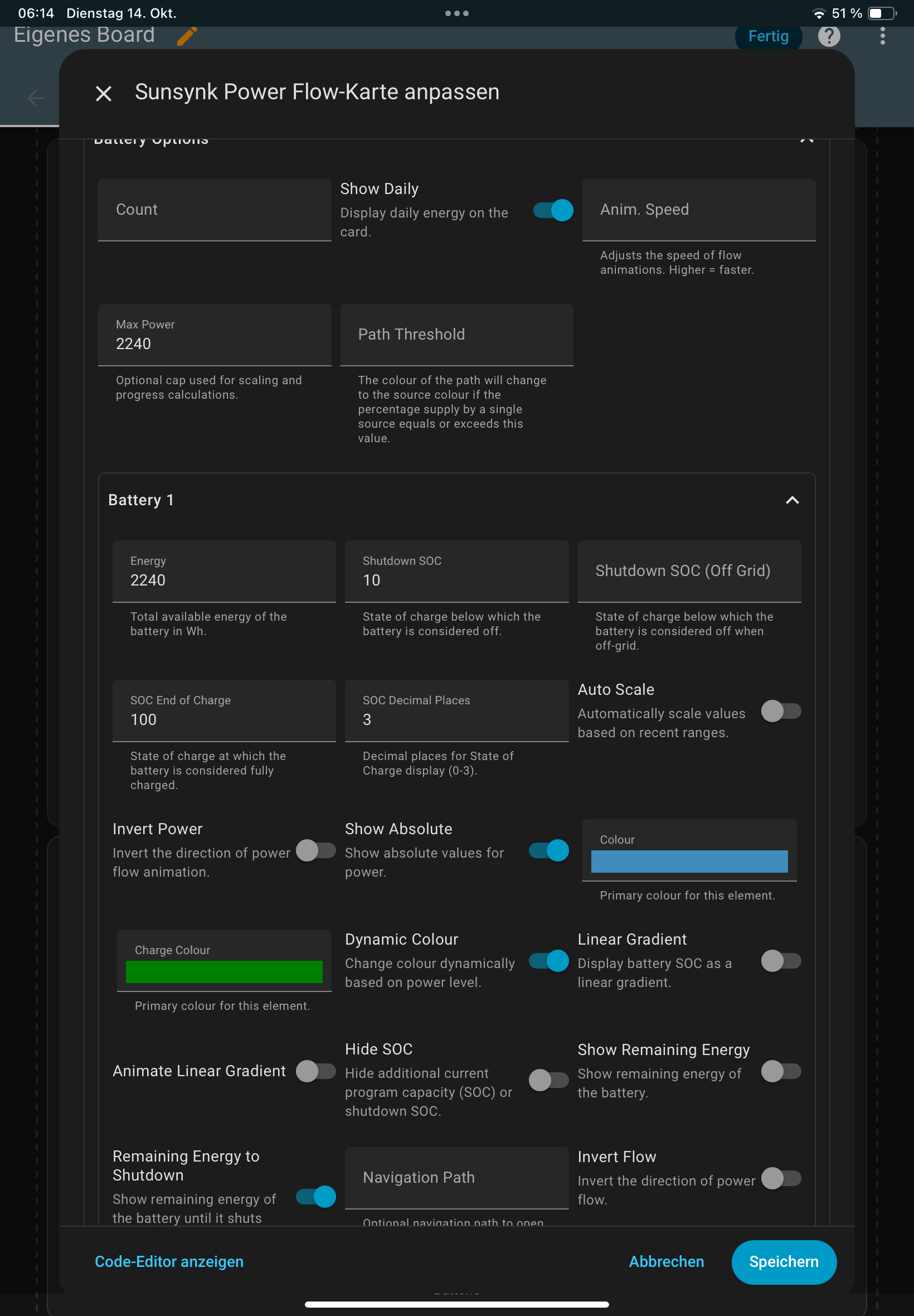

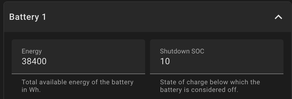

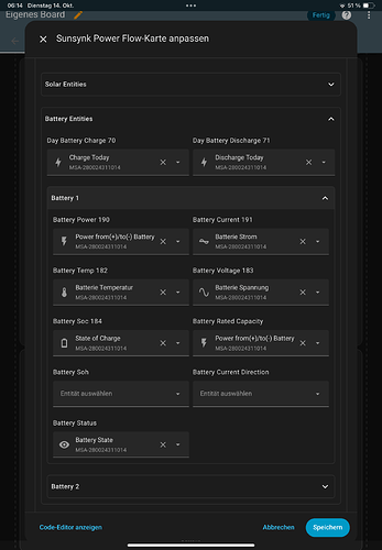

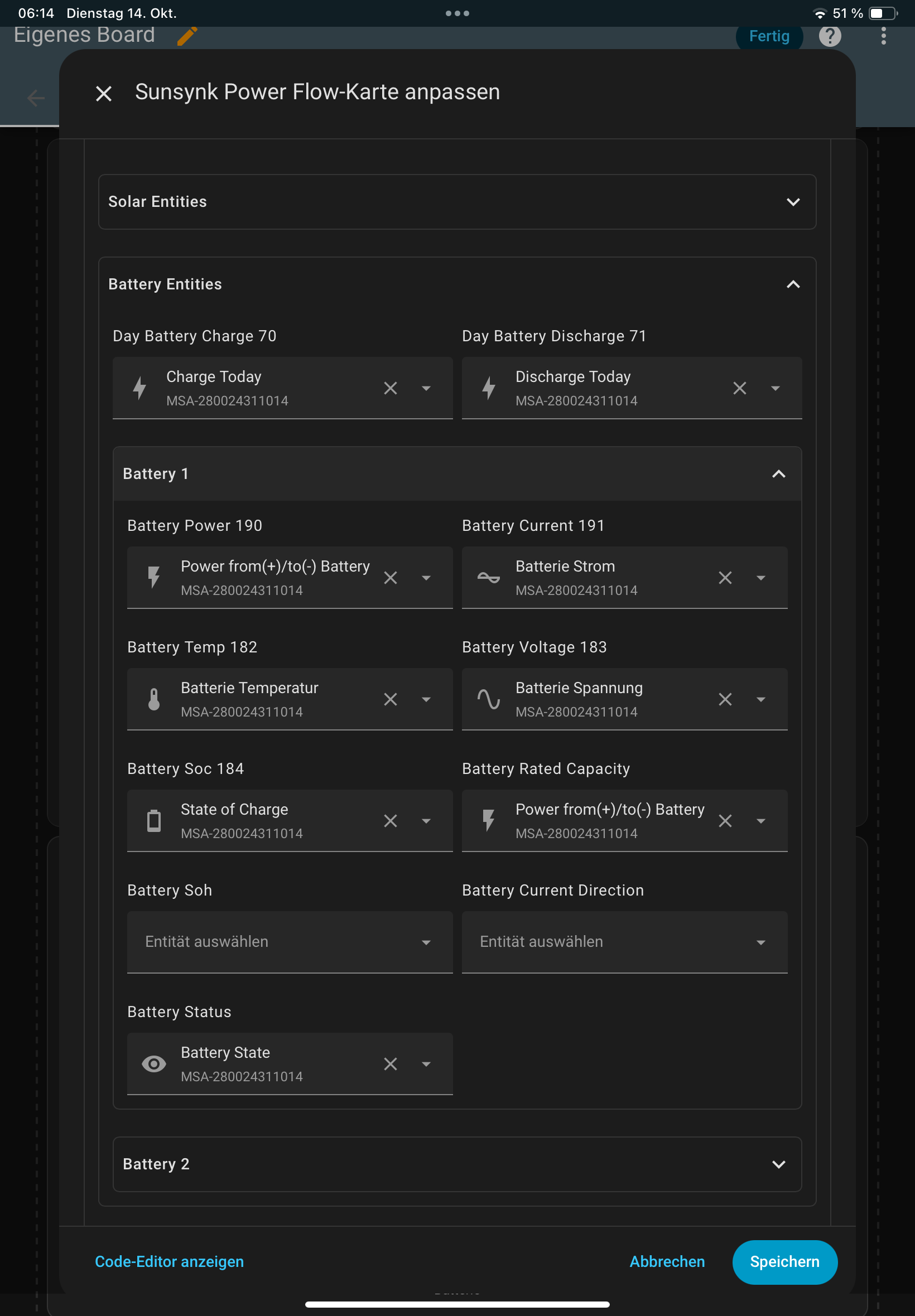

I would like to know what these two messages mean. There is probably something wrong with my settings.
Dieter

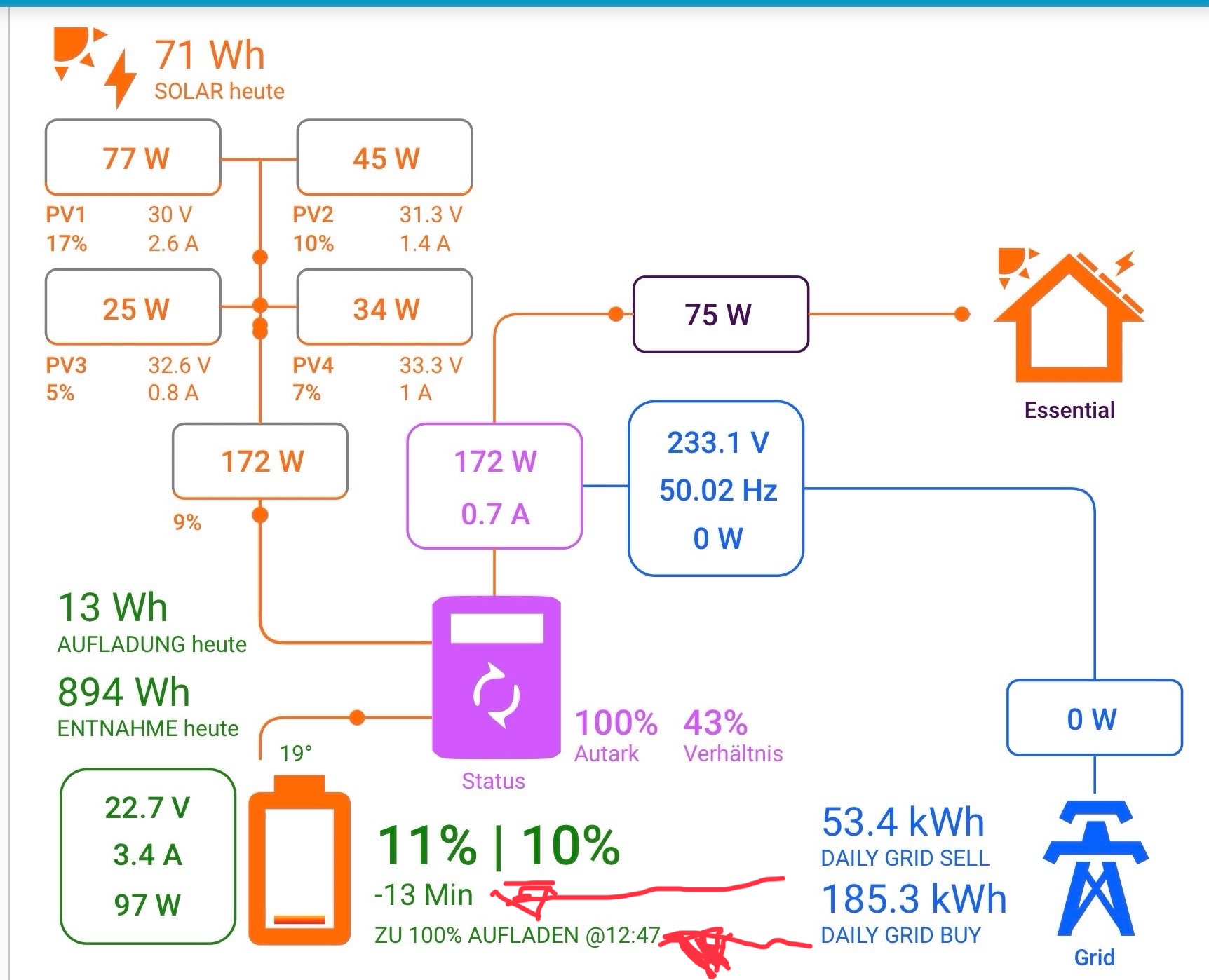

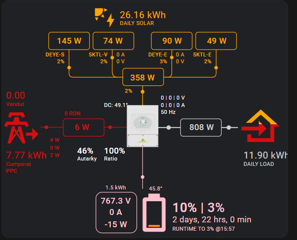

Why did the solar sensor icons turn gray when they were previously illuminated yellow?
This also happens during production
Something strange. Did you set your battery energy correctly?
Hi. You can disable that feature by toggling this off under the solar section
If enabled the solar elements on the card will be greyed out if total solar power < 10W.
Battery Hoymiles MS-A2.
