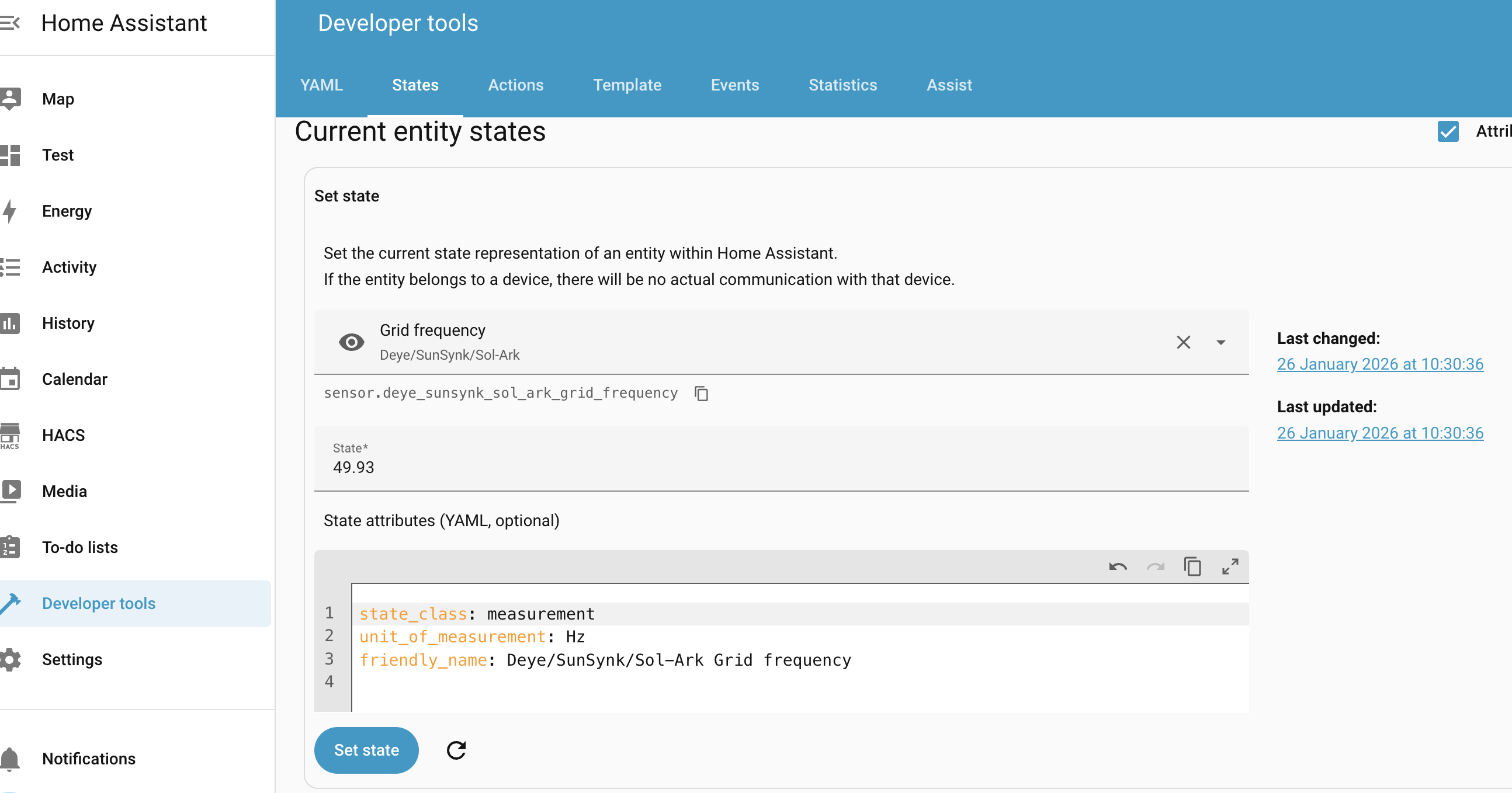

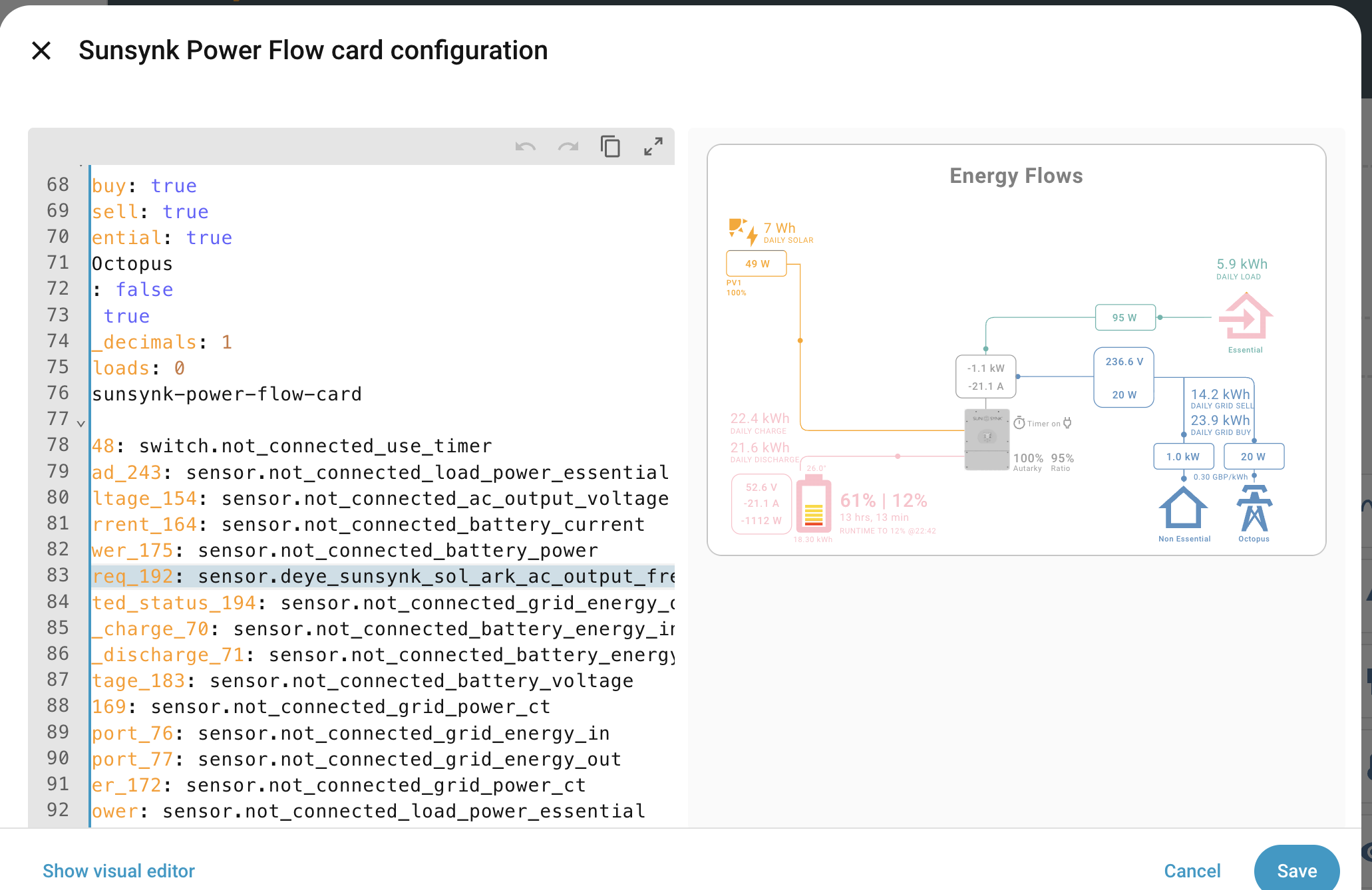

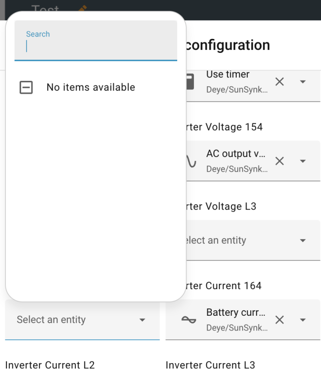

Hello @slipx06 ! thanks for this update, I have got the Sunsynk Power Flow Card up and running but when I try and link the Inverter entity “Load Frequency 192” it says “No items available” . I do have an entity available though, it is sensor.deye_sunsynk_sol_ark_grid_frequency. Any ideas how I can get the entity listed to allow it to be imported? When I add it manually in the code editor the value is not displayed either.
can you let us know what I am doing wrong?
Hi. The visual editor has some filtering built in for the different entities. It looks at the device class. For this specific sensor it filters on device class equal to frequency. I’m not sure what integration method you are using to extract your inverter data but make sure that the sensor has the correct unit of measurement configured i.e Hz. You can see this in the developer tools.
Switching to the code editor will override the visual editor filtering and you can provide any sensor.

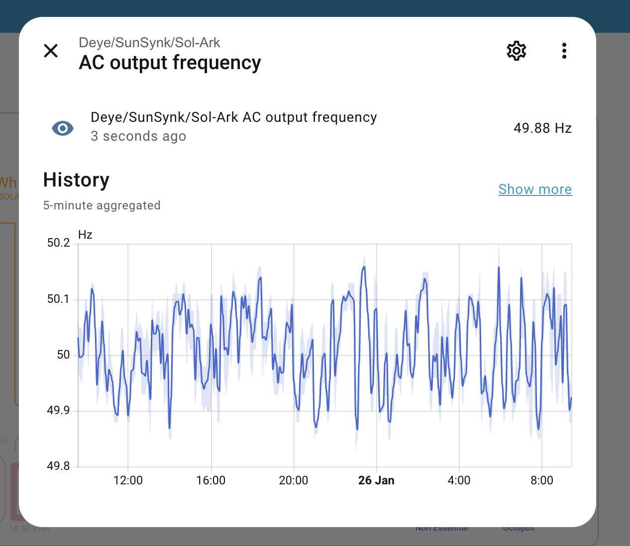

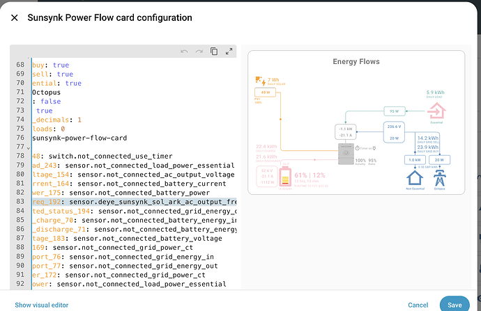

Thanks for replying so quick, so I am using the MQTT integration to get my data from my SunSynk Inverter which is published by my Solar Assistant device. I can see the entity is available, and I have manually added this into code/config section but the value is not rendering still on the card ![]()

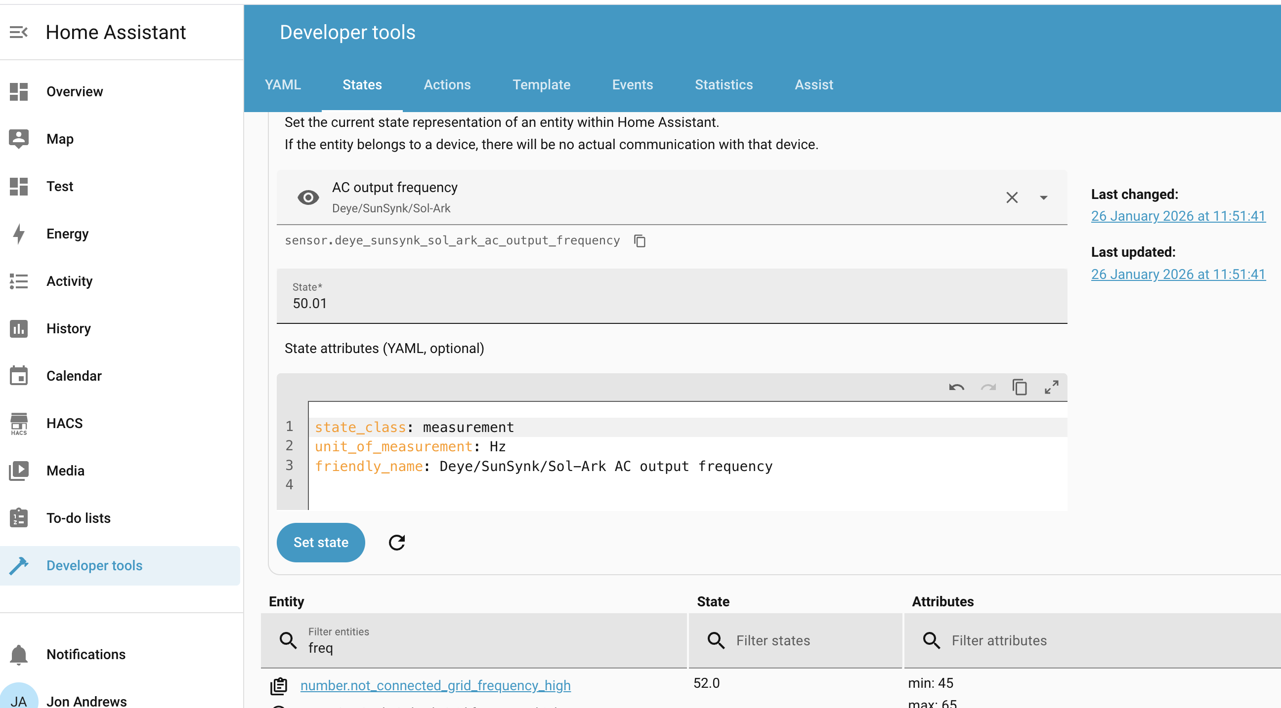

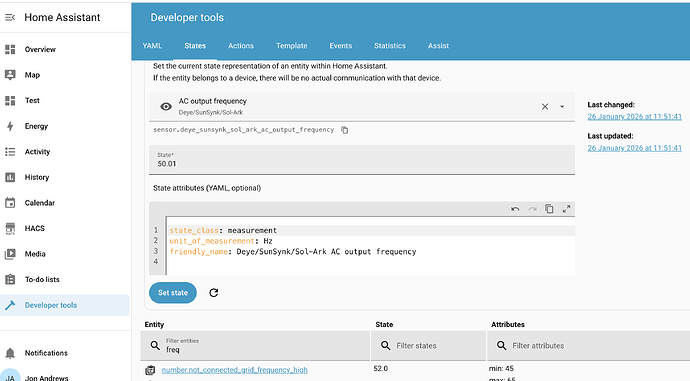

Your sensor name is not correct in your config
From your dev tools
In your config
Thanks @slipx06 , sory my bad, I posted the wrong one, yes I have 2 sensors, one named sensor.deye_sunsynk_sol_ark_ac_output_frequency
and one named sensor.deye_sunsynk_sol_ark_grid_frequency - they both contain the same value, i have tried using both of them but still struggling to get the value onto the cad
sorry for being such a noob btw!
