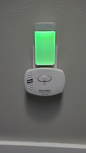

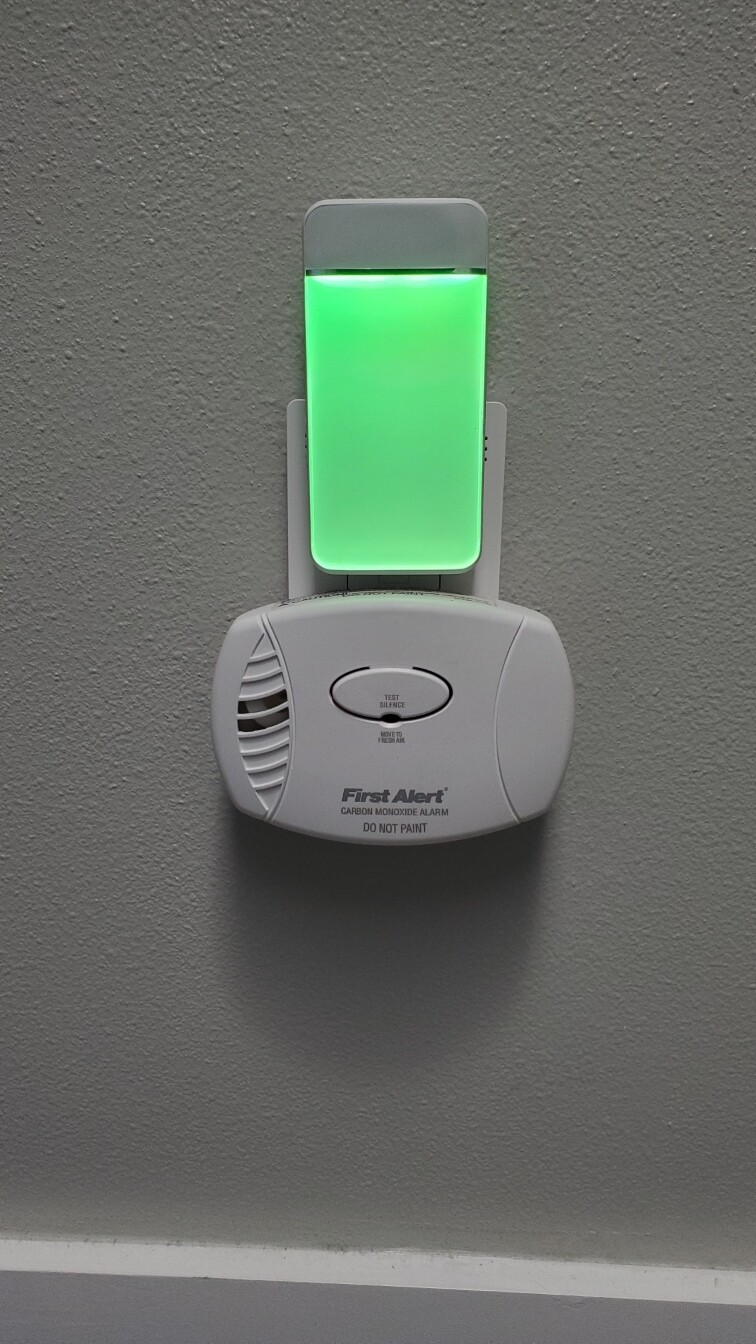

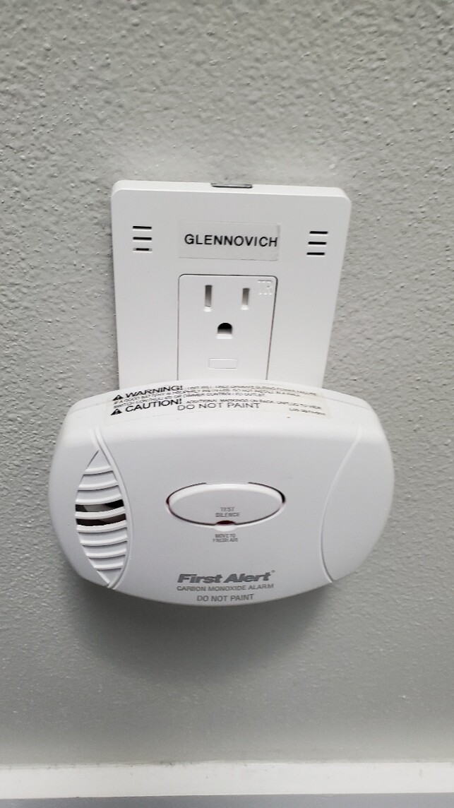

Also, does the device have a piezo “alarm” or any way of making sound? I ask because you detect CO2 but without an audible alert, this is kind of useless. I replaced the hallway AC receptacle with this InvisOutlet thinking I didn’t need my existing CO2 plug in alarm, but now I’m not sure; I’ve not heard this device make a peep so I don’t know if it even can. Similarly I can’t now use said CO plug-in box because it’s too big and covers up some of your sensors :frowning_face: (it also seems to hose up the distance meter)…
Nor can I put our hallway emergency flashlight as that also blocks your 3 slots on each side (and causes the distance to be all jacked up)

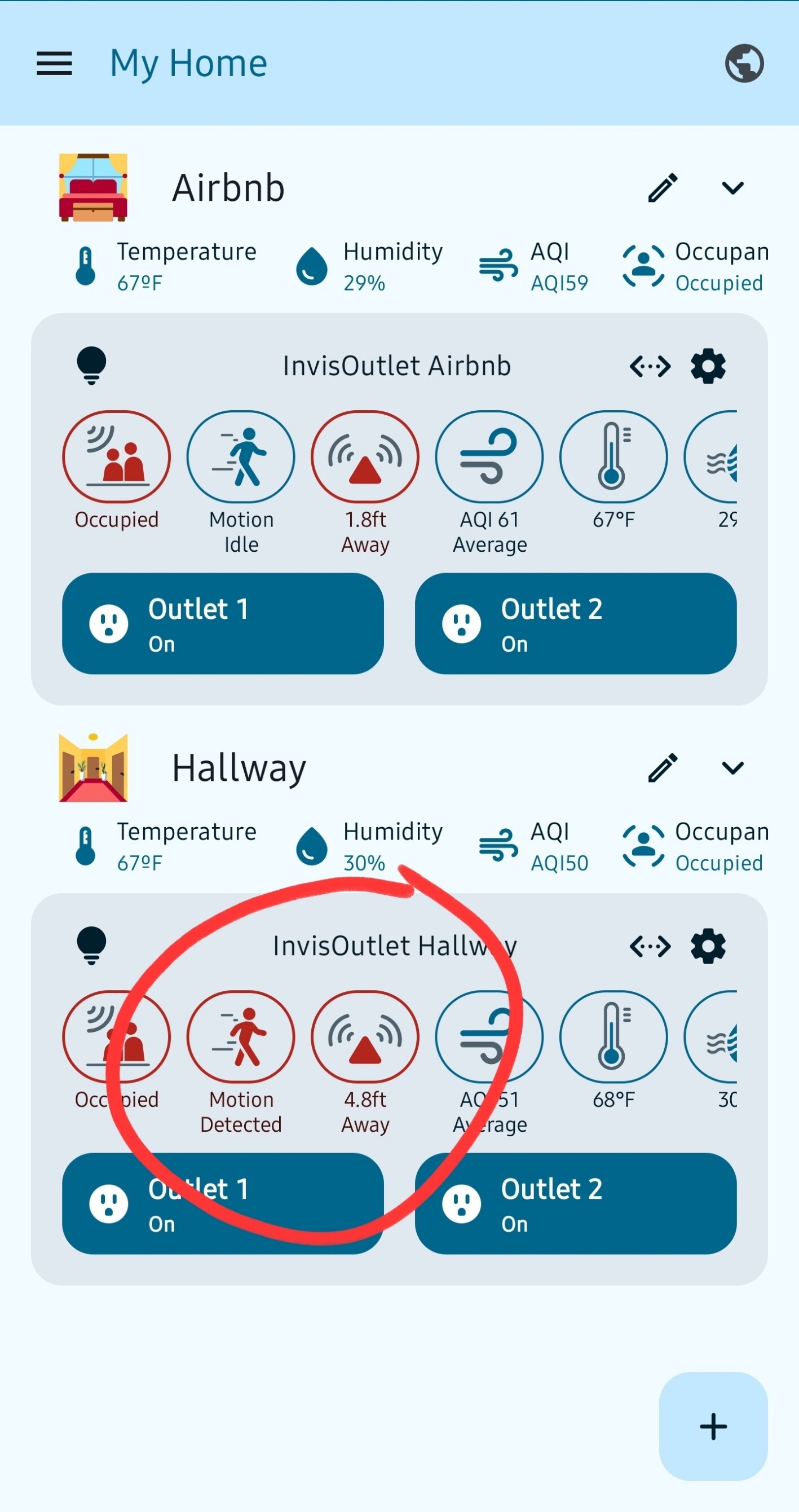

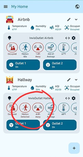

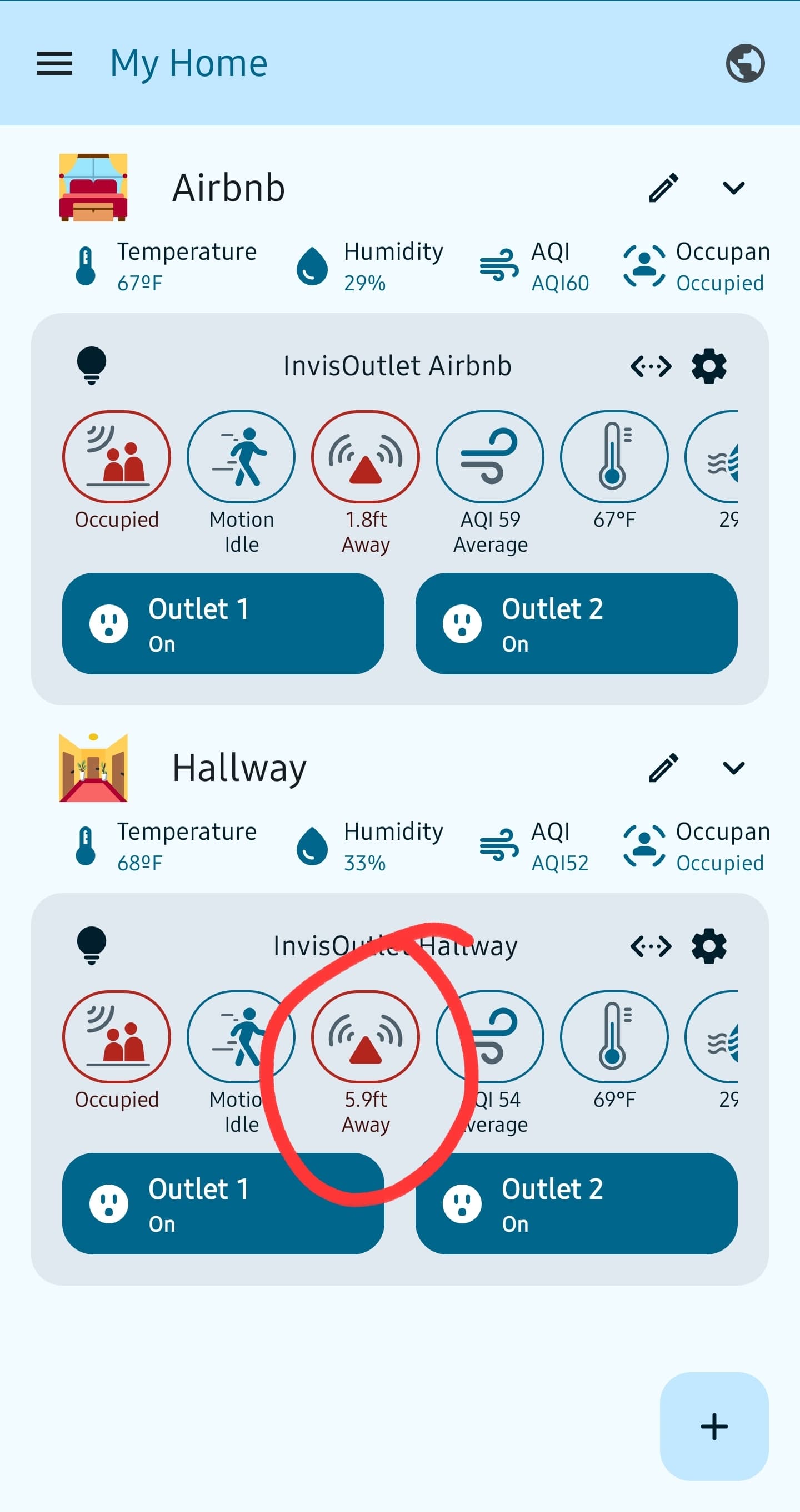

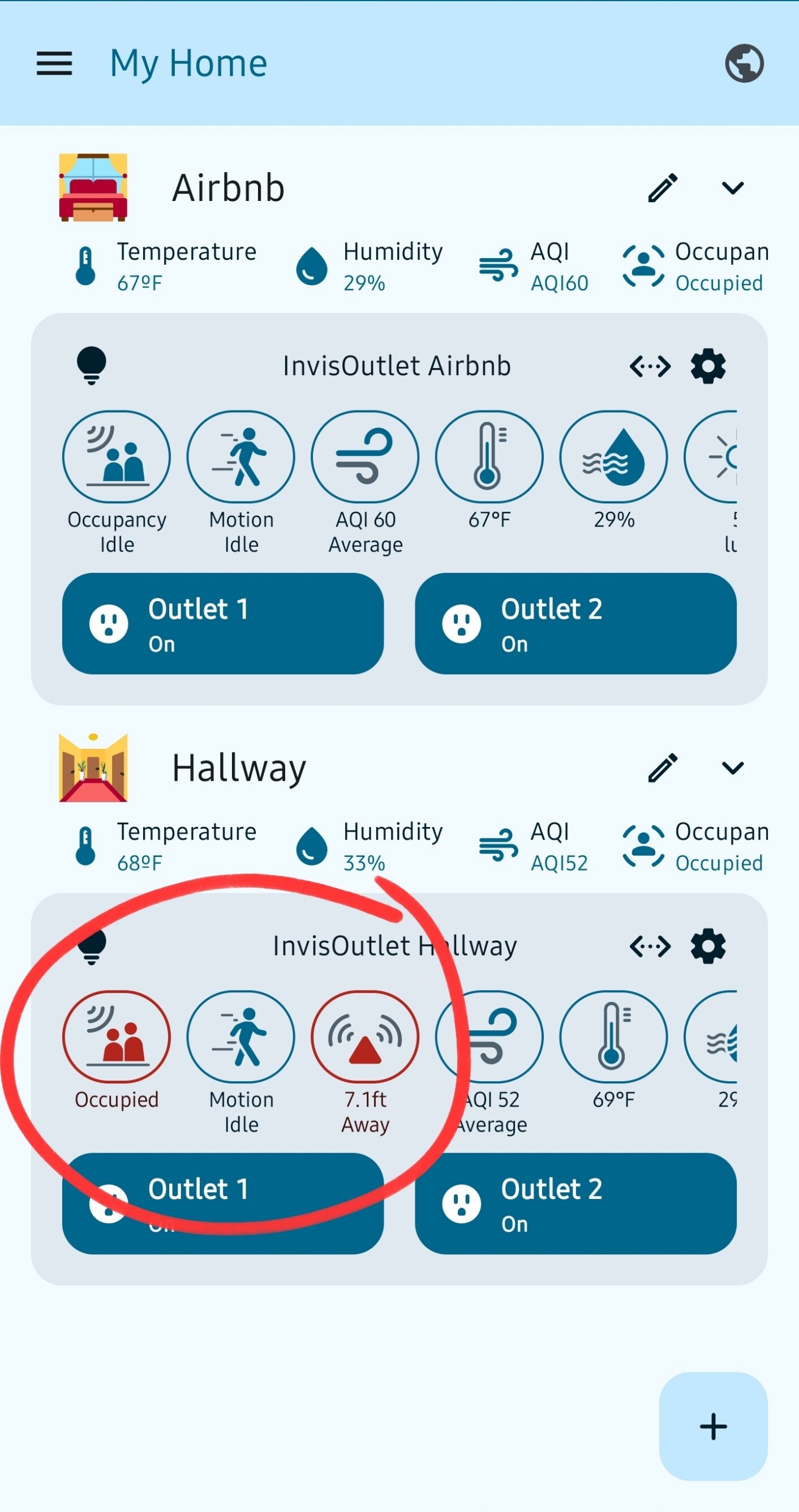

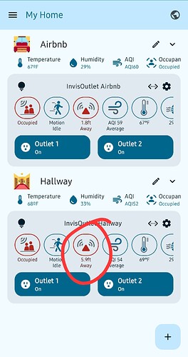

Which brings me to another thing, the Motion detection is a bit wonky or else I don’t understand the three “buttons” there. “Motion Detection” (little person) lights up real fast; which is great. But the distance is suspect. It’ll say I’m some big distance away when I’m much closer. Also it changes; slowly; so by the time I move around it’s telling me the wrong distance (again). Does this see through walls? I ask because sometimes it thinks there is a distance but I assure you nobody is in this hallway. It would be great that once you get the accuracy dialed in, if I could define a distance that matters; for example, only alert if it’s < 5’ from the plug and I don’t care about people further than that as they are maybe walking past an open door in their bedroom but it still triggers this guy.
standing here about 6’ away
it said i was like 10’ initially, then 7’ then 5.9’ but it takes like a second or more for each re-calibration to happen. I would have expected more accuracy and faster updates thereof…
I think you guys mentioned this isn’t possible with the sensor you’re using, but defining multiple detection zones would be so great too…
what is the angle of detection? like is it from the wall and anything anywhere in that 180 degree arc? it feels like it is.

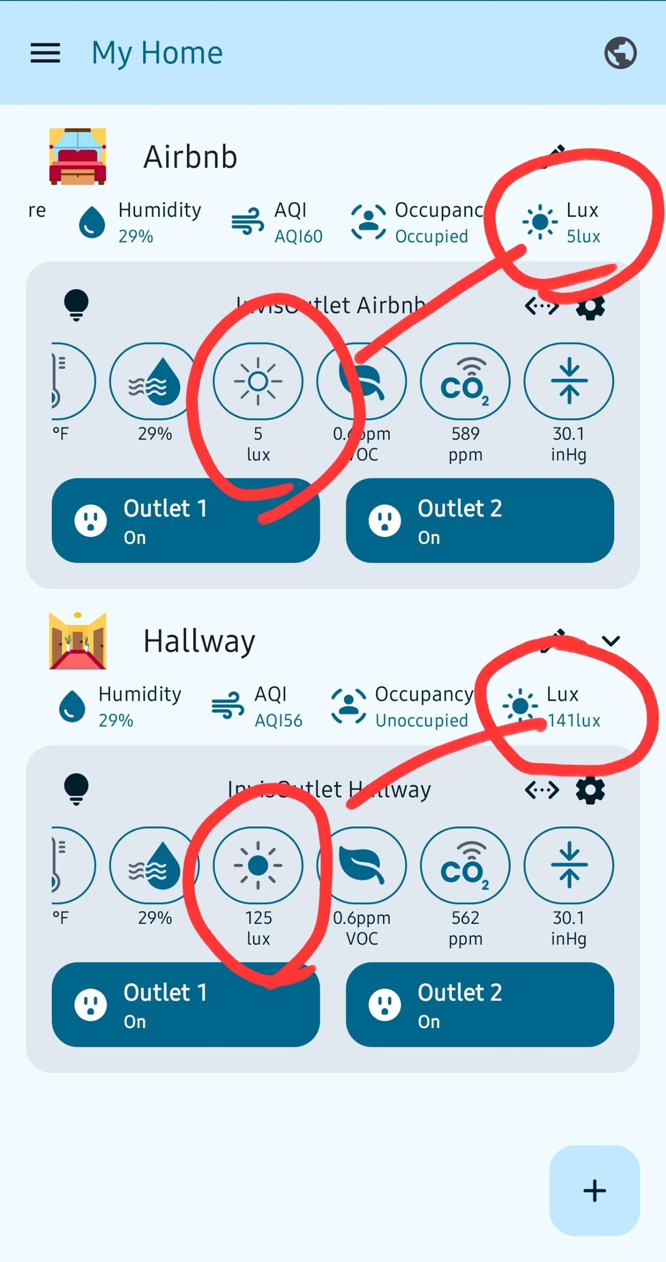

And I’m not understanding the redundant icons along the top under the title and then the same ones basically in the gray shaded box? But even more curious is they don’t always line up? Here you see the Airbnb LUX is 5 in both, but the Hallway shows 141 and 125 ?! huh?
The AQI one says “average” for one of them, so that sorta makes sense there that they’re different. Are the rest supposed to be average too, just not labeled as such?

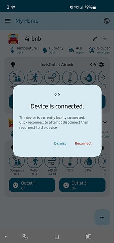

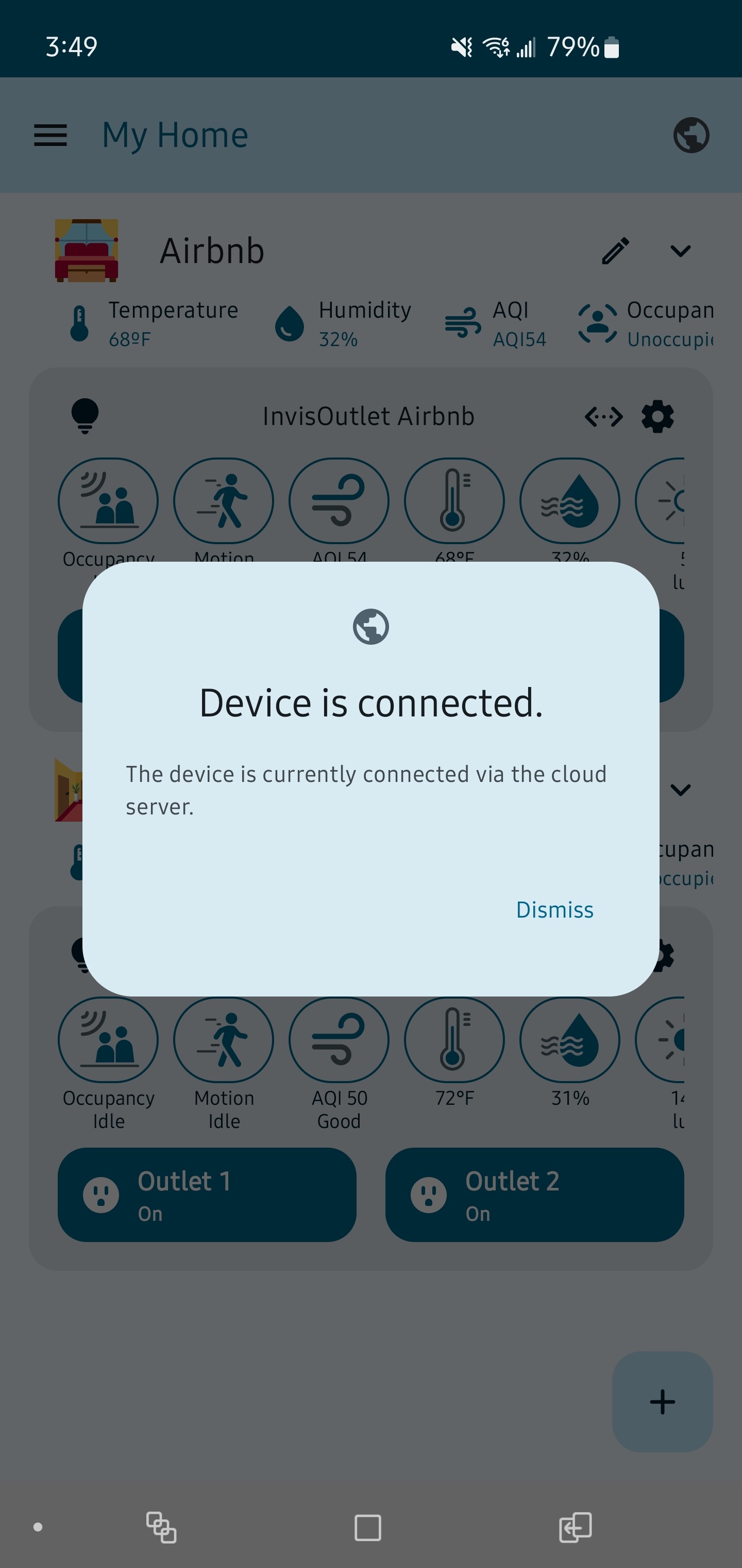

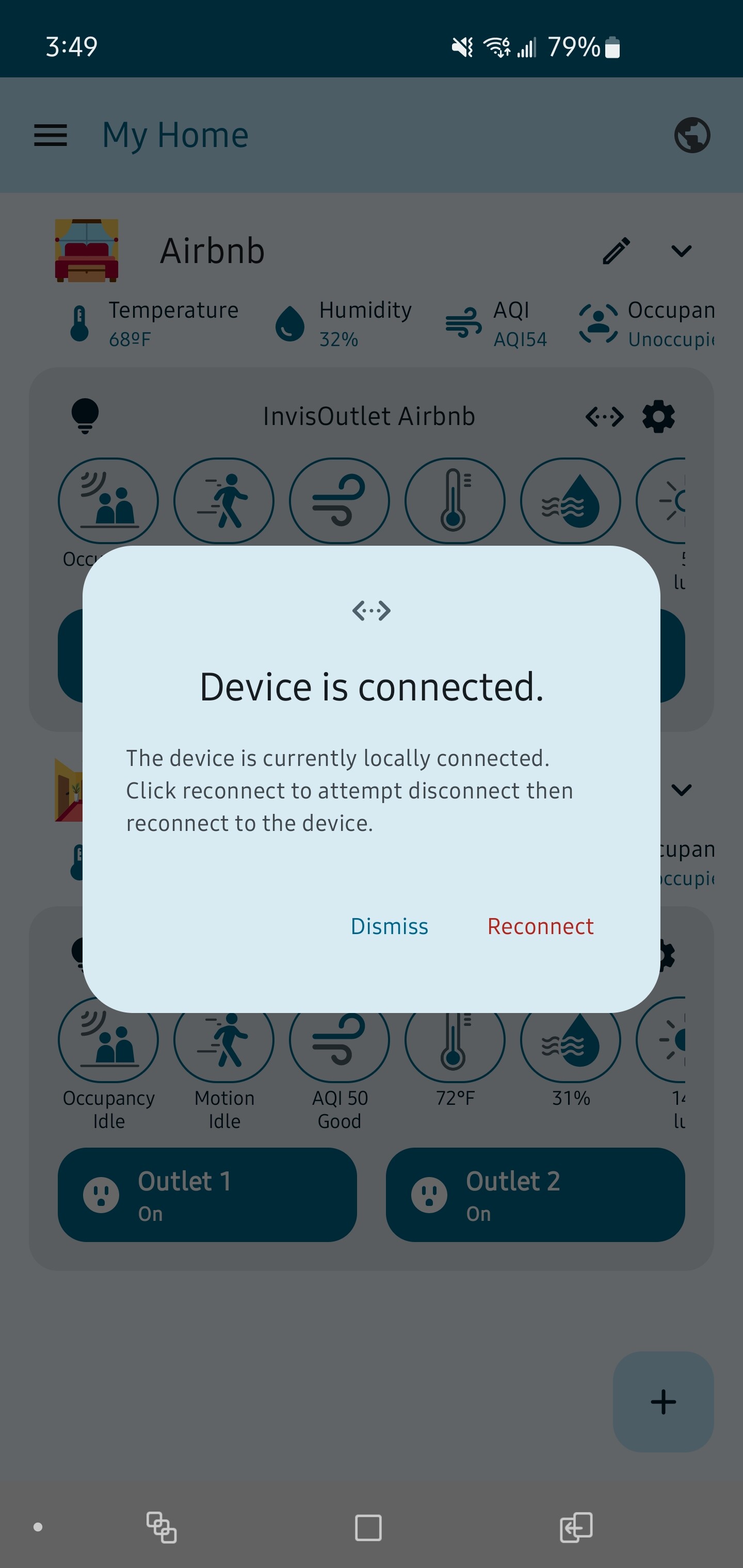

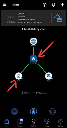

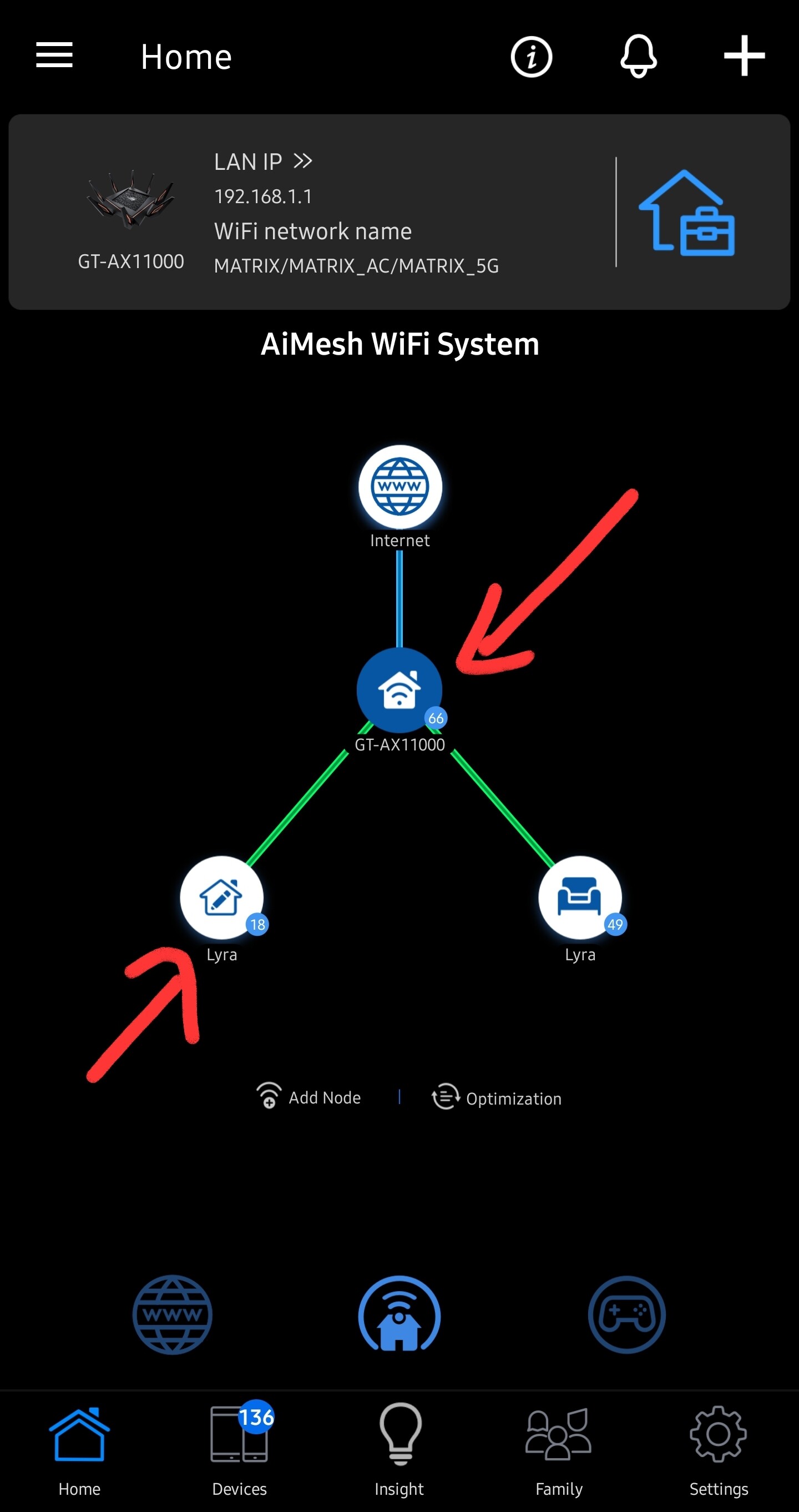

@lawrence-intecular here’s another connectivity issue I’m now experiencing. I had to reset my ASUS GT-AX11000 router the other day. I have noticed that since then, ONE of the two plugs shows this globe icon and not the ↔ icon. Obviously haven’t touched the outlet as they’re hard-wired (is there a way to “reboot” it but not “factory reset” it as my other TPLink Kasa light switches have?).

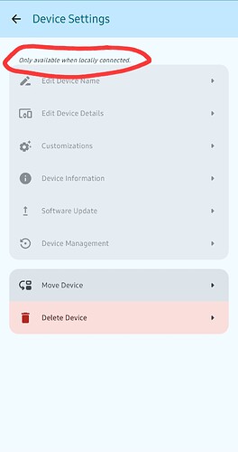

This seems suboptimal as I can’t get to any of the menus

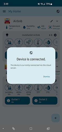

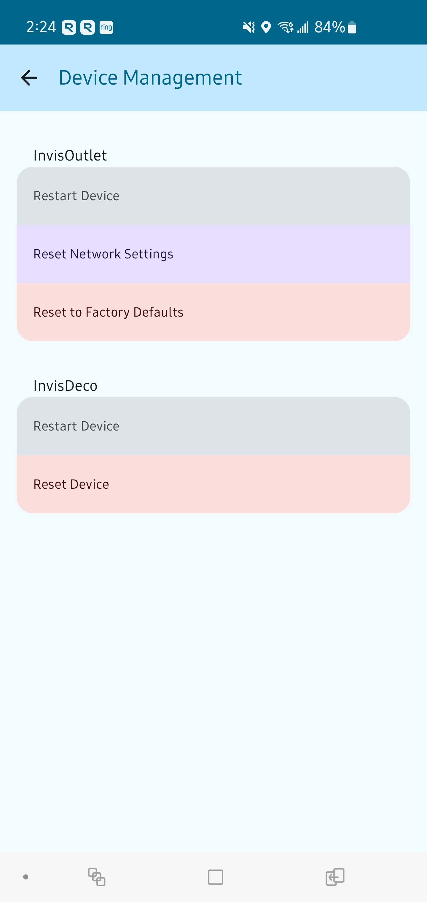

And ironically there is an option to reboot the outlet, but NOT when it’s in “cloud” mode ?! Why is this locked out when of all times, NOW is the time I need to reboot the device?! :cry:
however curiously the APP does show data moving so is this a BT connection or something?
The working one has this different modal popup
The wording seems odd too. Why would “local” be “better” than “cloud” connection? Seems local would be a BT or something only, whereas Cloud would be IP based :person_shrugging: but I digress…

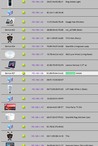

Here’s what I SUSPECT is happening, maybe I’m wrong, but at least it’s somewhere to start to to look into as well for you guys… I have that beast ASUS ROG router in my home office top floor. The InvisOutlet in question is just outside my door here in the hallway. I have TWO ASUS LYRA pucks that act as a mesh to cover the whole house. The other working InvisOutlet is in the Airbnb bottom/3rd level. Illustrated here (the pucks have a CAT6 backhaul to the router)…
My theory is the Airbnb outlet is connected to the nearest puck which is also down there. That was NOT rebooted, therefore the outlet never lost connection to “something” (despite the puck lost CAT6 connection to the ASUS ROUTER for a bit while rebooting). But the one in the hallway probably connects to said router, and when that went away, so did the connection on the outlet and it just never recovered when the router comes back online? The fact it says “cloud” is throwing me off, but if the wording is confusing (as per above) then it makes sense as it’s really just a “local” BT to the app or something but not getting an IP and not able to do MQTT and all that. I verified some of this because I wrote an internal web page long ago that nmap scans for all my 136+ IOT devices and it ONLY shows the Airbnb InvisOutlet having an IP and on the LAN (normally both showed up before)
The alarm you have plugged in is a Carbon MONOXIDE (CO) alarm. The smart plug is detecting Carbon DIOXIDE (CO2).
The two gasses are not comparable in danger, and you cannot use this device to replace carbon monoxide alarms.
AH!!! okay that makes some sense. :man_facepalming: LOL… but then my next question is, why do I care about CO2 detection/levels? In other words, that’s more like Global Warming/Climate Change stuff on an “Earth scale”. What does it mean in the context of my “Home scale”? And of course then, detecting the MONOXIDE would seem to make more sense in the outlet to reduce one more thing I have to plug in the wall no? Not to mention plugging a CO sensor into the receptacle appears to not only block either the top two side slits, or the bottom lighting indicators. Curious choice.

  2. The ↔ icon that you see on the app means it is locally connected (API), not remotely. As mDNS discovery may be slow in different Android OS, some device may need longer time to get discovered, hence showing the globe icon instead of the ↔ icon. This is working intended on the iOS app and we are working to find a better workaround for Android app in the meantime.
  3. The Only available when locally connected. is an application limit, we will have those implemented as well in the future.
  4. Touch Control is a feature where you can control the receptacle power via the two touch pads on the side of the receptacle, on the InvisDeco. Home Security is a feature where the InvisDeco will blink to scare intruders away when no households are in the house but intruders came in.

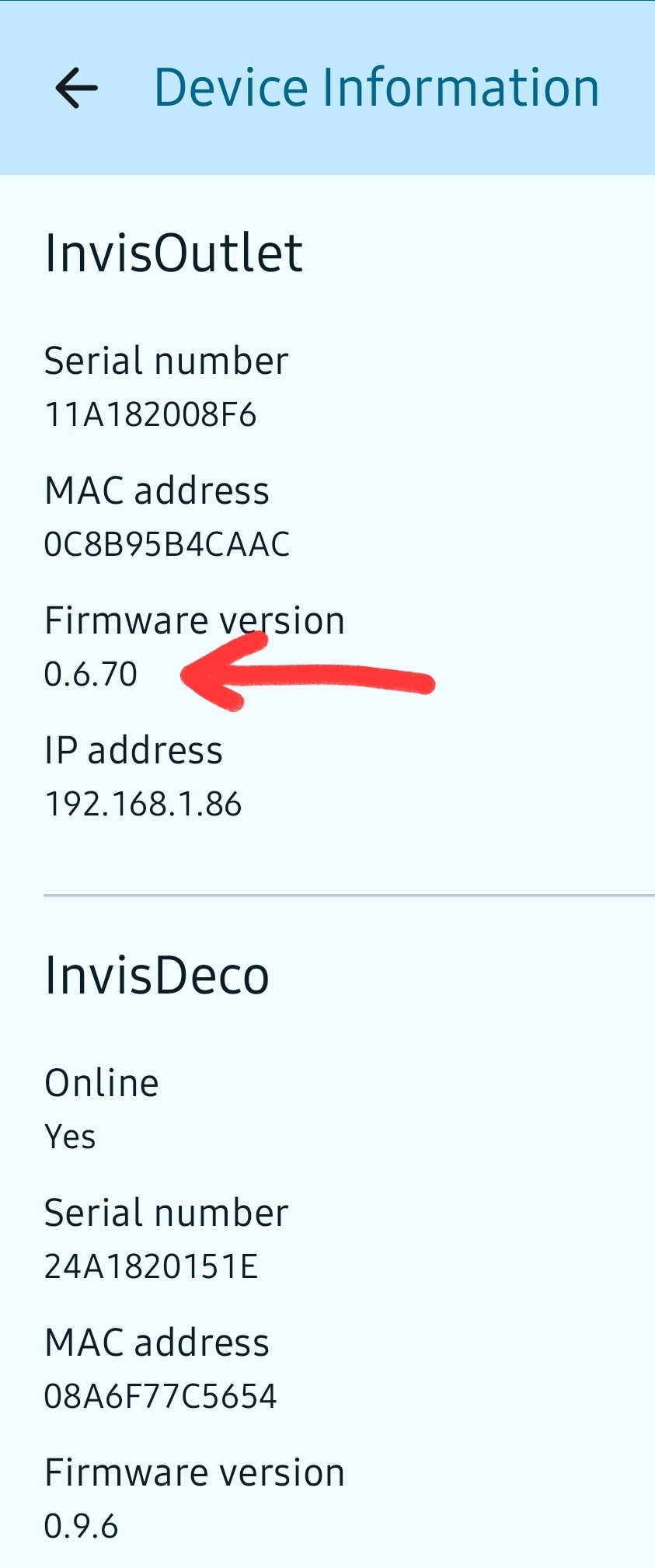

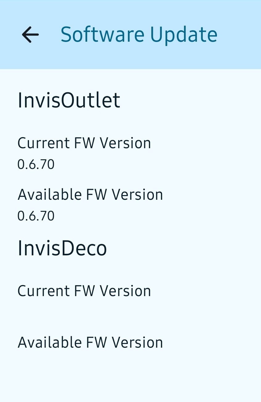

The latest firmware (0.6.70) for InvisOutlet is out, please make sure you update your InvisHome app first and then update the device.
This update should fix the MQTT bug that most are experiencing. We’ve been running for couple days now and it’s running fine. Also tested with MQTT broker server turned off for couple minutes and back on and it also reconnected back to the broker with no issue.

One thing I missed on the previous reply was you can restart your InvisOutlet by double-clicking the physical button, you should see it blink for 3 seconds and it will restart.

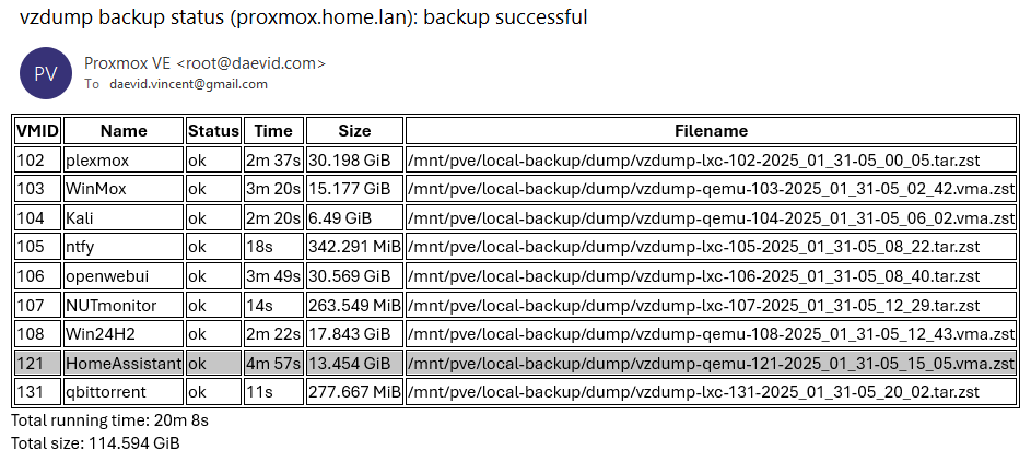

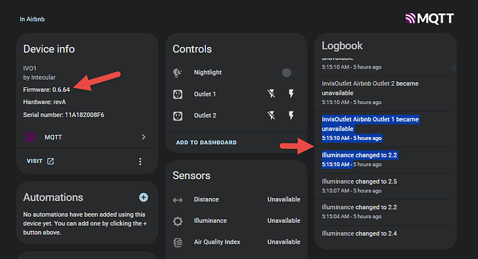

@lawrence-intecular I’m sad to say, it did NOT fix the MQTT issue. I was elated to see an app update and even more when I saw a firmware update. I immediately updated both outlets about 11pm last night; excited to see them still working in the morning in HA/MQTT. Unfortunately that is not the case.
What’s curious is that the backup doesn’t take all that long. And even with a shutdown/backup/restart I’d guess it’s still under 10 minutes total…

you can see this timestamp lines up where it stopped working. something we already knew basically, but what I’m also noticing is that the FIRMWARE says 0.6.64 here BUT the app shows 0.6.70 … so why the discrepancy? Was I supposed to do something else here (as in restart something?) Obvi HA is restarting after the backup from a clean boot (meaning it’s a stop/backup/start, not a suspend/backup or something like that as I was hitting corrupt backups that way)…

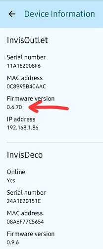

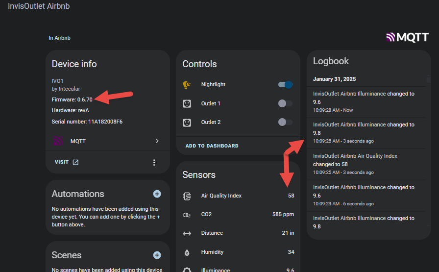

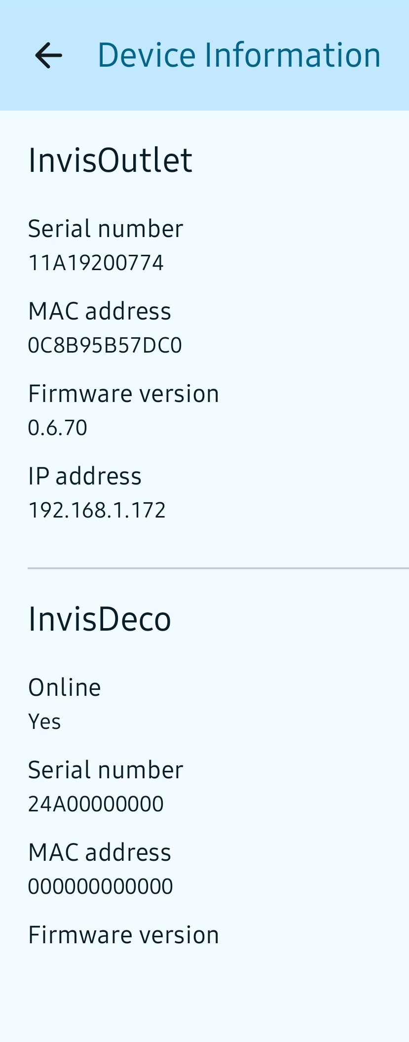

UPDATE-ish… so yeah, @lawrence-intecular I restarted the outlets and NOW MQTT shows the right firmware and is getting data… this is encouraging, but I won’t know until tomorrow after 5:15AM PST if this firmware actually fixed the issue since that’s when the backup will happen again… will update here of course. #fingerscrossed…
One more thing is you say:
Have you tested it for LONG periods, maybe 30 minutes or hours or days even? If you’re truly only testing for 2 minutes, then I’m 5x longer than that, so maybe there is still an issue there… TBD I guess we’ll know tomorrow :wink:
@lawrence-intecular you’re not going to like this either… I noticed NOW after restarting the outlet, the “deco” isn’t responding to motion or other things anymore and doesn’t show its firmware or anything (as the screenshots above did) :face_exhaling:
tried restarting the outlet with the double-tap button as well as in the app and also restarting the deco in the app. nothing brings it back … :face_holding_back_tears:
UPDATE: so after trying to “restart” and “reset” the deco, finally i just tried to yank off the plate from the plug. I couldn’t figure out HOW to do that exactly with this push/pull business. BUT whatever torquing I did seemed to have reset it the hardway and so now I get firmware and updates again.
Hi @DAE51D,
We have others that experienced the InvisDeco being offline after the software update, we are still investigating why this is happening. If this happens next time, try to pull the right side of the InvisDeco a bit until it loses power, without unsnapping it, this will do the power reset the hard way.
For MQTT, so far we are getting positive results from other users. We are also testing long-period testing with MQTT broker being offline and restoring it back to online now. Let me know if MQTT still isn’t working for you after the InvisDeco is now back online.
UPDATE: After testing with HA being offline for 30 minutes and goes back online, the device can connect back to HA with no issues. We will continue to monitor what happens in the next few days with MQTT.

@lawrence-intecular I noticed late LATE last night (or I guess early this morning maybe like 1am or something) you released a 0.6.71 up from the 0.6.70, so I updated only ONE of the outlets just to see if one firmware worked and the other didn’t or whatever. Turns out the .71 DID work (as in this afternoon when I woke up I see data in MQTT ! woo hoo! The .70 had the same old issue. HOWEVER just now I noticed that HA still said 0.6.64 in MQTT despite your app showing 0.6.70, so I toggled MQTT in your app and now HA shows 0.6.70. I’m doing this to let it run tonight on that (outdated) firmware JUST to see if that version was the true fix, or if the point bump was the actual working one… will post an update tomorrow.
UPDATE: IDK why but that hallway one said .64 again and so never got to test the .70 firmware. I gave up and flashed it to .71 (since that’s the only option now anyways) and they’ve been solid the past few days and every day I check I see data for both outlets now. I believe this bug has been squashed. Thank you to your team.

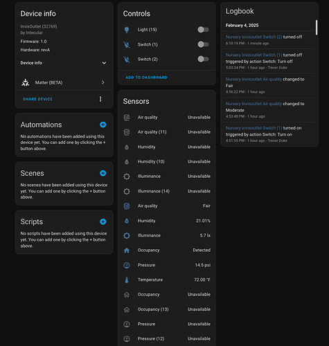

I am very happy to see quick updates, and I appreciate the MQTT settings no longer being on a nested menu.
I am still not having luck with MQTT, and device is showing always detecting motion/occupancy.
Keep the updates coming! loving having an accurate temp sensor, that doesnt seem to be disrupted even by high draw things plugged in.
I do seem to have duplicate entities after the last update, but I hope those will clear up.

Matter doesn’t play too well with HA and we recommend to delete all Matter-related endpoints for our device and connect using MQTT.
Can you give that a try and see if that works for you?
The latest firmware version is 0.6.71, we do found a bug where the outlet and nightlight status will get reset to off when there’s a reconnection back to the MQTT broker. That will be fixed in the next update.
