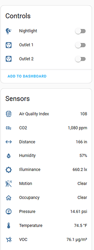

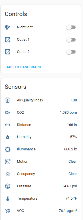

9. Home Assistant MQTT Integration should auto-discover the InvisOutlet as a device with the following entities:
:electric_plug: Controls:
  • Nightlight
  • Outlet 1
  • Outlet 2
:thermometer: Sensors:
  • AQI
  • COā‚‚
  • Distance
  • Humidity
  • Illuminance
  • Motion
  • Occupancy
  • Pressure
  • Temperature
  • VOC
:globe_with_meridians: Bonus:
  • Click Visit in the app to open the local web interface

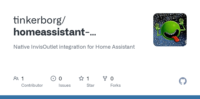

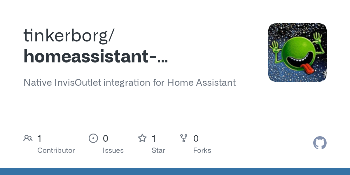

@BVD - Have you done anything further with InvisOutlet gear? I still haven’t installed my Aura units. But I’ll be much more tempted to do so, after the recent appearance of the Native HA Invisoutlet HACS integration:
I’m currently experimenting with that, but now having to muck with the network stuff on my original InvisOutlet. Kinda messy doing a power-cycle on a device connected directly to AC mains. Oh well, maybe I’ll just light up the 2nd InvisOutlet, on a dedicated test bench mains connection, before it goes into a production wall box. And do my testing on the bench.
But anyway, this native HA integration looks really slick. It’s all local (including firmware updates from HA server), and does things that neither MQTT nor Matter integrations do for InvisOutlet. Definitely seems worth checking out. And if it’s as good as it looks, then maybe I won’t feel bad about having two Deco and two Aura models, if I can actually use them decently.
@tim.plas - You can double-click the button on the invisoutlet and it will reboot. Hold for about 5 seconds and it will reset network network credentials. Hold it for 10 seconds and it will factory reset the whole device. - I also use a dedicated device in a standalone box with a power plug wired to it as a bench test device. Much easier.
I’m the author of the integration you linked. Hopefully it is as good as it looks! I’ve used it to replace MQTT on all my devices for a while now with no issues, but please let me know if you run into any. It has some pretty cool stuff (I am biased) for Aura effects as well, which may be relevant to you and @BVD.
It lets you create virtual devices that act as Aura lighting presets, and show up as lighting effects on Aura devices. Changing the state of the lighting effect virtual devices will reflect on physical devices in real time if they are displaying that effect, or you can change effects on the physical devices to select a different effect. Coupling that with automations opens up a lot of interesting possibilities for Aura devices.
I am working on implementing onboarding for Invisoutlet devices directly from HA mobile companion app. Also adding configuration for the motion/occupancy sensors natively within HA, along with some extra radar functionality you don’t get out of the box.
Those should be ready in the next couple days, and that should enable full management of these devices, with no proprietary app or cloud needed for anything.
Updated the integration to support the new RevB InvisOutlet hardware that comes with the Aura.
I also added device commissioning via QR code in the HA mobile app, so new (or factory reset) devices can now be onboarded directly from HA.
