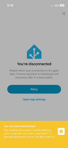

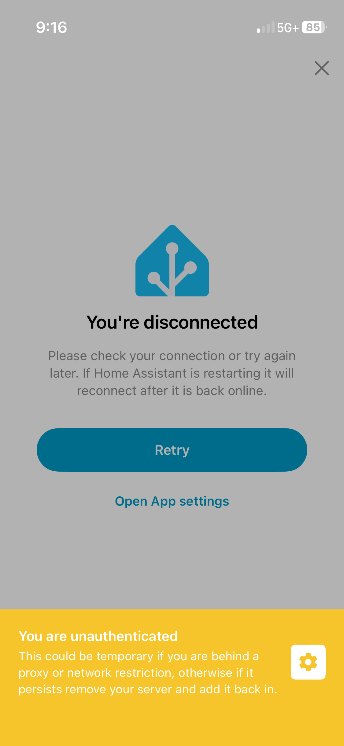

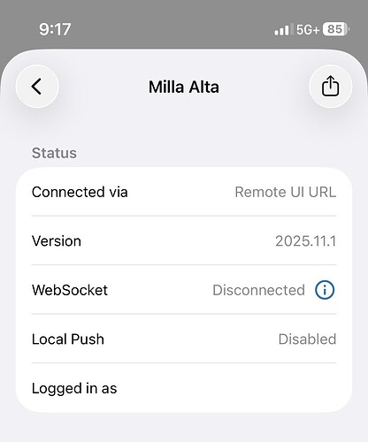

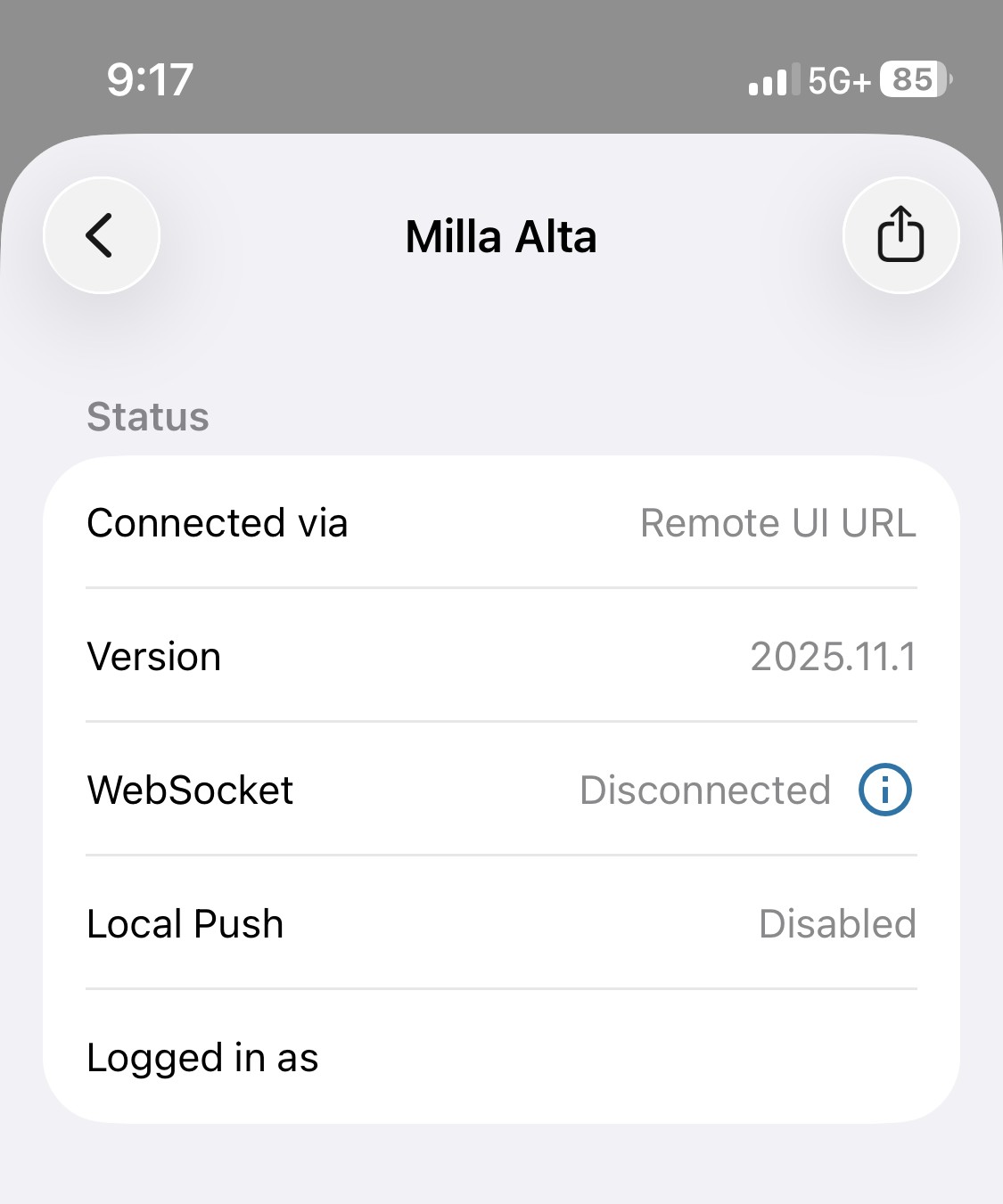

This may, or may not, be related to my local loss of connection issue. Recently (2025.11.0) I’ve also been losing my remote Nuba Casa connection. The mobile app will initially connect to the server remotely, but like the local connection, will drop when placed in the background. Once dropped, the HA mobile app will not reconnect remotely. HA server websocket connection reports disconnected. Deleting and re-adding the server in the mobile app has not solved the issue.
The following appears on screen:
Server:
Installation method Home Assistant OS
Core 2025.11.1
Supervisor 2025.11.1
Operating System 16.3
Frontend 20251105.0
Mobile App 2025.10.0 (2025.1443)
