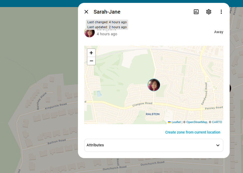

here’s a prime example
showing last updated 2 hours ago, but that’s not where the device currently is - as proven by using apples “find my”.
The device is actually quite a bit further to the south west, but i’m guessing because the cell tower hasn’t changed since the last time it was able to update then it just sits there in the wrong location.
