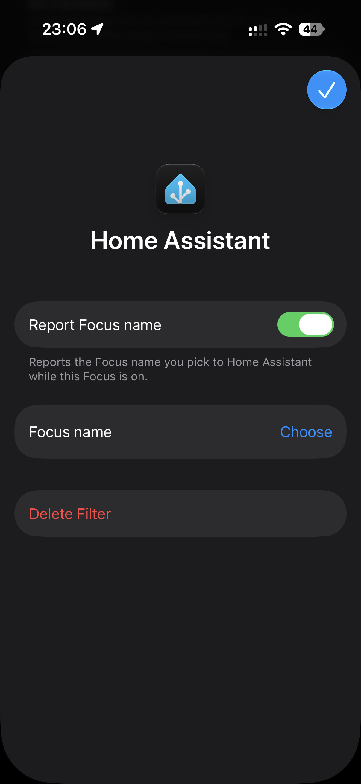

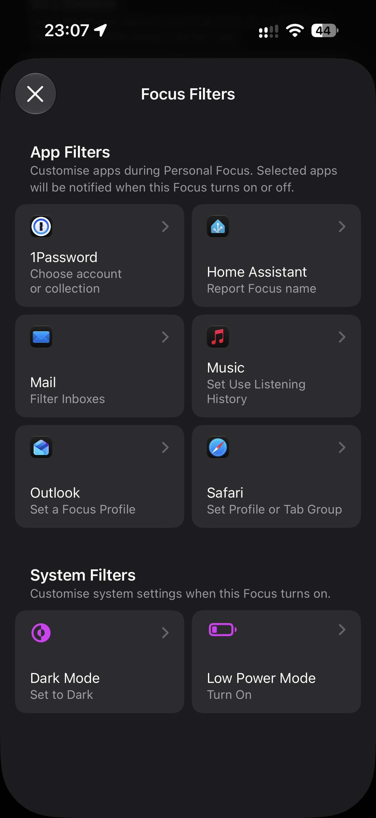

Otherwise - in iOS 27 I’m trying to set up a focus filter that reports the focus name to HA. There’s a focus filter, and options to set - but under focus name, there’s “no options available”. Anyone know how to set this up?
I want to be able to report specific focus names to HA which I’m is the point of this?

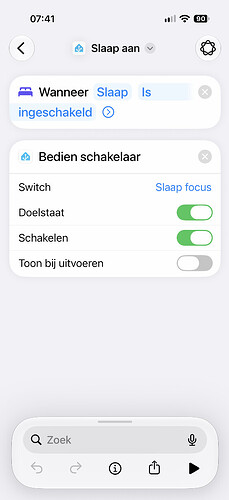

I only use it with the Sleep focus. I have setup a binary helper in HA. Using the Shortcuts app (and the Companion app) you can target the switch based on Sleep focus state. On or off.

  1. Added a binary helper switch in HA.
  2. Make sure the HA app is installed on your iPhone
  3. Open Shortcuts app
  4. Add an automation: when Sleep focus is enabled then change switch in HA you created in step 1.
You can create a second one for example when sleep focus is turned off. For me my bed lights turn on. When sleep focus is on, the adaptive lightning is set to sleep mode, etc.
I already use shortcuts as you describe - and this only works for Sleep mode.
In the new TestFlight version, it allows the iPhone to report back any Focus type.
Why it’s already in the iOS Focus settings when it’s a TestFlight option is beyond me.
But I am now using it and it works.
