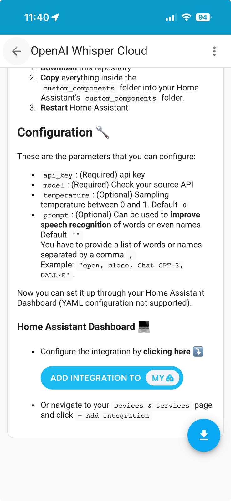

In the IOS HA app i was looking at a integration page. The arrow back to the app is not working. Also clossing the app (swipp in IOS) does not help. The app starts in the same window. I have updated the app to version 2026.1.1 and still the same problem. Annyone the same problem? Maybe a solution?

It is not so much a bug per se as a problem with IOS. IOS requires apps that are killed in the background to open at the page where they were. This can be a problem for pages that rely on ‘back’ to return to where they came from, because after a restart of the app, there is no page history.
You could also blame IOS for not providing a way to clear the cache on apps. The problem does not exist on android.
For yourself it is good to remember not to leave the app open on a page like this and switch apps. Because IOS will kill the app in the bckground if it feels like it and then you are in this mess.

For iOS this is how I came out:
  • Turn on flight mode
  • If needed, swipe down, so that the current page attempts to reload
  • When you see “you’re disconnected” in the Home Assistant App, press “Open App settings” (under the “Retry” link)
  • Go to “Gestures” → “Shake” and set it to “Show sidebar”
  • Turn off flight mode
  • Shake the app, you will see the sidebar and can exit the plugin prison :slight_smile:
