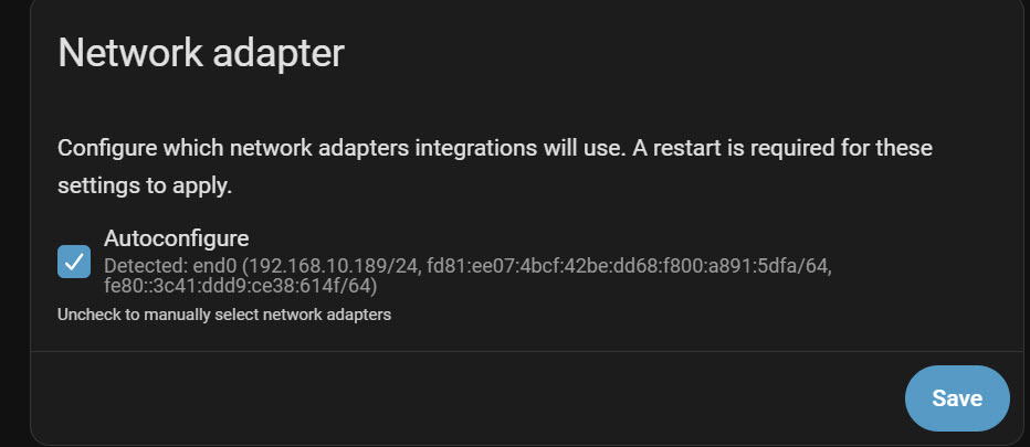

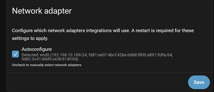

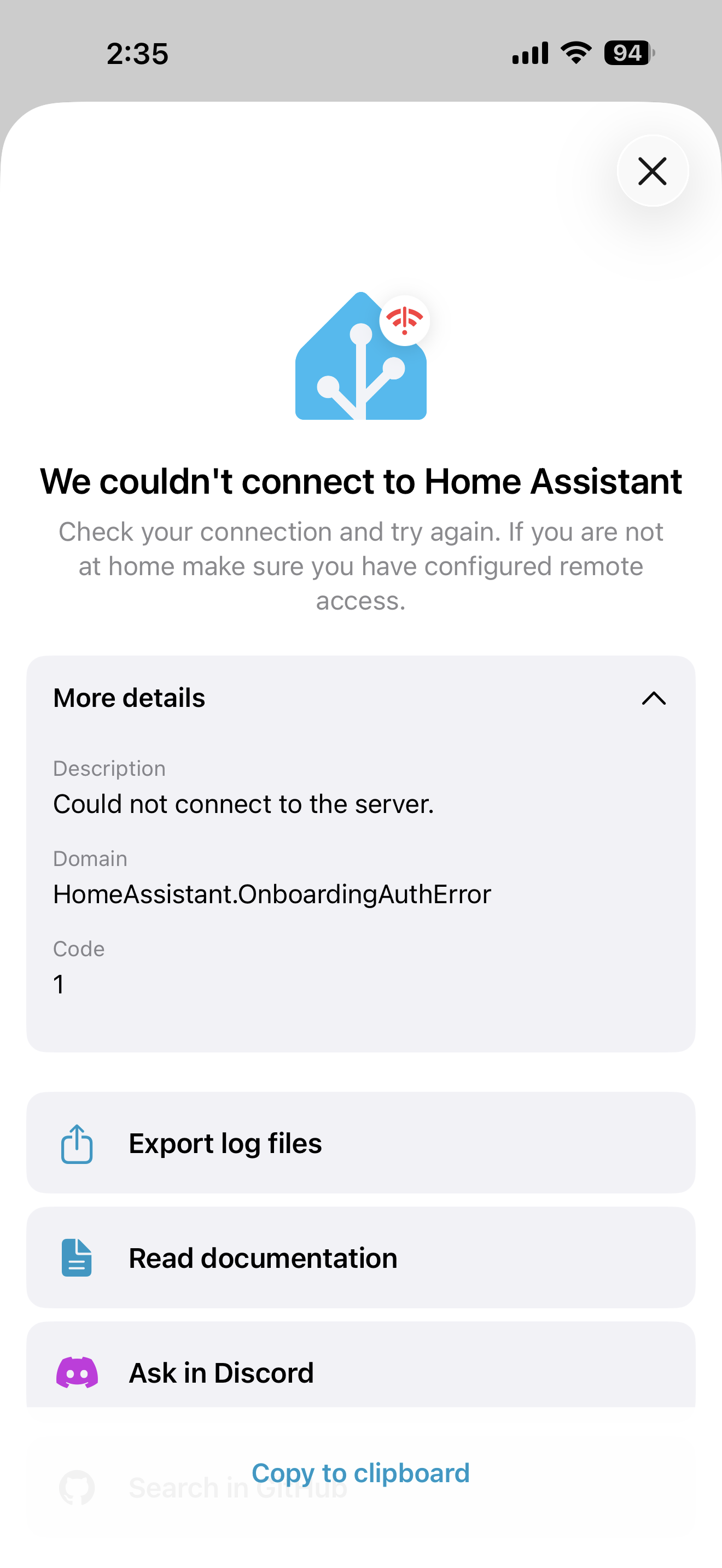

I have Home Assistant green installed. I can connect to it via the Mac and windows Compainion app no problem (both hardwired), but when I try to connect to it using either my iphone or my iPad it will not connect
I have read here and tried Turing off private addressing and it made no difference; I have made sure my VPN is off and it made no difference.
My Home server is hardwired and my mobile devices are of course wireless (you can see the setting page from the HA

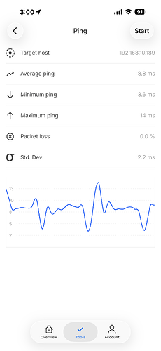

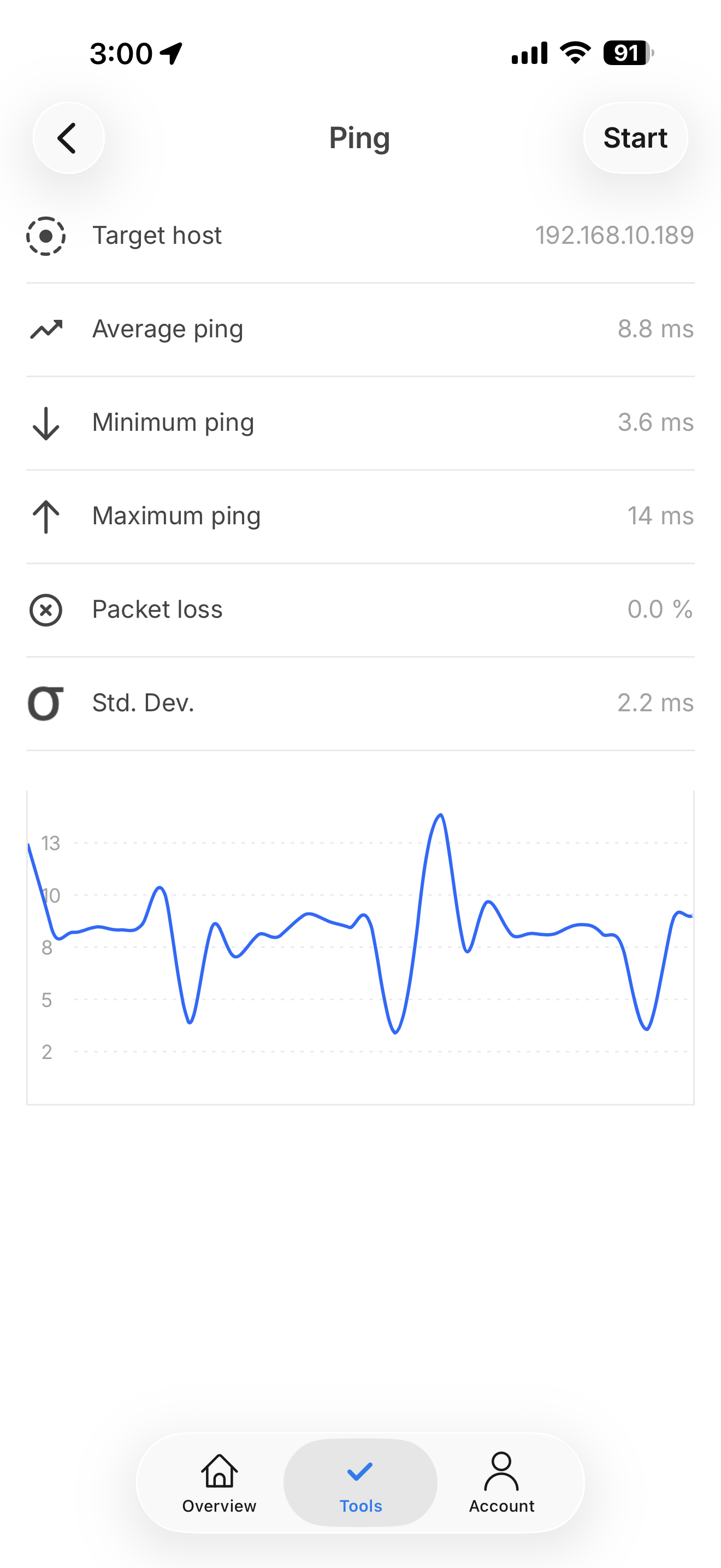

I am hoping it is something stupid… You can see the fing - ping in one of the attached images that is successful. so I am lost..

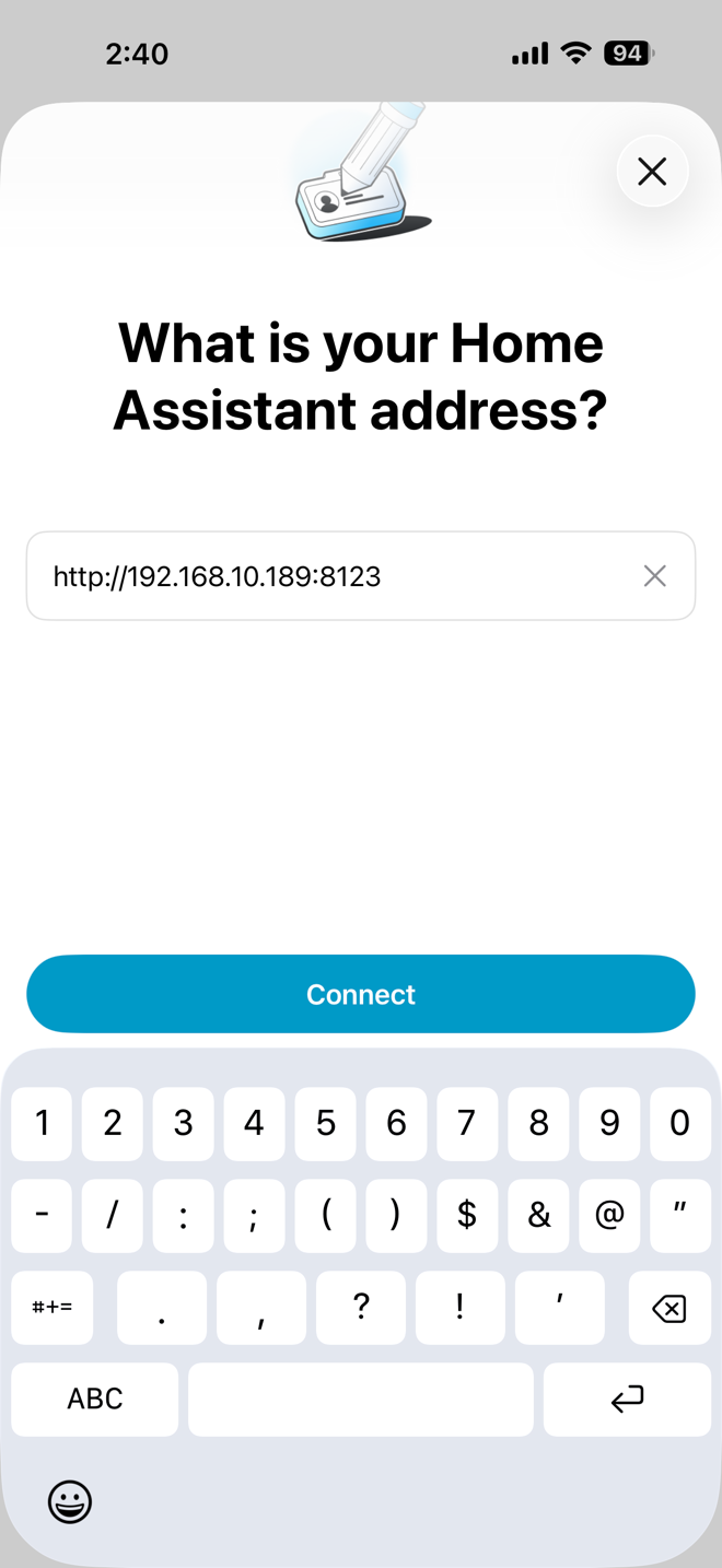

Is it a new install? The default port changed from 8123 to 80 some weeks ago. Try removing :8123 from the url and try connecting. 80 is the default port for http so you don’t need to specify it.
