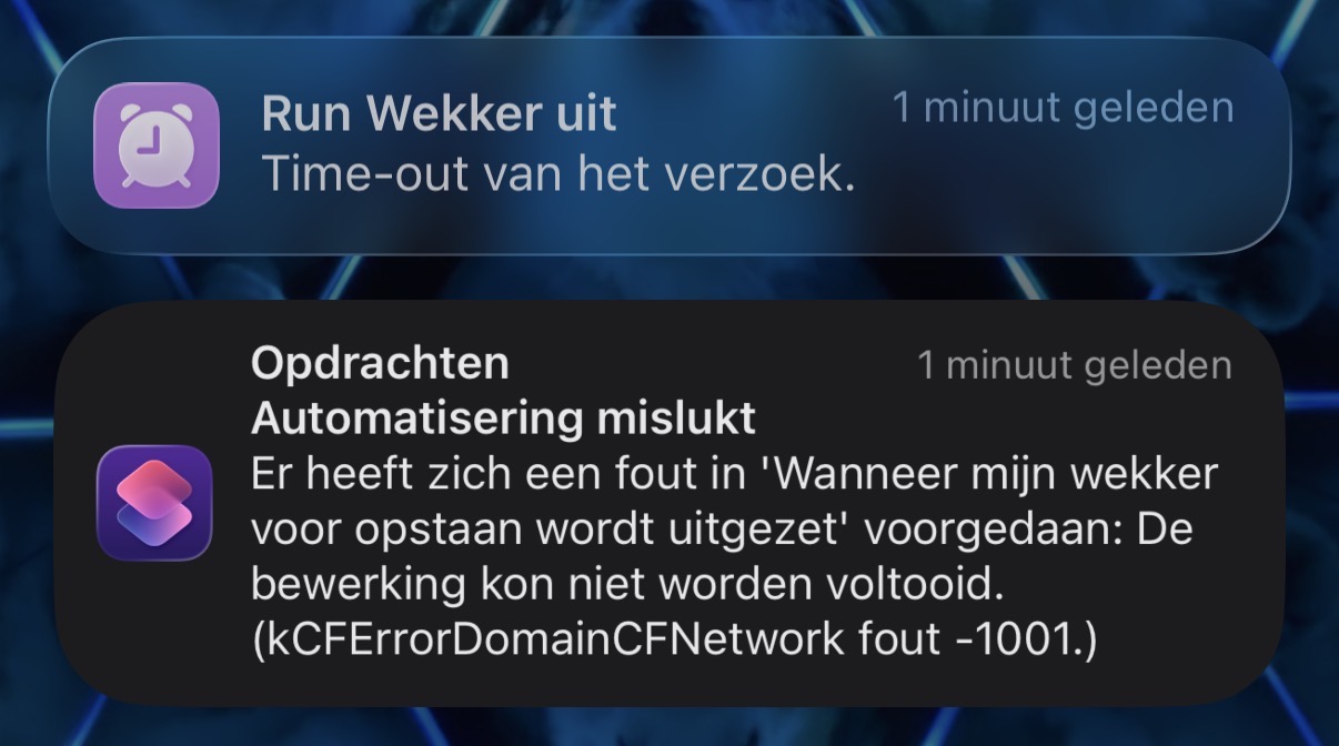

iOS shortcut that triggers script often times uit despite running correctly?

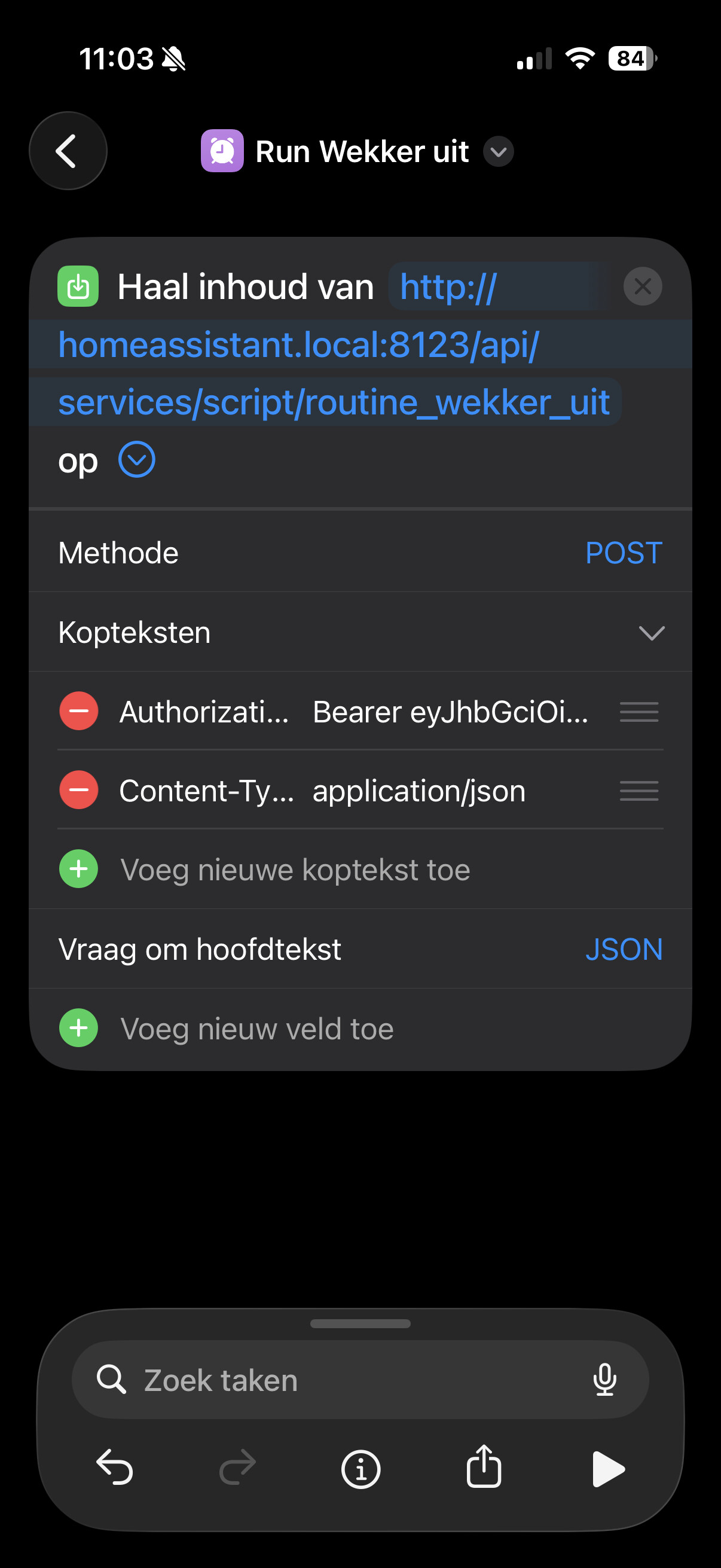

I’m trying to have “wake-up alarm being turned off” as a trigger that makes a wake-up script in HA run. I’ve been trying all kinds of things and despite the script running about 99% of the time, my iPhone often gives an error about timing out or the kCFErrorDomainCFNet error.
  1. I’ve created an automation of “when my wake-up alarm is turned off”
  2. This automation triggers the shortcut ‘Run Wekker uit’ (Run alarm off) which uses ‘Get contents from url’, using the URL ‘http://homeassistant.local:8123/api/services/script/routine_wekker_uit’. The authorization is ‘Bearer [long-lived access token]’, content-type is application/json. No further content such as entity_id because the URL already accesses the script directly (though I DID try that, but it gave the same result).
  3. This then fires the script correctly (meaning, it runs all the stuff in the HA script)
  4. However in shortcuts it can be seen that the shortcut keeps running, seeing as the ‘get contents from url’ command stays green for a long time. Eventually it times out.
I’ve tried a lot of things: My first foray into the connection was by this script: https://community.home-assistant.io/t/sync-ios-17-sleep-alarm-to-ha/622297/68
I then wanted something more flexible/adaptive so started with an HA automation which was triggered within the shortcut with ‘trigger automation’. This gave an ‘IntentsErrorDomain’ error from shortcuts and the error from the HA companion app that rendering the action took too long.
Then I switched to a script, after reading that that might be a better fit. Using ‘Call service’ with script.turn_on, combined with the dictionary input of entity_id with script.routine_wekker_uit. Gave the same errors.
Finally after reading about it online, decided to use the ‘Get contents from URL’ command as it fires it directly. Which produced the results seen above.
What am I doing wrong? How can I prevent the time-out of the request? Or have HA give a “yes it’s done” command back to shortcut or something? It seems like it’s waiting for a response (which it never has to do, it just has to fire the command) and erroring on that.
The script runs fine by itself, so it seems a shortcut/ HA-companion app-specific issue.
PS: see also Error 1307 & Can't change service in iOS shortcuts for more info / printscreens about my initial approach, though the change service thing has been fixed afaik

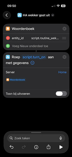

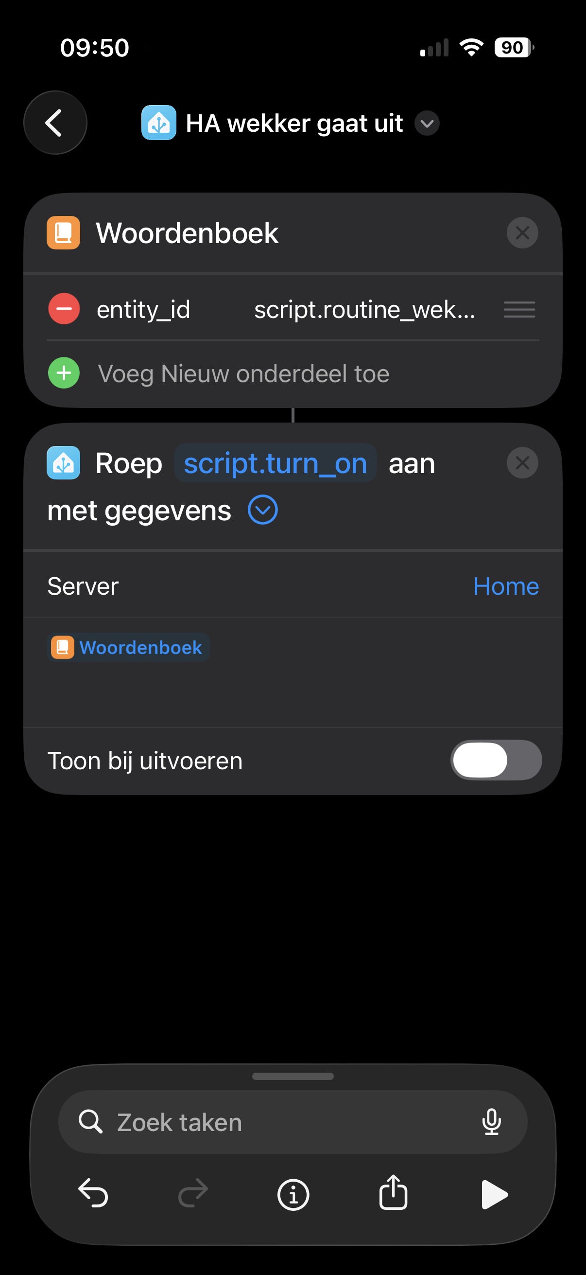

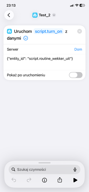

Yes, it waits a few seconds for the script to finish and times out if it doesn’t. The solution is to run the script via the script.turn_on service/action (i.e.: “fire and forget”)
  1. change the url so that it ends with .../services/script/turn_on
  2. add a request body (JSON) with the key entity_id and the value script.routine_wekker_uit

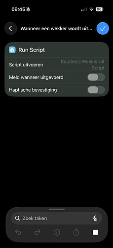

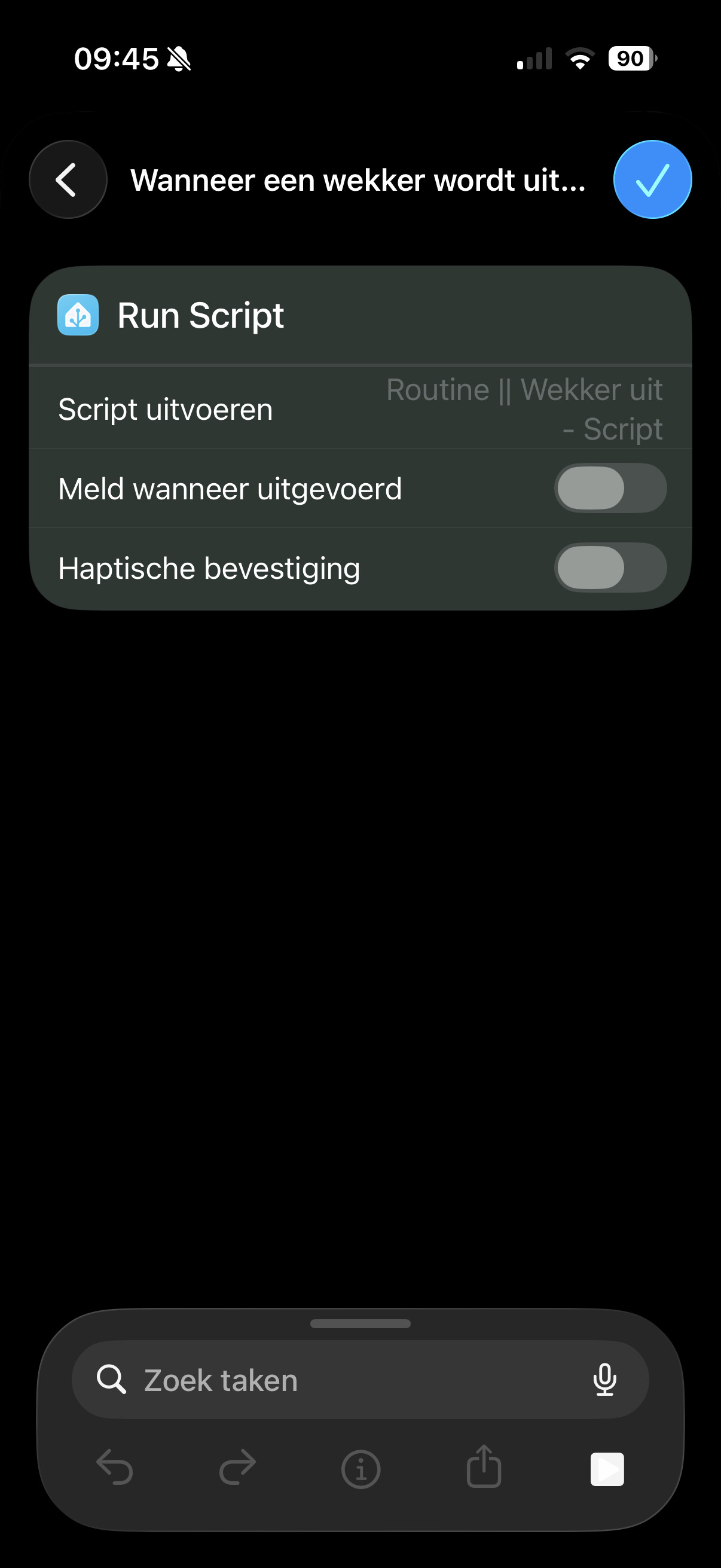

You can call the companion app directly from a personal automation, that has been the most reliable for me.
What do you mean exactly? The ‘normal’ companion app options give me the errors as well.
@slimak I’ll try! It didn’t give me any difference during testing, but have changed it and will check how it will run in the morning.
You can achieve the same thing with a “normal” application, but again you’ll need to use script.turn_on instead of running the script directly. The action is called “call service” or something similar and looks like this :
Ohh that. I’ve used it prior to the URL-one, but this one gave errors just like the run automation one. See the OP.
Sorry, I somehow missed that sentence :slight_smile: All I can say is that the timeout wasn’t caused by waiting for the script to finish (when you called script.turn_on). So I hope bypassing the application will help.
Besides, the shortcut is an intermediate step - perhaps calling it is causing these issues. Try invoking the HA script directly from the iPhone automation (I think that’s what bazfum meant).
No problem! It IS a big OP haha. About the change in URL, I’ll know tomorrow morning. Despite my HA automation itself working through the different options discussed here, I’m very annoyed by the errors since they’ve been popping up a long while now, they shouldn’t have to pop up imo. I just want them gone!
About bazsfum’s comment: I don’t see any options to call the HA Companion app directly from the Personal Automation tab? The only option I have is to create a shortcut where I CAN add a command through the HA Companion app (or the get contents from url one and bypass the app) and have a personal automation call that shortcut based on a trigger (alarm off, in this case). There’s a bunch of other app options available, but no HA.
Yes, that’s what I meant. When you select “Create Shortcut” within a personal automation, it “unlocks” more actions for that automation and no (named) shortcut is created. I don’t know if this will make a difference, but it’s worth a try.
Hmm it doesn’t seem to work either. Calling it directly didn’t even run the automation.

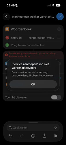

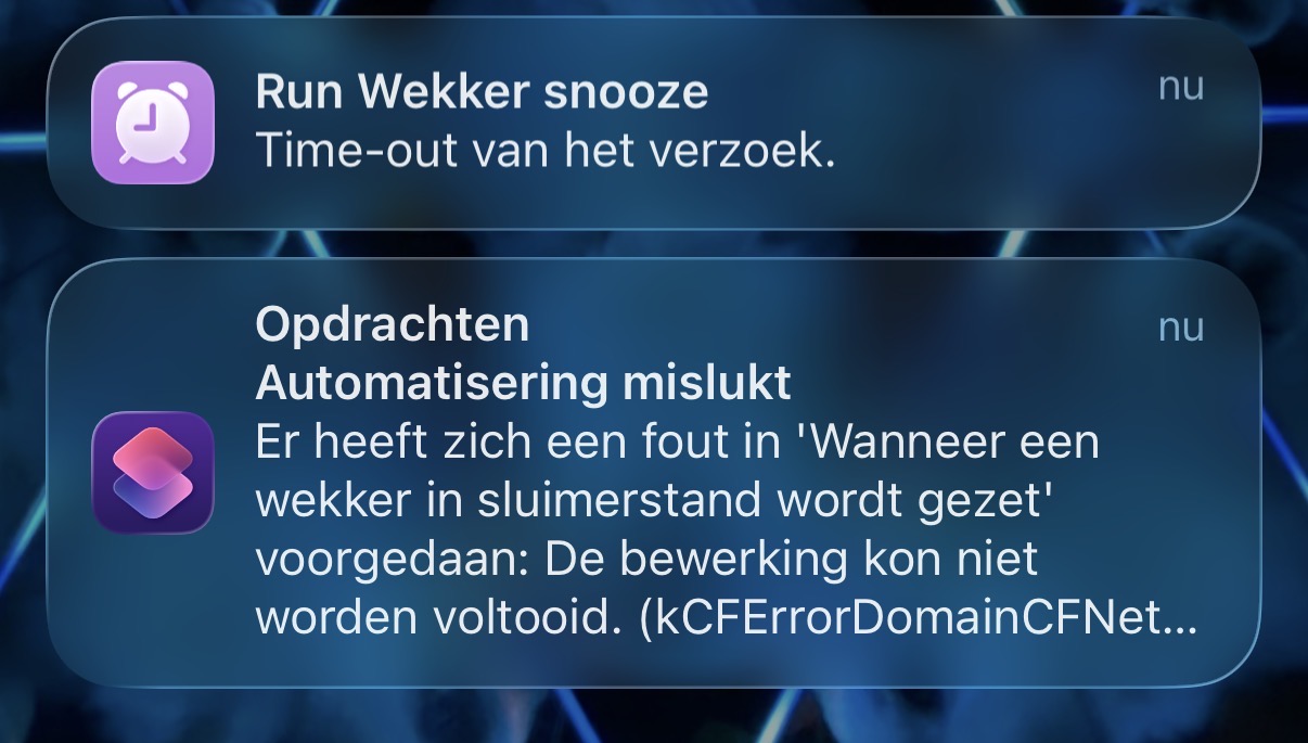

And fixing the URL to turn_on instead of the script directly still gave the same error by the way:
By the way, the errors can’t always be replicated.
My alarm snooze automation works after testing it a few times this morning. Both when manually activated and through an alarm. But the alarm off automation (exactly the same, except for the script entity_id) and being called in the personal automation with alarm off instead of snooze -though manually it times out too. It has the correct entity_id too, I’ve checked over 10 times now.
