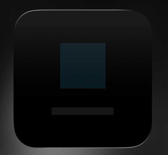

With today’s update my homescreen widget has become empty(see screenshot).
I have tried to re-configure it in homessistant an on edit Home Screen by no luck ![]()

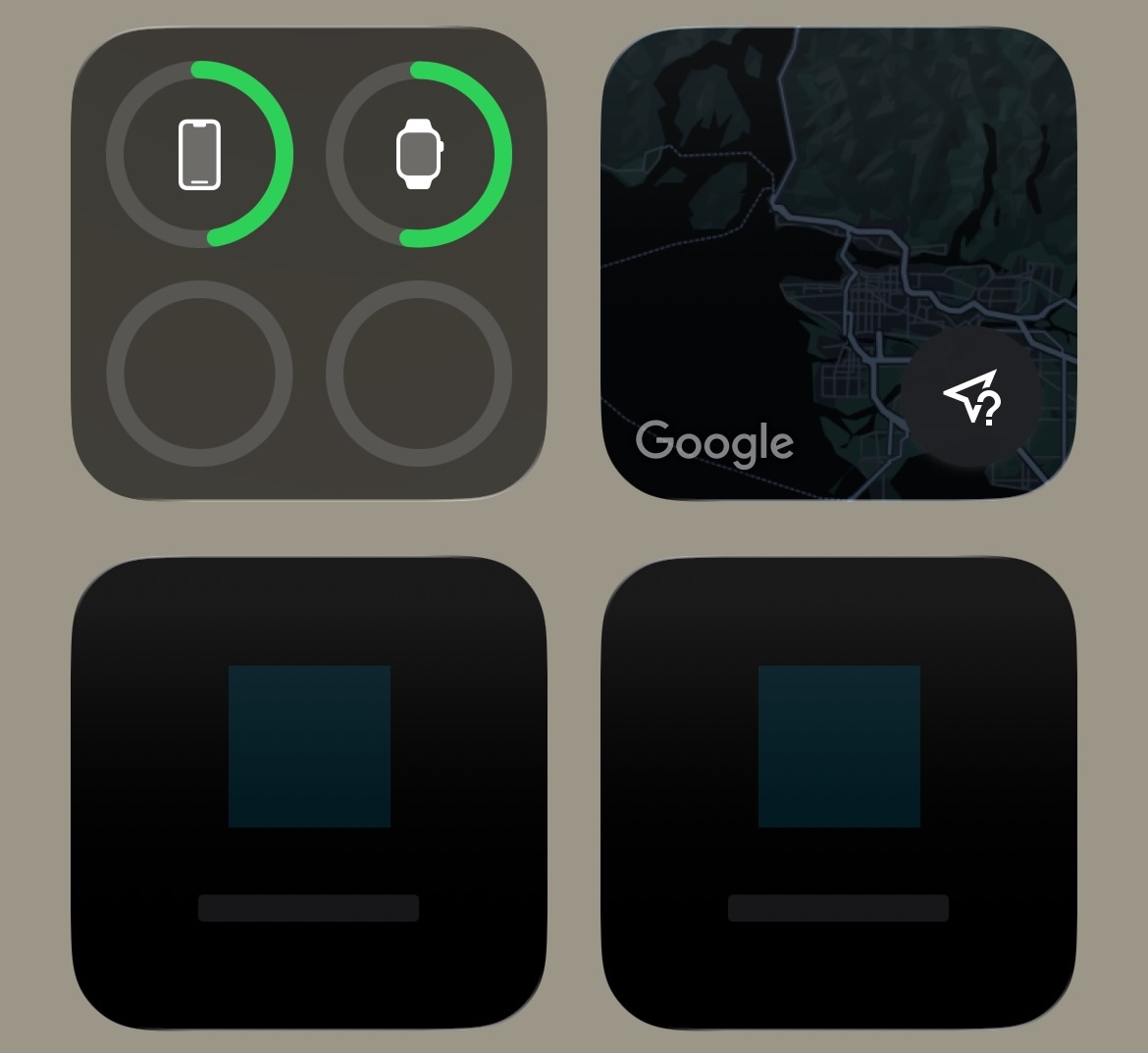

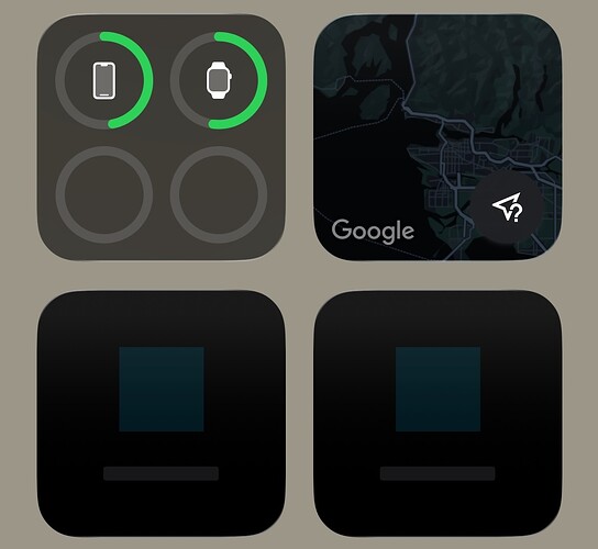

Same here. Neither iOS actions nor the new widgets work.
Same for me. App deletion, reboot and reinstall didn’t work either. Sensor widgets work. Scripts and actions don’t - all blank and unresponsive. Control Center and lock screen widgets are also affected.

I had something similar, where the wigets were just solid white, and after removing home assistant from the phone, doing a force restart on the phone, then reinstalling, the custom widgets now look like the problem you have where it looks like there’s a little square in the middle of the button. My problem only started this morning after upgrading from ios 18 to 26.2. Wish I hadn’t.

Happy to share that I solved the issue!
First, I deleted and reinstalled the Home Assistant on my iPhone.
Secondly, I created a new widget with scenes in the Home Assistant app > Settings > Companion App > Widgets > Create Widget
Finally, add a new widget in iOS and select the HA widget that you just created.
Hope this helps!
