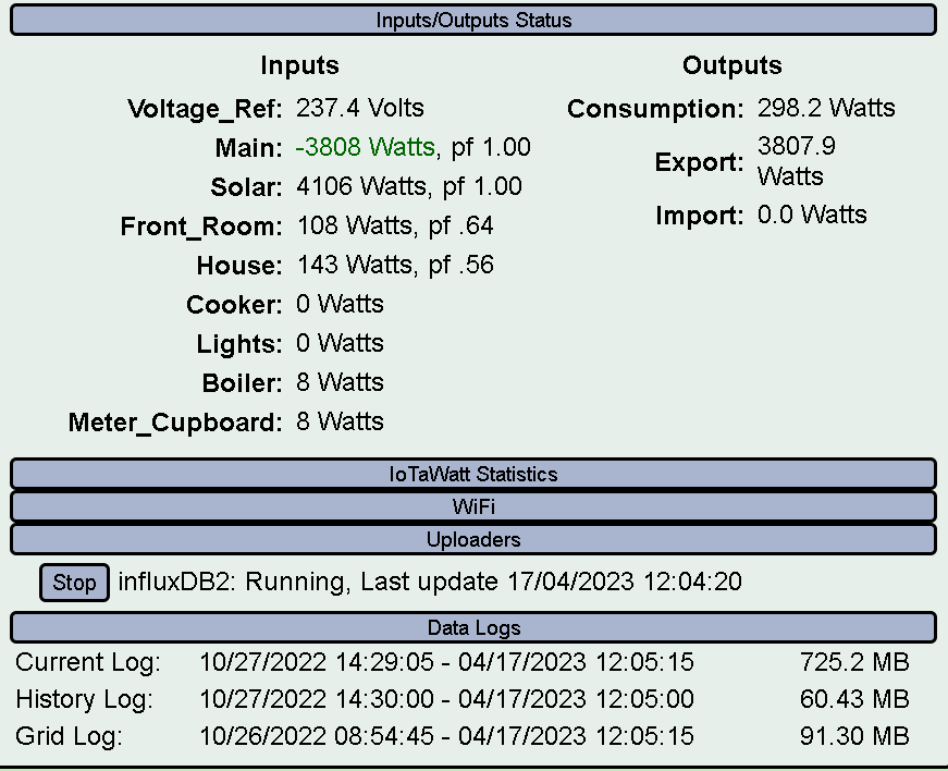

Thanks @tom_l . I have set it up and I see all my sensors/inputs (W and Wh) in the integration. but I am not seeing the outputs I have set up in IotaWatt.
Do I need to set them up in the integrator somewhere?
Screenshots of satus and outputs in Iotawatt attached.
Digging around I have found them listed under developer tools.
