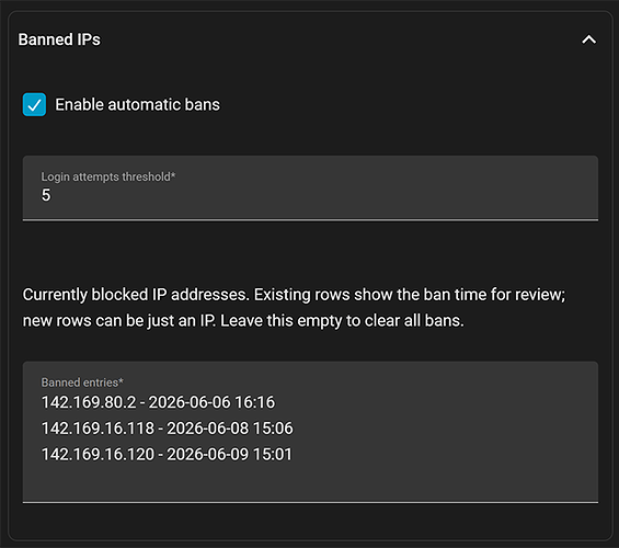

  • View and edit active banned IPs from the UI

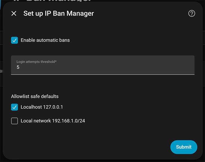

Setup

Banned IPs

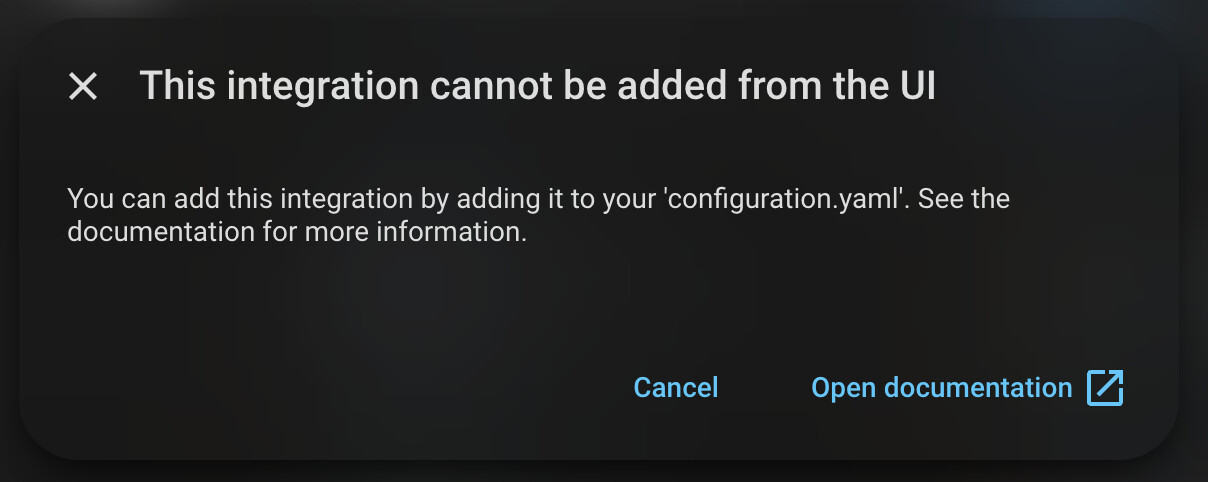

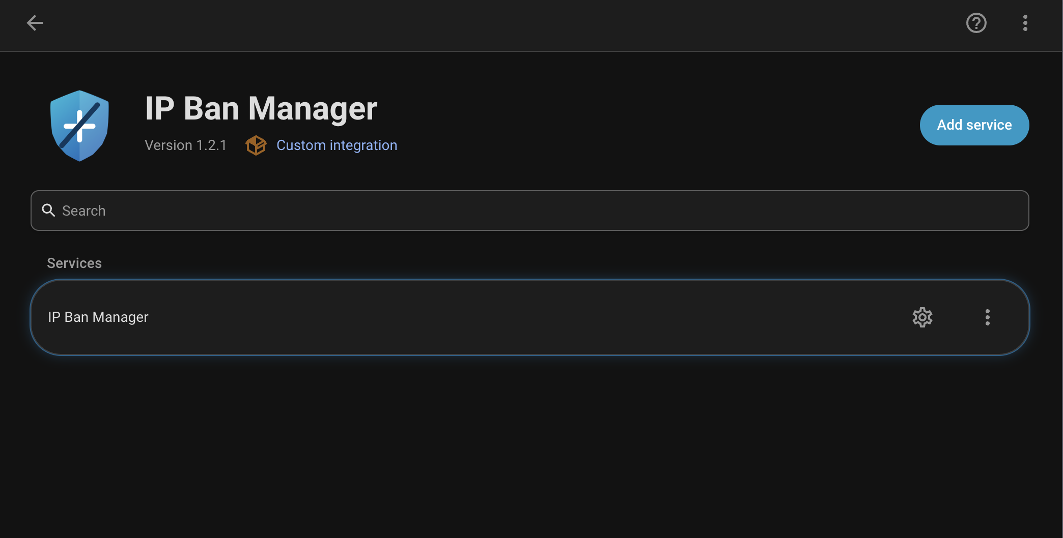

It throws this error when trying to add it as an integration.

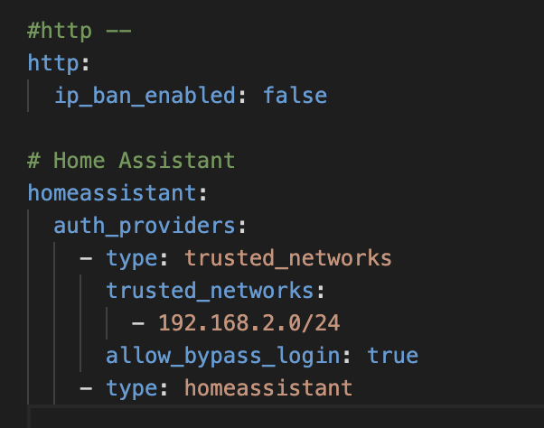

I've always had IP-ban another network settings setup in my config file so not sure what this means.
Thanks for catching this. That was a packaging issue on my side.
HACS was seeing the old migration folder instead of the real IP Ban Manager integration, which is why Home Assistant showed “This integration cannot be added from the UI.”
I just released v1.2.1 to fix it:
Please update through HACS, restart Home Assistant, then add IP Ban Manager from the UI again.
If you still have the old ban_allowlist: YAML, IP Ban Manager will absorb that allowlist on first load. After it imports, you can remove the old ban_allowlist: key and restart if you want but it's not required.
Got it setup now!

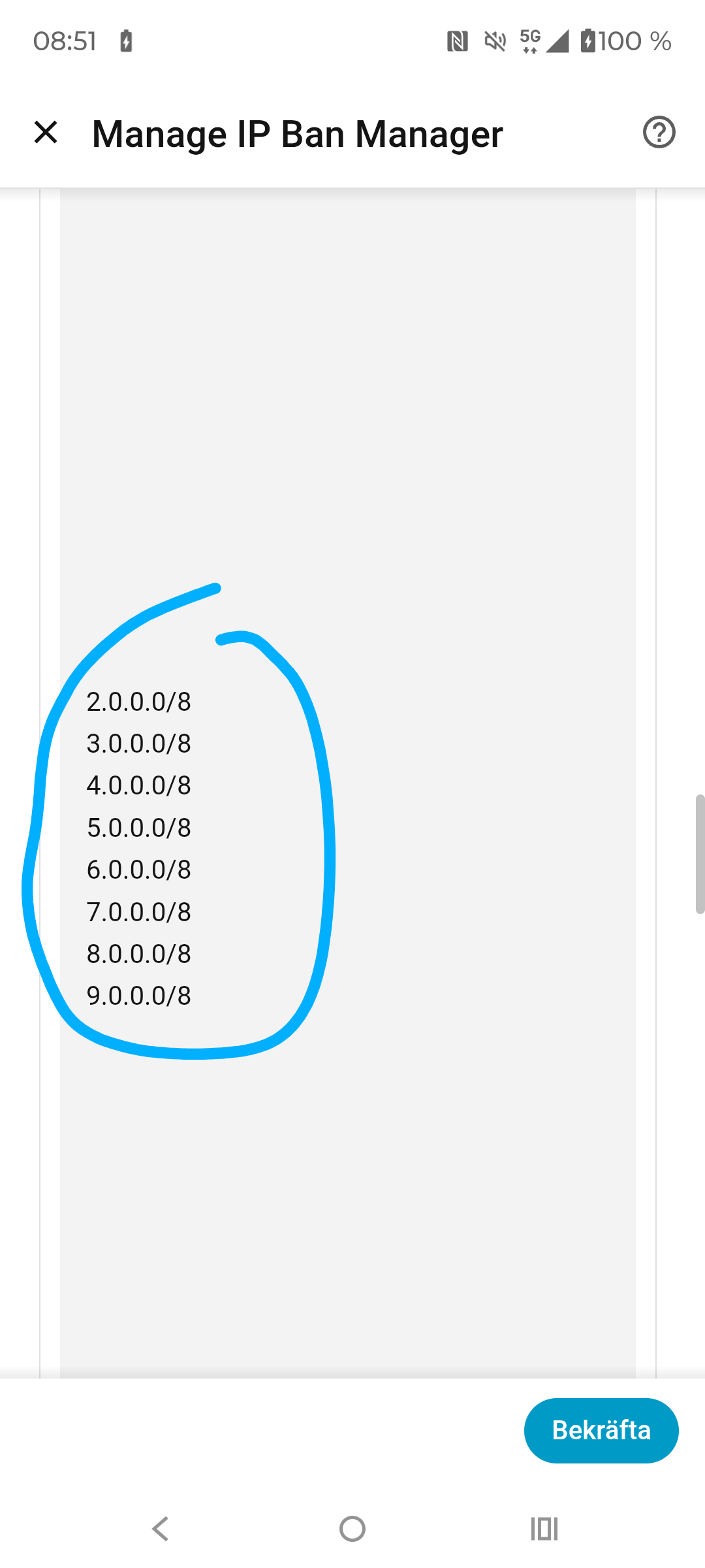

Layout is bit off:
Leave Home Assistant’s native IP banning enabled. Its threshold can remain at -1 if you want IP Ban Manager to control automatic banning.
When IP Ban Manager loads, it applies the Automatic bans and Login attempts threshold values from its own panel to Home Assistant’s live ban manager, overriding the native threshold while the integration is running. In IP Ban Manager, use 0 or disable Automatic bans to prevent automatic banning.
Keeping Home Assistant at -1 also provides a safe fallback: if IP Ban Manager does not load, Home Assistant will not automatically ban anything.
Fixed in v1.8.4.1. The backup controls now stack automatically when translated text needs more room, so the labels should no longer overlap the buttons. Update through HACS and restart Home Assistant.
