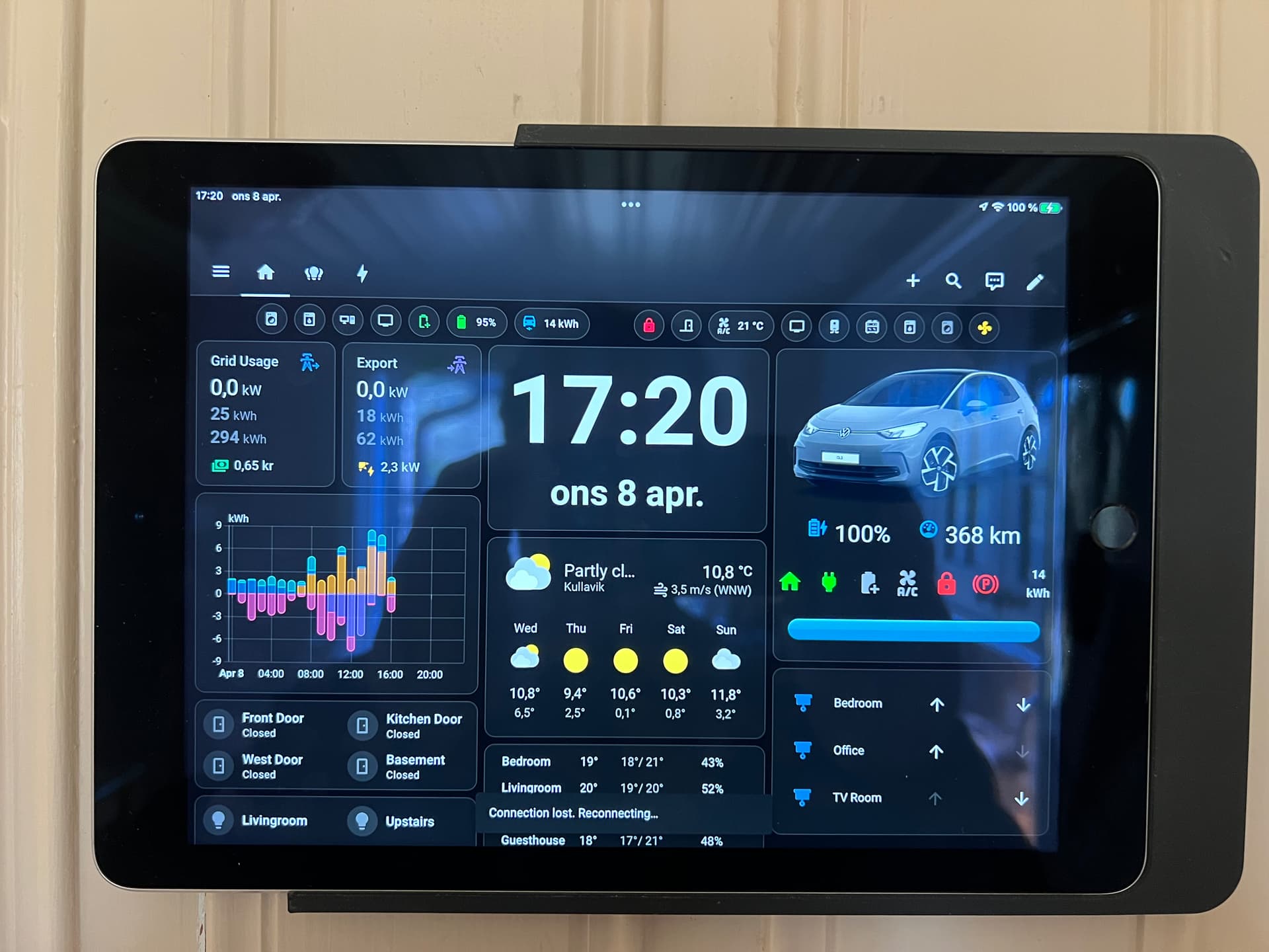

I just got a new iPad and cannot figure out why the new one has a bigger header than the old one. It’s the same user and dashboard. Does anyone know how to shrink the bigger one? :thinking:
As far as I can remember I’m not using any HACS-stuff. At least not Kiosk. It’s the exact same iPad model (Air 2) and the same iOS version. I migrated the old iPad.
I think I solved it. Running it in the browser, then saving it as an app-icon and then running it gave me back the slim header!

I can’t remember if it was the native app or a webb clip that I used on the old iPad actually, but on the new one “full screen mode” doesn’t seem to solve the bigger header-issue for me.
I have the same problem! Ugly big header even when i hide it with the Browser Mod.
BUT I did not switch iPads!
I updated my HomeAssistant and with it I think also Kiosk Mode or Broswer Mod (can’t remember which one got an update)
So it seems to be on the HA side, not the ipad or ios App side.

I made a complete backup of my SD card before I updated HA. I might roll back to the state before an pay close attention when the issue occurs. It’s defenately not a space or so. I did not change anything except update and it does work properly on the broswer. Just not in the App.
edit: On another note: My iPad appaerntly has automatic updates for apps activated and the App got an update today. Maybe this broke it.
Also this thread was opened 5 days ago and the Update dropped 6 days ago. I got mine updated today. I have my issue since today. It’s probably that. I’ll try to downgrade the app before i do anything else
yep, the recent update has caused it. yet to find a solution.
After experimenting A LOT (with downgrading both HA and the App and disabling and enabling a lot) I’m now 95% certain what caused the issue:
In the new App version (2026.4.0) the Toggle “Full Screen” in “General” in the companion App settings does not work anymore. I downgraded to Version 2026.2.1 for now uing TrollStore using an ipa from ipafilezone.su.

The “Full Screen” mode seems to be broken in the newest version. At least for my. I tested quite rigorously and it seems to be the key factor why my header was big before I downgraded to the second newest version

Just for the record I also have this 'double height header' issue on my HAss app. Also running an old Apple iPad Air 2 as a dedicated dashboard in my kitchen. I'm not jailbroken so cant downgrade. Did this get raised with the development team as a bug?
I have the same issue, solved it (workaround) by using a PWA instead of the companion app.
The app is still installed and running on the background for notifications.
