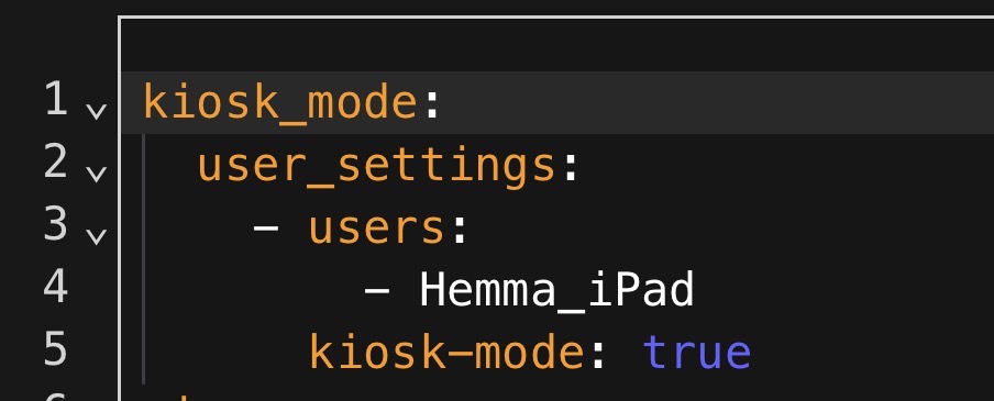

I have a tailored dashboard and add this at the top of the UI dashboard yaml-file. The username for this iPad is hemmaipad. Kiosk mode is not working.
kiosk_mode:
user_settings:
- user:
- hemmaipad
kiosk-mode: true
If I just do the below, then I get kiosk mode an all devices (!), so kiosk mode is obviously working - without flushing any caches or alike. It just works. But I don’t want it on the admin devices. The user ‘hemmaipad’ is not an admin user.
kiosk_mode:
kiosk-mode: true

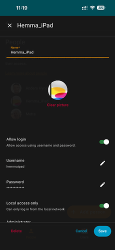

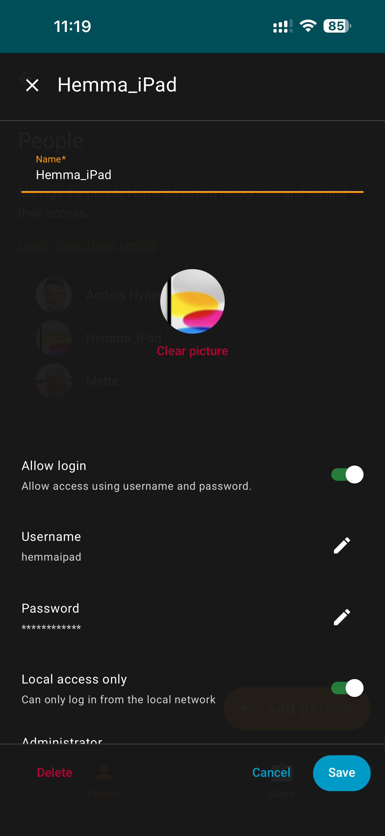

Can you double-check if the name of the user (not the username) is hemmaipad?
Also notice that it should be users instead of user.
Thx. I changed user to users. It makes no difference
And the user name is hemmaipad.
Plus, I tried this also, first with the ”s around the name. No difference either. After reload the ”s are removed.

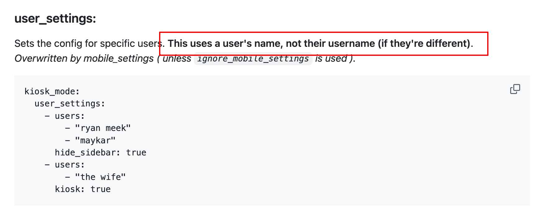

In your screenshot I see that the name of that user is Hemma_iPad. The username is the one that is hemmaipad (and as the documentation states, that is not the one that you should use). Remember to clear cache after any changes.
That is not related to the plugin, but to something in your system. Try to save the changes and when they are saved, clear cache and try again.

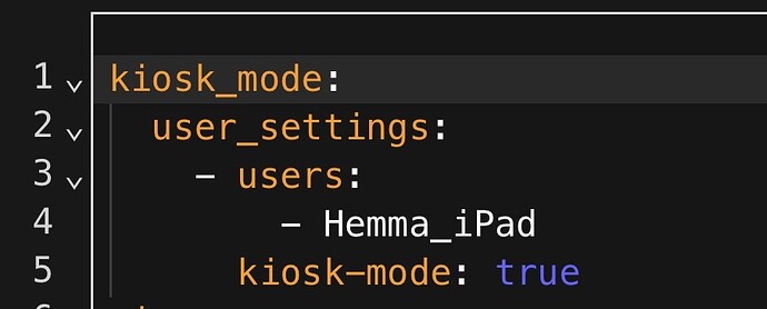

By the way, there is no option named kiosk-mode, check here all the options, I think that you need to read carefully the documentation, and then try to set it up.
Thanks guys. This solved it for me:
