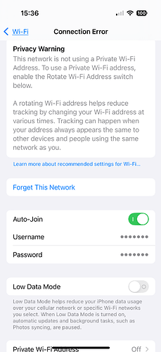

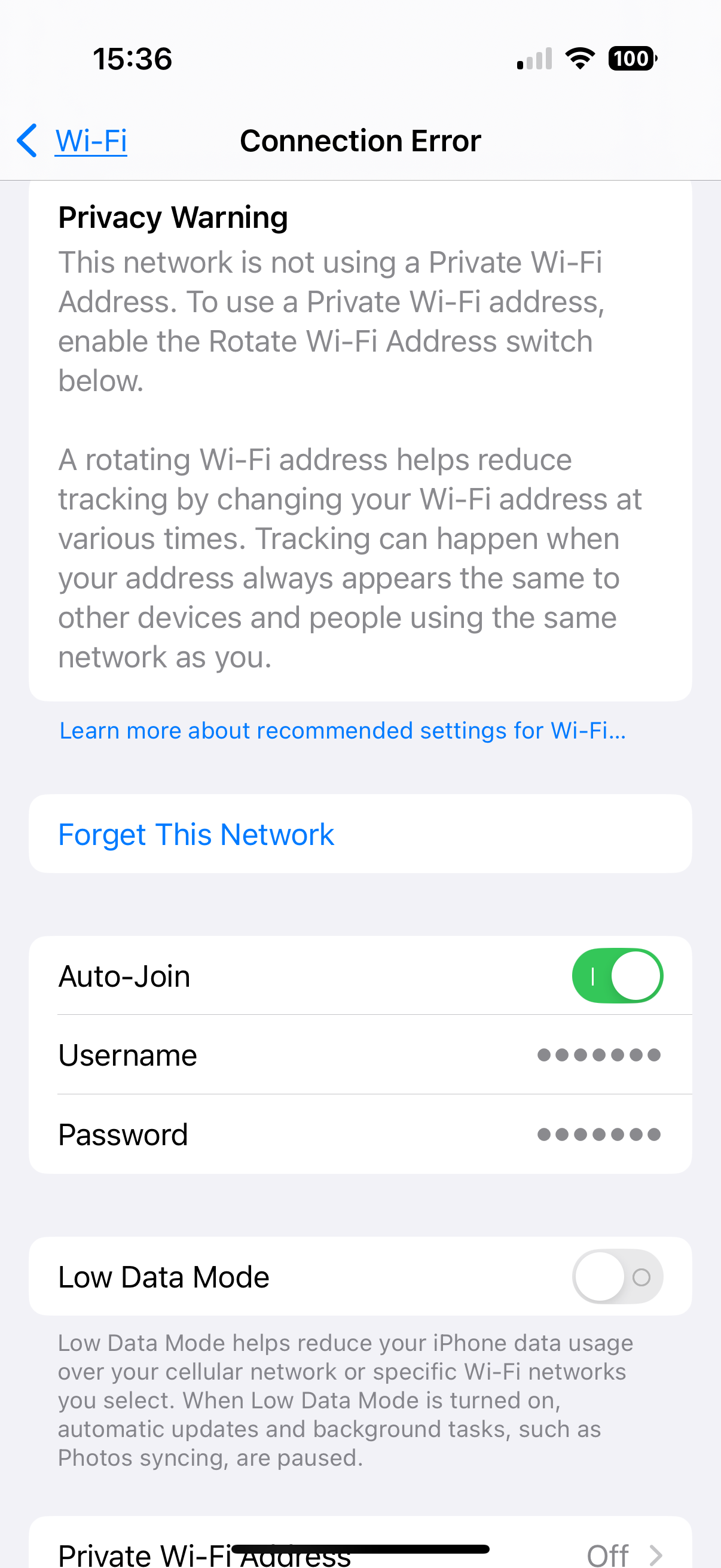

This is where it is (ignore the “Connection Error” wifi SSID name at the top):
If you have Private Wi-Fi Address enabled @duvalljm and turn it off now, you will have a third device show up in HA. Delete the other two and that should be it.
