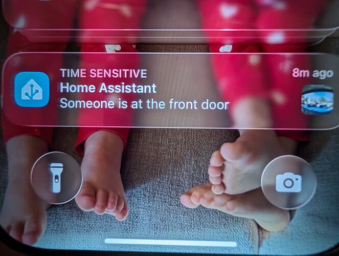

iPhone notification URIs don't take you to the correct dashboard
Here’s my action for my wife’s iPhone, I get the notification with the image, but the click action just launches the app to whatever dashboard was last used, not the dashboard I want:
     - action: notify.<redacted>
        metadata: {}
          message: "{{ message }}"
            push:
              interruption-level: time-sensitive
            image: /local/cameras/event-snapshots/{{ filename }}
            uri: /{{ dashboard_url }}

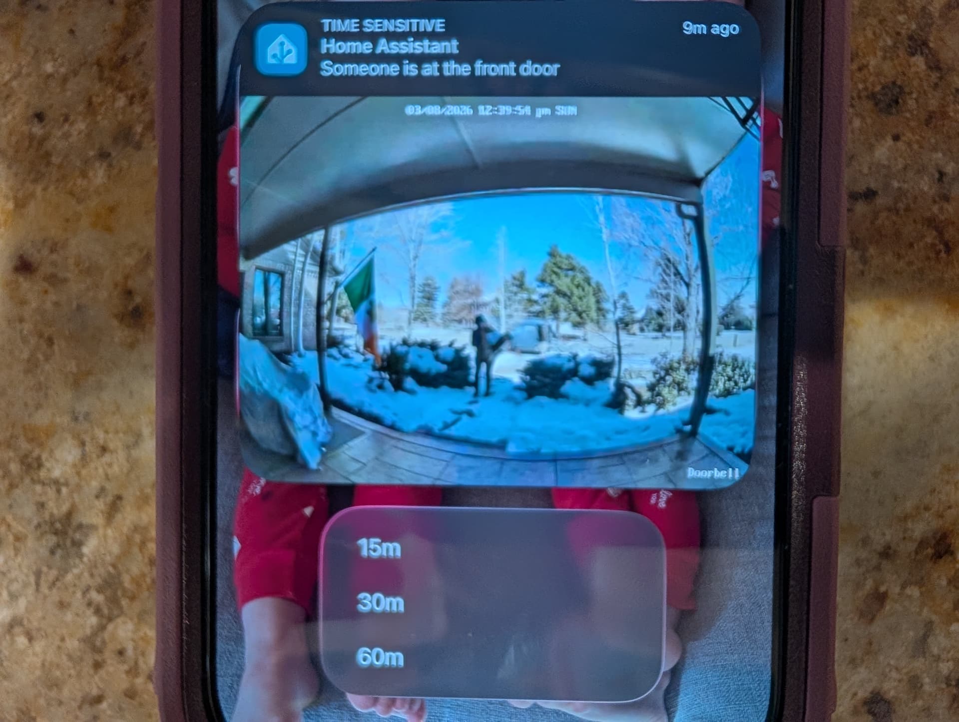

Long press the notification.
Is there any way to make the short press trigger the dashboard?
Not that I know of.
Long press doesn’t seem to take you to the URI. It instead expands the size of the image and shows any actions associated with it.
For example, I have snooze timers for the camera notifications:
actions:
  - action: "{{ action_snooze_15_kate }}"
    title: 15m
    icon: mdi:sleep
  - action: "{{ action_snooze_30_kate }}"
    title: 30m
    icon: mdi:sleep
  - action: "{{ action_snooze_60_kate }}"
    title: 60m
    icon: mdi:sleep
Trying to short or long press on the expanded notification doesn’t do anything. Clicking outside of the expanded notification shrinks it back down.
