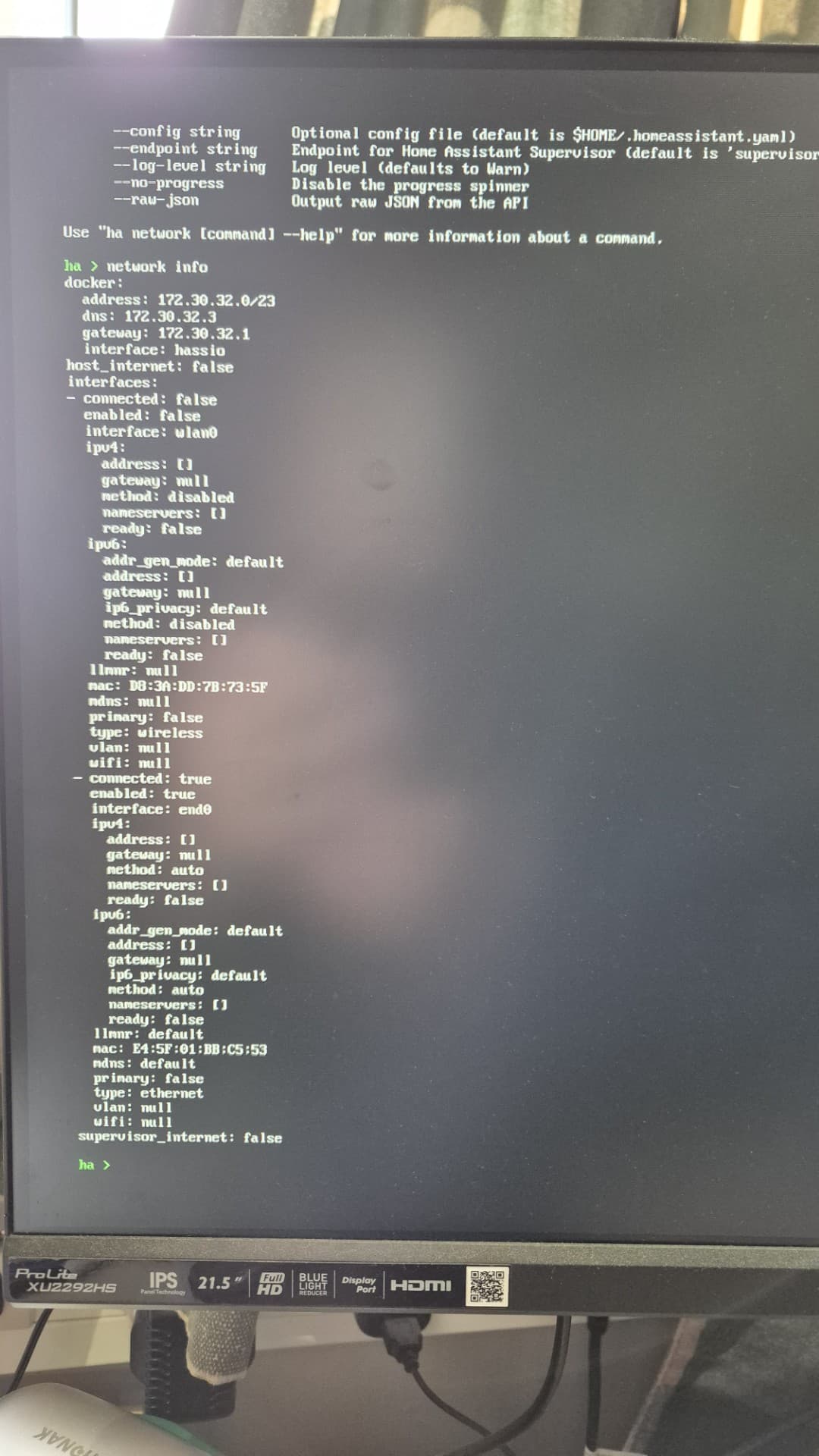

OK, I have verified that the rpi is OK, when I now insert an sd card with a fresh rpi image, in the scrolling set up there are at least 2 failed messages with the code. One something about Network manager… IP scanner show the rpi as ‘OFF’ and I can’t access HA.
Any further suggestions?
Thanks
This the info from network info

Try this if you know the IP address of your router (gateway).
Don’t use your previous primary & secondary DNS - I suspect your issue is that you are using your (Spanish) ISP’s DNS services, and that they somehow blocked HA from resolving DNS.
Use something without such limitations, like Cloudflare (1.1.1.1) or Google (8.8.8.8) DNS
