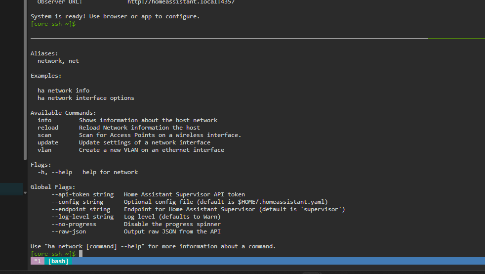

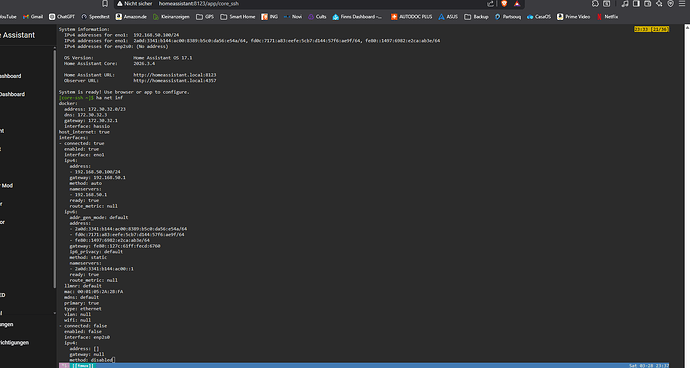

what does your ha cli says ?, net inf
Im a hardcore noop in this things, do you mean this?
yeah
type
ha net inf

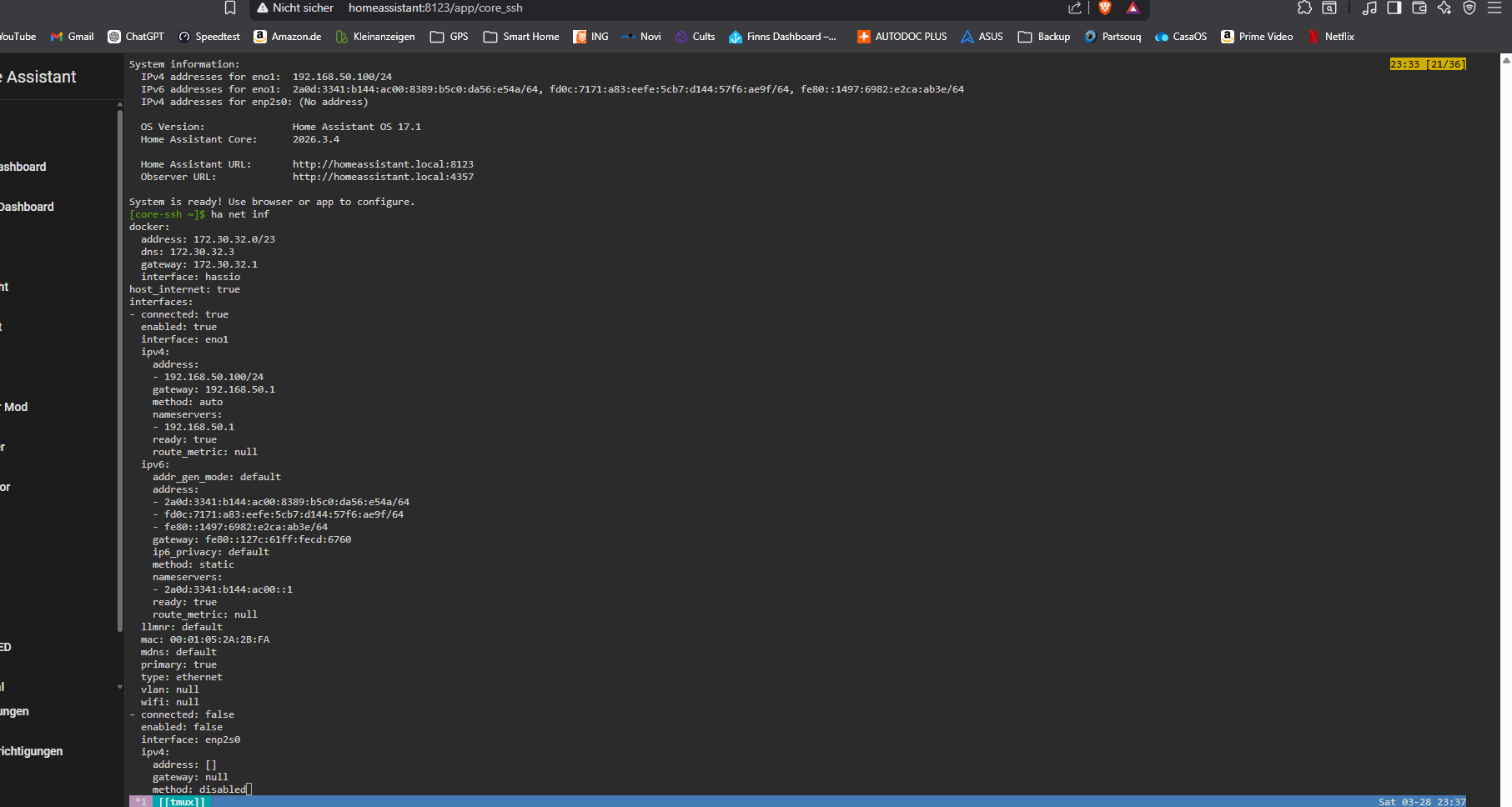

Is this enough?
why are you using “Static IPv6” ? , have you tried with auto ?
Maybe your Router and HA (which uses auto for ipv4) , will cope better with auto
I tried with auto first but it came out the same sh…t

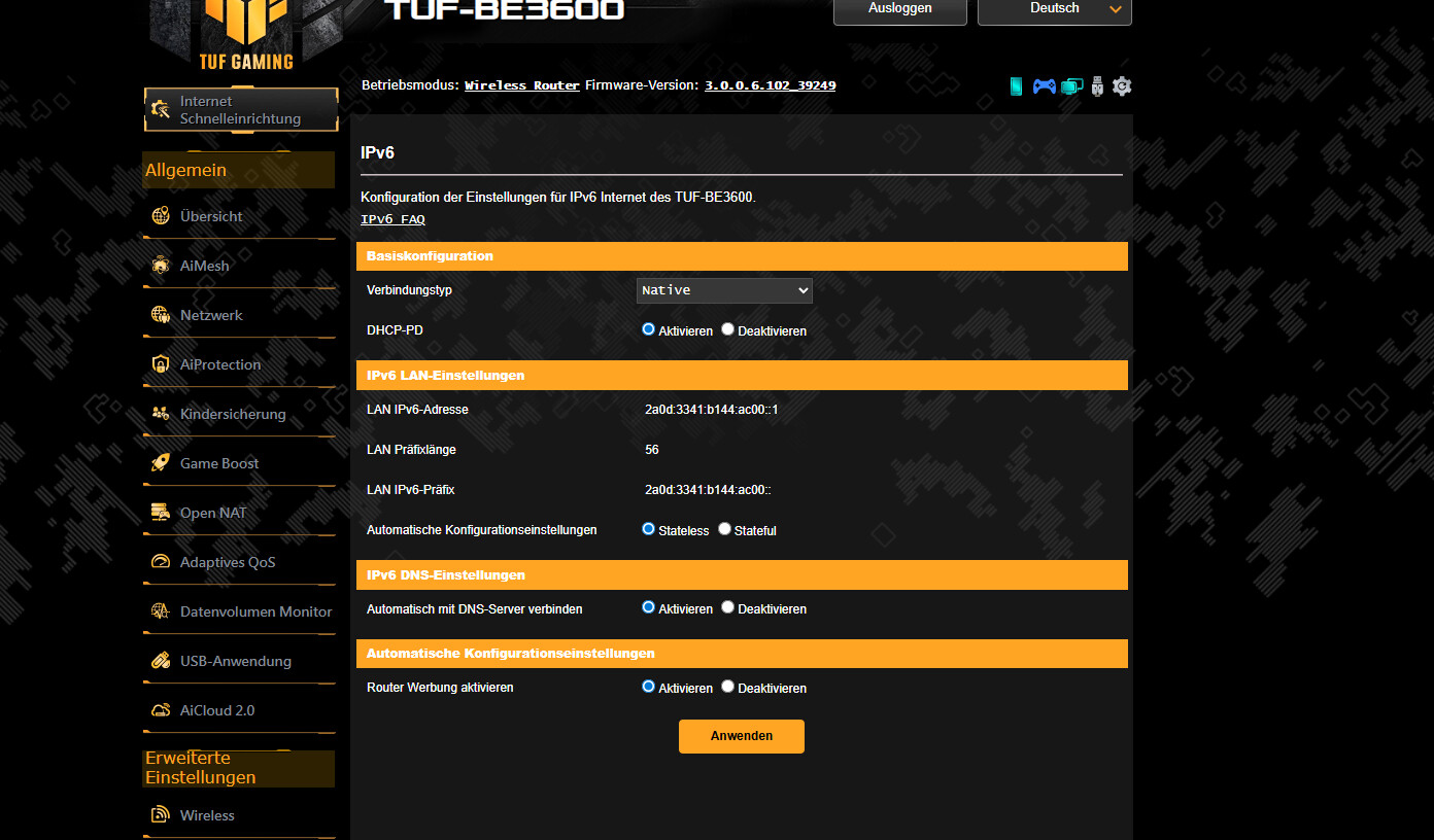

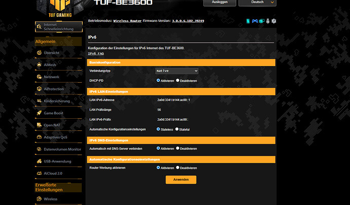

this is my IPV6 config on my router

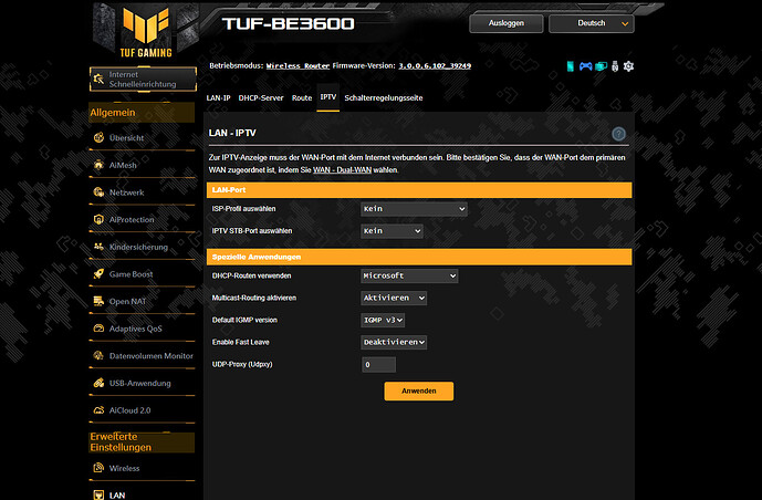

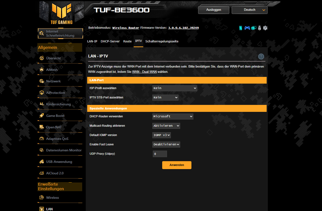

No, it’s your IPTV “config” which uses/needs dual-port settings
Do you mean this?
yes that’s your IPv6 settings site :wink: … thou i’m not into the “game” of going through your Router Settings , As your Wan-settings etc and your ISP , is a better source for this task ( To get it right )
Maybe is is as simple as choosing the native
Or Maybe you should choose what your Router-Manual tells you , in regards to your ISP Settings …
Meaning do you have a Static, PPOE or Automatic Wan-Type ?
Then Choose the Corresponding IPv6 Type
Click the FAQ in that “picture”, and you get it right … maybe
ASUS usually don’t play around, but are straight forward in their Manuals :wink:

NOTE: I suggest you revert to Auto, and check if it’s really the same Errors, Warnings and INFO , as it seems like it “suddenly” want to use your WIFI interface( for some weird reason ) (which i suggest you totally disable) , also you dont show ipv6 for that

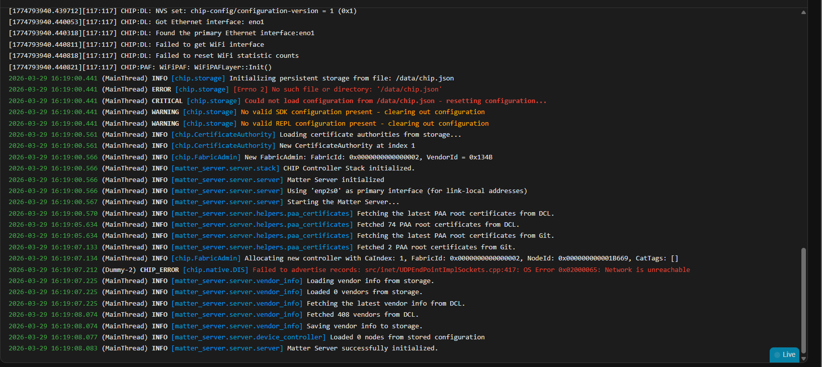

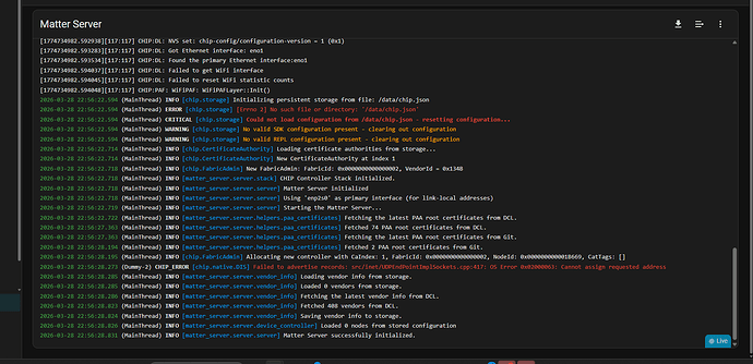

Okay, is started the App with the Matterintegration, but have the same problem…I only want to connekt a Ikea motion sensor =(
Notice it uses the enp2s0 network interface as primary for “link-local” ( for some reason ) im not sure what it means. It should use the same , as it initially found “eno1”
Have you “done” some “smart-settings” somewhere ?
as you previous showed enp2s0 has no address, and answer my request of your install-type, VM ?, in that case it should be easy to simply remove this interface
However it says you Matter-server is up and running
So whats the “issue” ?, have you looked in /Settings/System/Logs ? … 3 dots to the right, RAW-Log-file
Also, in top-right corner, choose Matter, and copy that from where it starts(blue-color)
