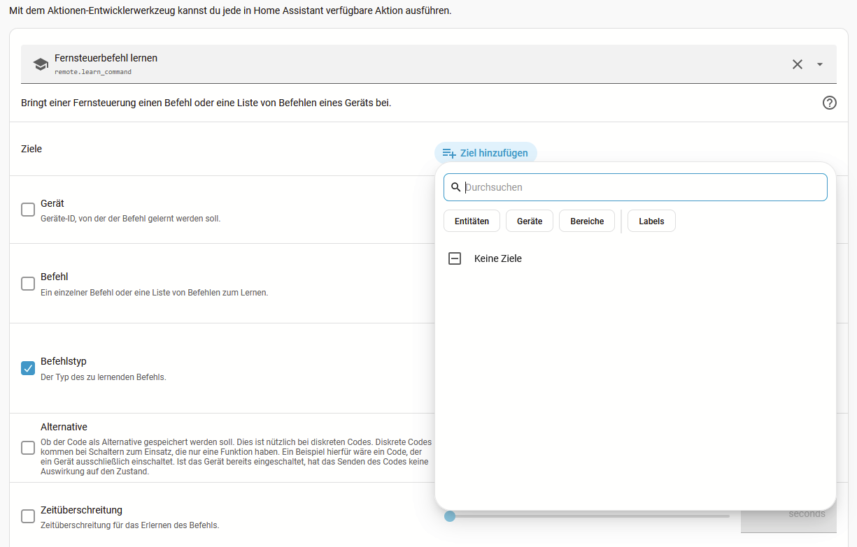

Unfortunately, if I now want to learn a command or use any other action from the remote.* actions, it will show me a target list which is empty:

It seems like you may have misunderstood how IR proxies are supposed to work.
ESPHome's IR proxy component does not create remote entities in HA... so remote actions are not the correct type to use.
Then your receiver is working exactly as expected.
IR Proxies act as "targets" for the Infrared integration which, on its own, does not create devices for any actions to target. It is a "Building block" integration that provides the structure and functions for other device-specific integrations. It is these integrations that actually integrate a device or service into Home Assistant to provide entities, services, and other functionality that you can use in your automations or dashboards. Currently, there is only one IR device integration in core, LG Infrared. There is at least one person working on a custom integration that would provide a more general option.
