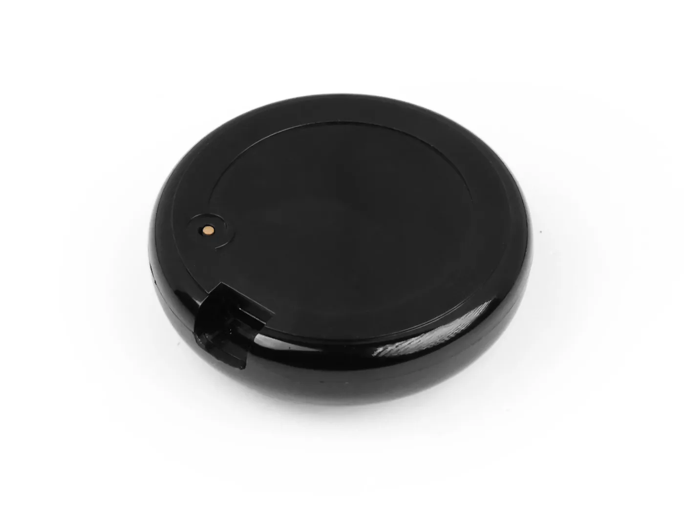

I bought a XIAO Smart IR Mate with ESPHOME so Home Assistant could send IR commands to my ceiling fan. That works fine.
Now I'm trying to do the opposite: use an old IR remote to trigger actions on Home Assistant. I haven't found any simple and easy solutions.
Do you have any recommendations for ready-made Wi-Fi receivers like my XIAO?
Thank you for your help.
Use this it has triggers so you can use a old remote to trigger something in HA.
thank you i've read this. but I don't know witch device should I buy ?
Can I use my Seeed XIAO for IR receving too ?
I have this one the range is really good.

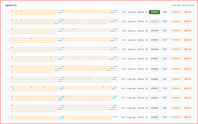

Hello
thanks for the update.
unfortunatly now, each time I press RED I’ve got a diffrent code :
here I’ve pressed RED 12 times.

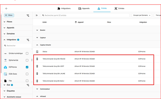

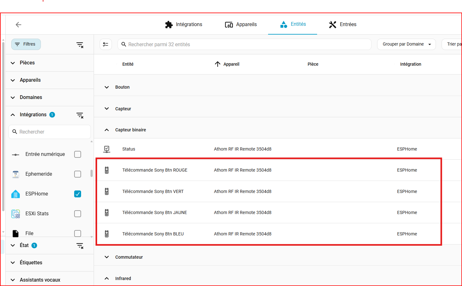

You can see 4 sensors.
the entities are shown correclty:

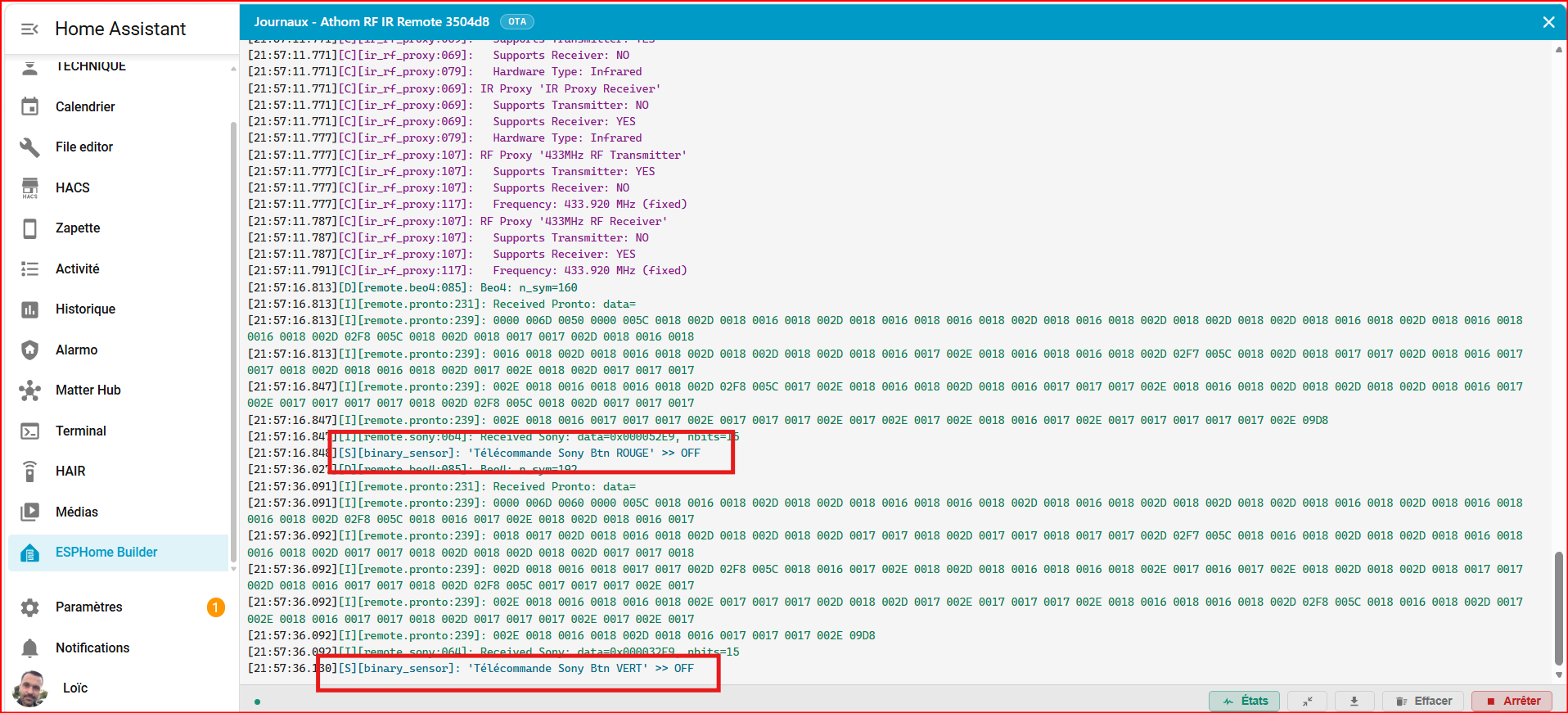

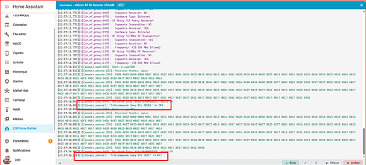

the logs of esphome shows that on key press :

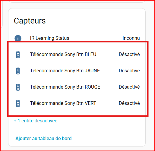

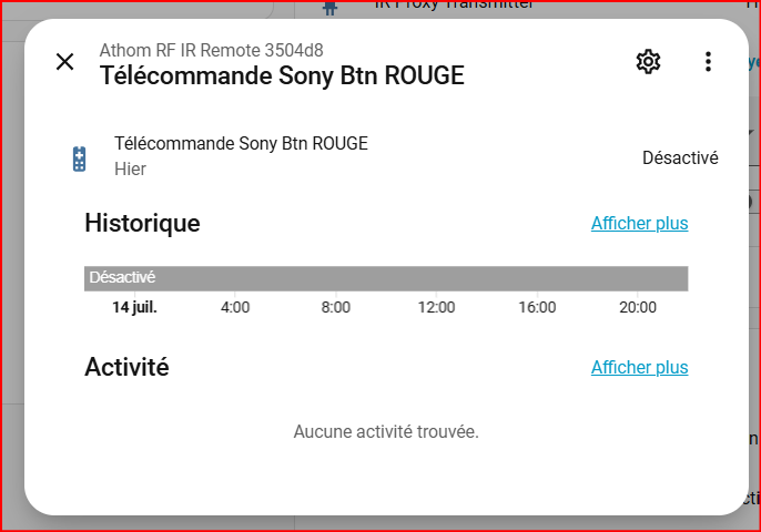

but it seems that my sensors doesn’t update
so automation doesn’t start.
can you explain me where I’m wrong ?
Try adding a delayed off filter.
Edit it seems your logs is saying turned off.
Perhaps it’s inverted.
Not sure if that means you need to invert the IR receiver or if you can just invert the binary sensor.
Did you read the NOTE section on the Remote Receiver - Binary Sensor page Hellis81 linked to?
Sorry I’ve read but not understood, so forgot.
I’ve added batch_delay: 0ms in api section. and now the IR triggers the binairy sensor.
thank you so much.
