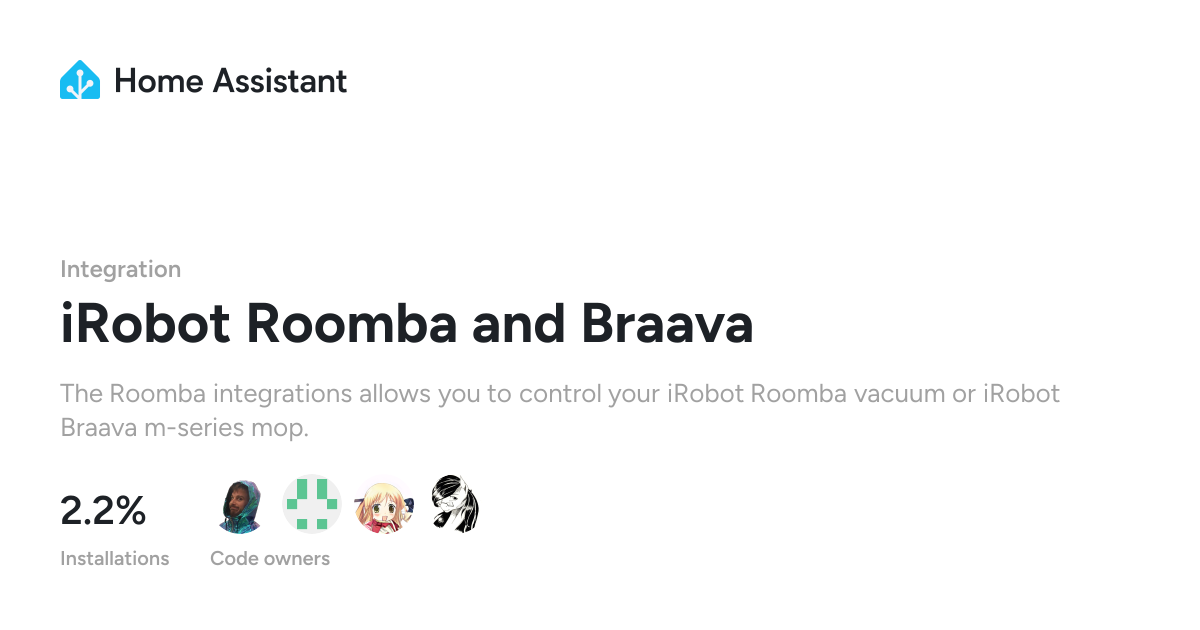

Can someone please help me with yhe irobot integration?
If this does not help, you need to be more specific about your issue.
