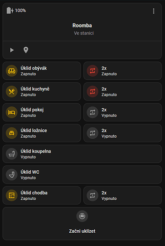

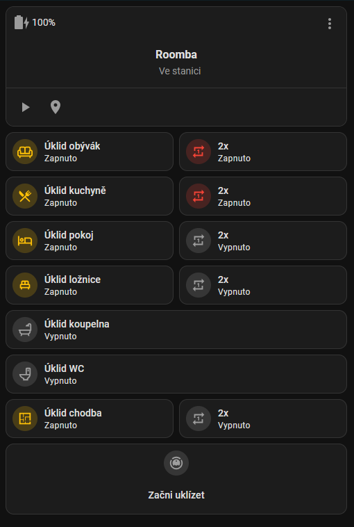

I just did that today with the iRobot integration (1x / 2x)

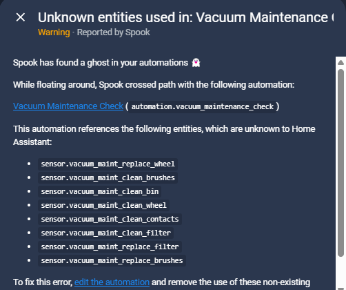

After installing HA 2025.3.1 the Spook integration has a problem with these sensors :
PS
I downloaded the package a couple of years ago, so maybe things are changed meanwhile… ?

  - alias: Vacuum Notify on Stuck Status
    initial_state: true
    trigger:
      platform: template
      value_template: "{{ is_state_attr('sensor.vacuum', 'phase', 'Stuck') }}"
    action:
      #- service: notify.vacuumfile
      #  data_template:
      #    message: "Stuck"
      - service: notify.send_message
          entity_id: notify.vacuumfile
          message: "Stuck"

  # Maintenance Check
  - alias: Vacuum Maintenance Check
    initial_state: true
    trigger:
      - platform: time_pattern
        minutes: /15
      - platform: state
        entity_id: [
          'sensor.vacuum_maint_clean_brushes',
          'sensor.vacuum_maint_clean_contacts',
          'sensor.vacuum_maint_clean_filter',
          'sensor.vacuum_maint_clean_wheel',
          'sensor.vacuum_maint_clean_bin',
          'sensor.vacuum_maint_replace_brushes',
          'sensor.vacuum_maint_replace_filter',
          'sensor.vacuum_maint_replace_wheel'
    action:
      - service: >-
          {% set ns = namespace(count = 0) %}
          {% for item in states.sensor if 'sensor.vacuum_maint' in item.entity_id and (state_attr(item.entity_id, 'timeout_timestamp') < as_timestamp(now())) %}
            {% set ns.count = loop.index %}
          {% endfor %}
          {% if ns.count > 0 %}
            input_boolean.turn_on
          {% else %}
            input_boolean.turn_off
        entity_id: input_boolean.vacuum_maint_due

Hello, I have this: The automation ‘Vacuum Notify on Finished Cleaning’ (automation.vacuum_notify_on_finished_cleaning) uses an unknown action: notify.vacuumfile."
