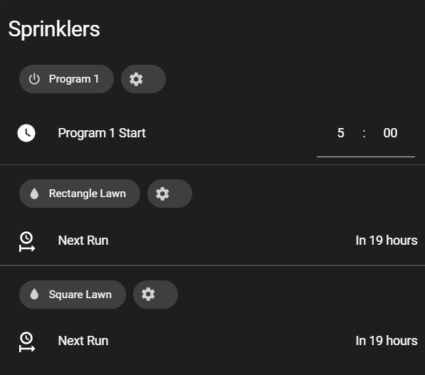

I’m sure this is a really dumb question - so sorry. I’m looking to rename the zones on the card only - ie would prefer not to rename the entities themselves. Is there an easy way to do it? Can’t figure it out.
Thanks in advance!
The card will present with the friendly name of the entity. So you will need to change the name of the switch or sensor. But this should not change the underlying entity naming.

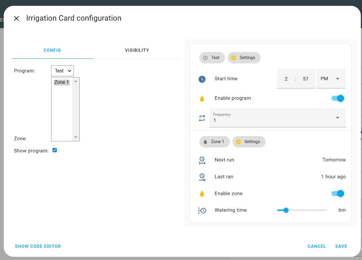

The show program option enables the field in the card.

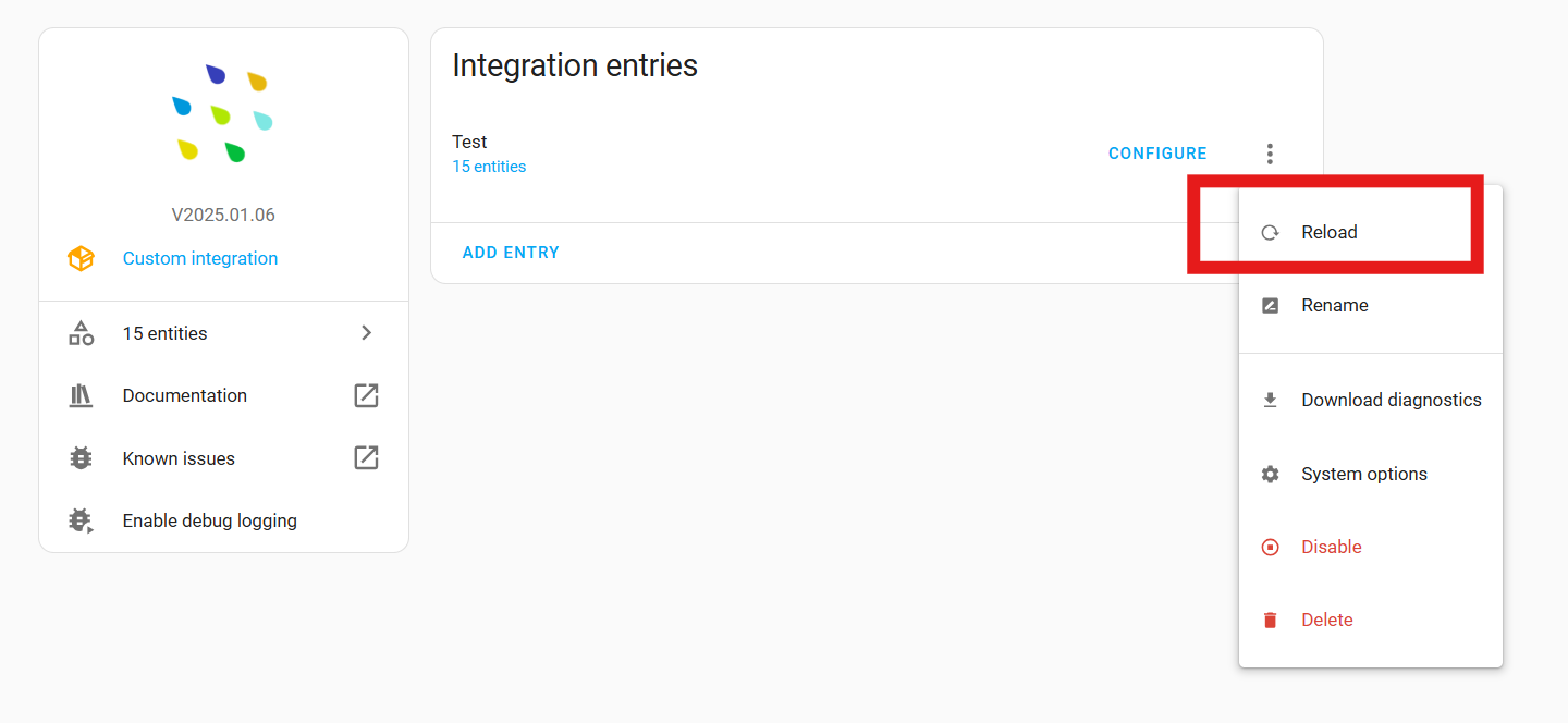

However if there is a lag loading the switches that represent your solenoids that the irrigation program uses you will need to manually reload the config. There is an issue outstanding on this for me to figure a better way of monitoring/alerting this.

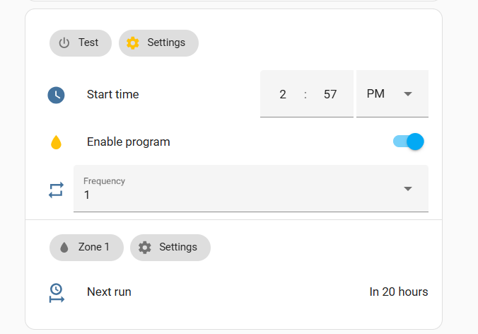

Thanks for the reply, have tried both of those things, and still no toggle unfortunately:
From the screen shot you don’t appear to have the latest. You should see settings next to the cog icon.
If you select the cog icon do more option appear?
