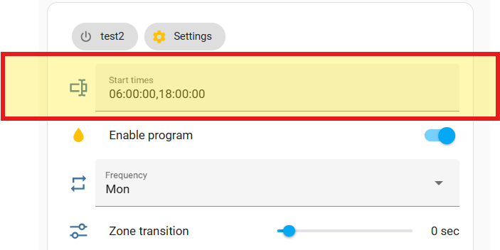

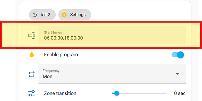

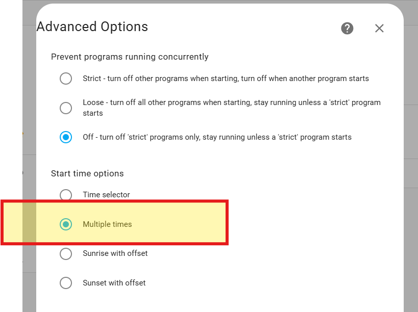

How do i configure to run the program/zone twice a day?
I have found the advanced options on reconfigure, but when i try to set it to multiple times i can see a short popup “expected str” and no change on submit.
Can a call a service to start the program by an automation?
Solved, had to select strict mode also.
You shouldn’t need to select strict mode.
Times are comma separated with no spaces
At first i did not select any option for the first topic, that resulted in the popup message. I think i don’t have a problem now with strict, as i only have one program.
I now have configured two start times.
I see, I will make sure that the program defaults this to Strict if it is not entered.

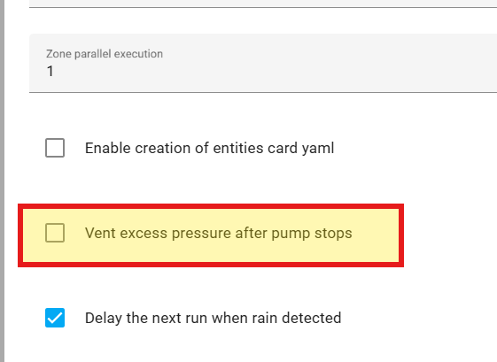

Ciao! is it possible to add a solution so that for example it finishes watering the last zone and 3 seconds earlier turns off the pump before turning off the zone valve. This will prevent maintaining high pressure in the pipes of around 7-8 bar until the next watering. the idea is that the water will flow out freely and relax the pipes.
The pump is not started explicitly for zone rather the pump monitors if the zone is running and then starts and stops based on the zone state, this supports the eco mode nicely.
Any simple solution would release the pressure between cycles when ECO mode is set, so I will need to ponder an effective solution.
There is an event that is called when the program ends. You could create an automation to open one of valves for a few seconds to release the pressure until I determine if I can meet this requirement in the app.
I have created a ticket for this in Github: Open valves to release pressure in pipes after pump is turned off · Issue #199 · petergridge/Irrigation-V5 · GitHub
V2025.07.01 has been release with the requested functionality.
The option needs to be turned on from the Advanced setting of the configuration.
In operation one of the zones, the first in the list of zones, will be opened for 3 seconds after the program has finished and the pump monitoring process has been stopped.
that’s good news, thank you for adding this functionality, I’ll be testing it today
