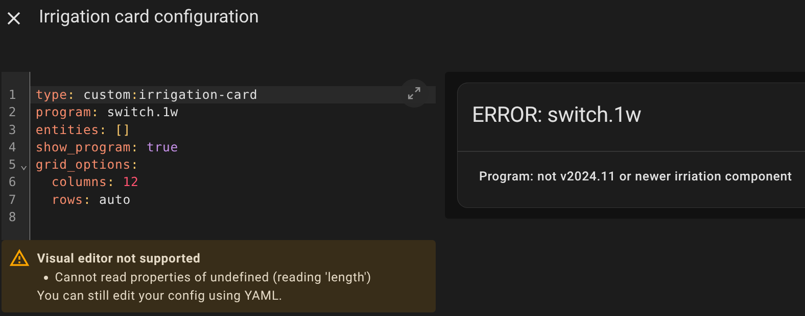

I’ve updated from V2025.07.03 to V2025.08.01, and now all irrigation custom cards show an error:
I’ve restarted HA, reloaded both programs, tweaked & updated both programs, but the error persists.
Any hint how to restore the cards?

Hi, Normally an f5 screen refresh will resolve the problem on the occasions it occurs for me. Over last few releases of HA the custom card has resulted in some issues for users that I cannot recreate (or possibly have the skill to resolve).
There is an option in the advanced settings that when set will generate the yaml required to recreate the custom card using the HA entities card as the base. Once turned on it will create a persistent notification, copy the code from there and create a manual card using this yaml. Not quite an exact replacement but very close to the custom card. Using this will be more stable as it is using the base HA features. But if you change the config don’t forget to update the card with the newly generated yaml.

Hi, This error probably indicates that the program has not fully loaded before the card is being processed by the Lovelace frontend.
I am adding delay logic to wait and try a few times before giving the error, I can’t guarantee it will resolve the problem as it is not something I can readily reproduce.
The card issue ā€˜resolved itself’ one day later. I can’t reproduce this, but it now works as expected. Thank you.

I installed the latest component card. Works perfecly fine. Have a problem with the card itself. It is showing Error ā€œProgram: not v4 or newer irriation componentā€.
Is there any version checking or cn You descibe what could be this problem about ? Comp ver 2025.08.07, card ver 2024.10.01.

Hi Rolo,
The card can be a bit hit and miss unfortunately, I have had a couple of people with this issue. Sometimes a simple F5 refresh of the browser helps, other times clearing the cache.
The final option is to enable the yaml generation option in the configuration. This will write the yaml code that creates an equivalent entities card to the notifications. Simply create a manual card and paste in the generated yaml.
The yaml will regenerate when the config changes.

working perfectly over time ! Thanks !
