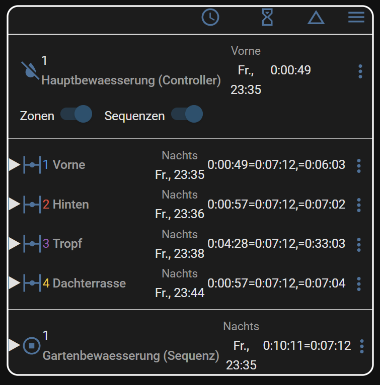

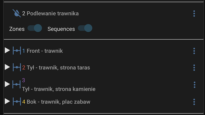

Working on a dashboard :slight_smile:

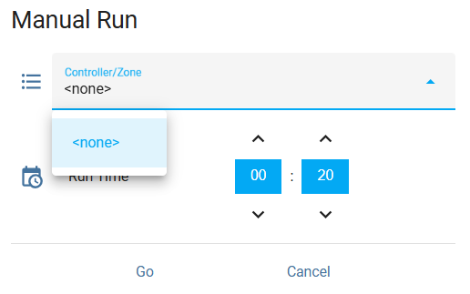

When manually setting times to all zones (normal scenario for us is to run everything for x minutes manually) and then starting via the manual run service call, disabled zones are running. Is it possible to respect disabled even if there is a time set on the zone?
Take a look at the allow_manual setting in the zone object. This controls if a manual run can be performed on a disabled zone.

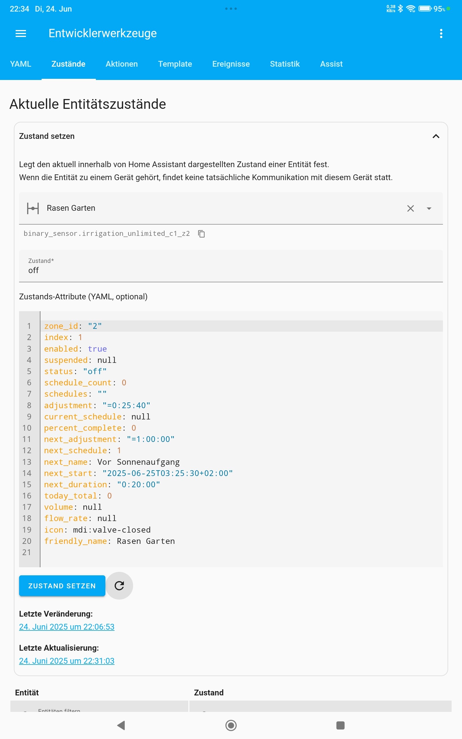

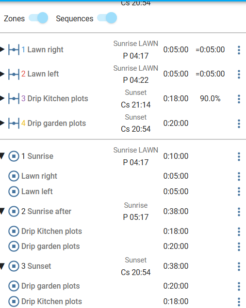

I run into a problem.
My config:
irrigation_unlimited:
controllers:
all_zones_config:
show:
timeline: true
config: true
zones:
- name: “Lawn right”
zone_id: “1”
entity_id: “switch.irrigation_switch_2_l1”
- name: “Lawn left”
zone_id: “2”
entity_id: “switch.irrigation_switch_2_l2”
- name: “Drip Kitchen plots”
zone_id: “8”
entity_id: “switch.irrigation_switch_2_l4”
- name: “Drip garden plots”
zone_id: “7”
entity_id: “switch.irrigation_switch_2_l3”
sequences:
- name: “Sunrise”
schedules:
- name: “Sunrise LAWN”
time:
sun: “sunrise”
before: “00:30”
zones:
- zone_id: 1
duration: “00:10”
- zone_id: 2
duration: “00:10”
- name: “Sunrise after”
schedules:
- name: “Sunrise”
time:
sun: “sunrise”
after: “00:30”
zones:
- zone_id: 8
duration: “00:20”
- zone_id: 7
duration: “00:20”
- name: “Sunset”
schedules:
- name: “Sunset”
time:
sun: “sunset”
after: “00:10”
zones:
- zone_id: 7
duration: “00:20”
- zone_id: 8
duration: “00:20”

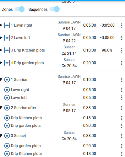

The “dashboard”
But on the manual run card I can’t choose any zones,controller:
The irrigation is running well, but sometimes i’d like to use this feature.
Logs are empty no error codes… :frowning: I tried to find what is the problem, but I failed.
of course i’ve installed the extensions (packages and additonal py script)
Thanks in advance for your help

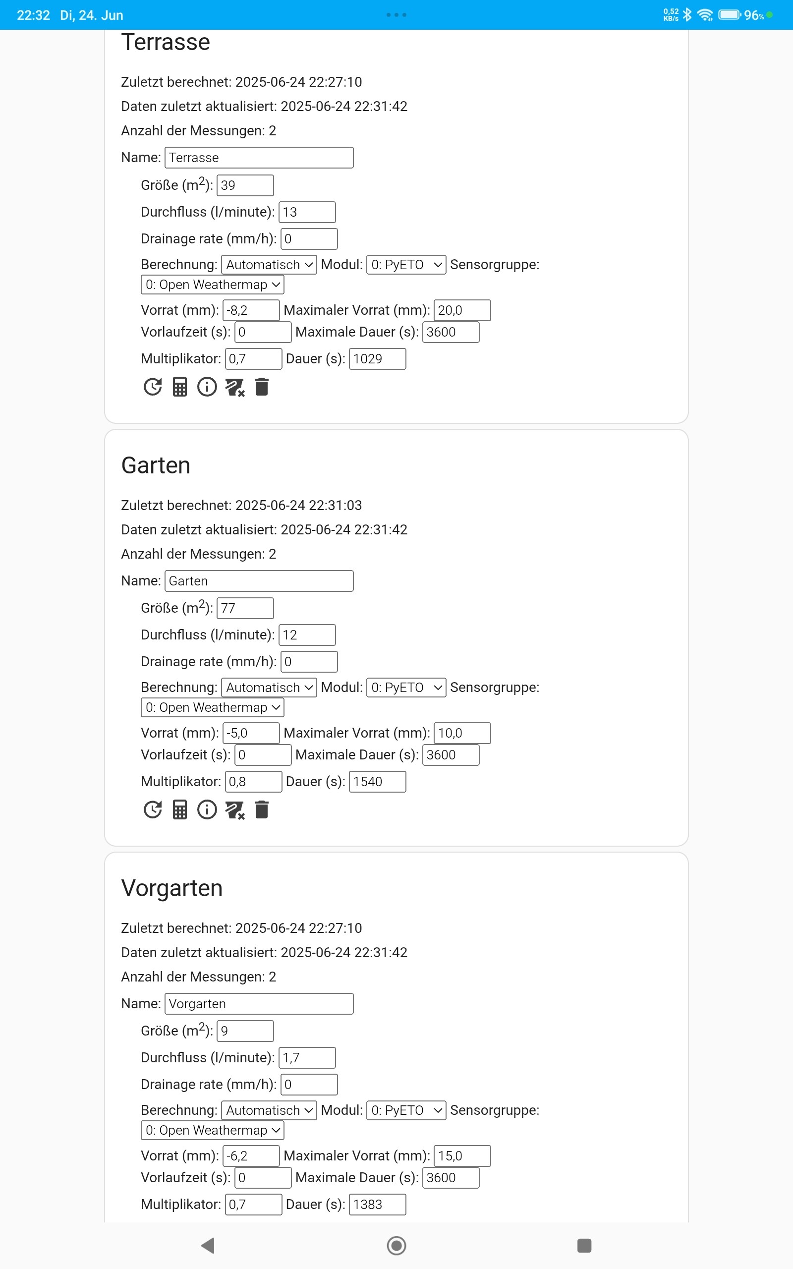

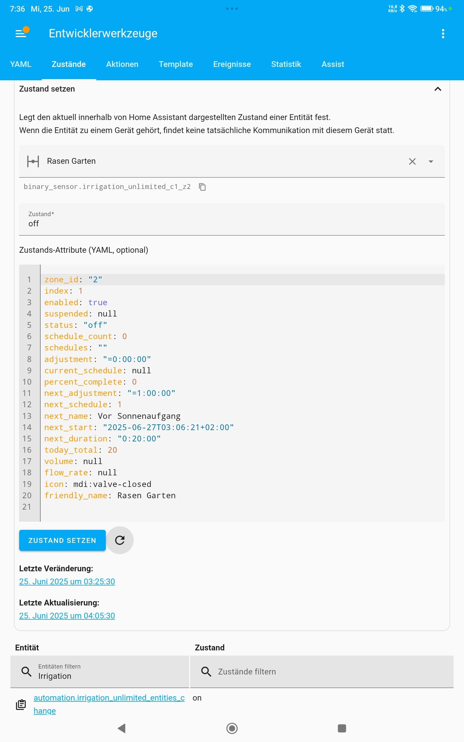

Hello everyone,
I’m really stuck with the adjustment of my irrigation (based on HAsmartirrigation). I looked into the documentation extensively and double checked all of it multiple times. However, despite syntax-correct config (it seems) and also successfull adjustments the actual irrigation time sticks to the same time of (always!) 20 minutes.
So I do have this configuration running successfully since some weeks:
# Documentation: https://github.com/rgc99/irrigation_unlimited
refresh_interval: 10
history:
  enabled: true
controllers:
  - name: "Rasenbewässerung"
    zones:
      # Rasen-Sprinkler
      # zone: 1
      - entity_id: "switch.ventil1_grau_terrasse"
        name: "Rasen Terrasse"
        maximum: "00:45"
        duration: "00:20" # Default running time when no time is provided (e.g. manual run)
      # zone: 2
      - entity_id: "switch.ventil2_gruen_rasengarten"
        maximum: "01:00"
        duration: "00:30" # Default running time when no time is provided (e.g. manual run)
      # zone: 3
      - entity_id: "switch.ventil4_lila_sprinkler_vorgarten"
        name: "Rasen Vorgarten"
        maximum: "00:30"
        duration: "00:25" # Default running time when no time is provided (e.g. manual run)
    sequences:
      - name: "Sommer"
        schedules:
          - name: "Vor Sonnenaufgang"
            anchor: finish
            time:
              sun: "sunrise"
              before: "01:05" # starting time: 30min before sun rise
            weekday: [mon, wed, fri, sat] # which weekdays to irrigate
            month: [jun, jul, aug] # which months this shedule is effective
        zones:
          # which zones are affected by this sequence config
          - zone_id: 2
          - zone_id: 1
          - zone_id: 3
      - name: "Frühling und Herbst"
        schedules:
          - name: "Frühling & Herbst"
            time: "06:30"
            weekday: [mon, wed, fri]
            month: [apr, may, sep, oct]
        zones:
          - zone_id: 1
          - zone_id: 2
          - zone_id: 3
  - name: "Tropfbewässerung"
    all_zones_config:
      maximum: "00:30" # maximum time to irrigate
      duration: "00:15" # default duration per zone (if not defined or manual run)
    zones:
      # Tropfbewässerungszonen
      # zone: 1
      - entity_id: "switch.ventil3_rot_hecken"
        name: "Tropfer Hecken, Terrasse & Radgarten"
      # zone: 2
      - entity_id: "switch.ventil5_gelb_tropfleitung_vorgartenterrasse"
        name: "Tropfer Vorgarten & Garage"
    sequences:
      - name: "Sommer"
        duration: "00:15" # duraton of irrigation for each zone
        delay: "00:01" ## delay inbetween irrigation
        schedules:
            time:
              sun: "sunrise"
              before: "01:30" # starting time: 1h 30min before sun rise
            duration: "00:30" # extend the sequence duration (see above) to 30min in total (for all zones together!)
            weekday: [sun, tue, thu] # which weekdays to irrigate
        zones:
          - zone_id: 1
          - zone_id: 2
        duration: "00:10"
        delay: "00:01"
        schedules:
            time: "06:30"
        zones:
          - zone_id: 1
          - zone_id: 2
I also do have an automation for each of the zones of the first controller above which are all successfully executed at 23:00. They all look like this:
alias: Smart Irrigation Anpassung Rasenbewässerung Garten
description: Adjust watering times based on smart irrigation calculations
triggers:
  - trigger: state
    entity_id:
      - sensor.smart_irrigation_garten
    to: null
actions:
  - action: irrigation_unlimited.adjust_time
      actual: "{{ timedelta(seconds=trigger.to_state.state | int(0)) }}"
      entity_id: binary_sensor.irrigation_unlimited_c1_z2
mode: single
I also do have a reset bucket automation like this successfully executed when irrigation is finished:
alias: Smart Irrigation reset bucket - nach Rasenbewässerung
description: Resets the Smart Irrigation bucket after watering
triggers:
  - trigger: event
    event_type: irrigation_unlimited_finish
conditions:
  - condition: template
    value_template: "{{ trigger.event.data.schedule.index is not none }}"
  - condition: or
    conditions:
        value_template: >-
          {{ trigger.event.data.entity_id ==
          'binary_sensor.irrigation_unlimited_c1_s1' }}
        value_template: >-
          'binary_sensor.irrigation_unlimited_c1_s2' }}
actions:
  - action: smart_irrigation.reset_bucket
    entity_id: sensor.smart_irrigation_garten
    data: {}
mode: single

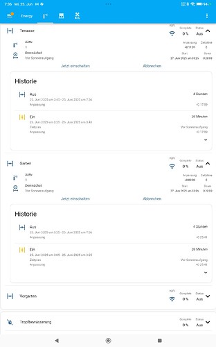

So with all of this in place I checked yesterday evening (long before irrigation this morning) and manually triggered the smartIrrigation-calculation to calculate irrigation times:
Then I checked the irrigation-unlimited-entity for that zone and saw the attribute “adjustment” being adjusted to the value calculated by smartIrrigation:
So far so good.

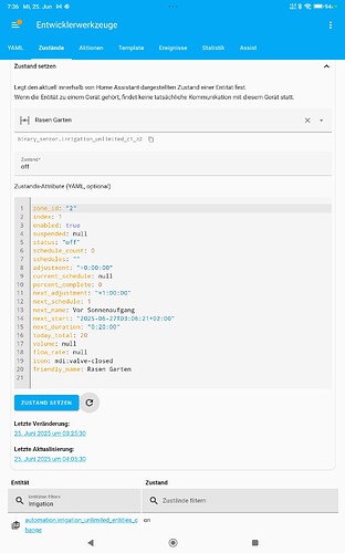

This morning I checked the run time and the zone (as any other) was irrigated for exact 20 minutes (again!):
Not sure if relevant, but the entity looked like this then:
I did not yet switch on debug-logging (but did so now, while writing the post) however, the logs for now just show a warning I don’t see related:
So I’m puzzled like hell where this 20 minutes limit is coming from…???
Does anyone see clearer?

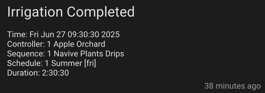

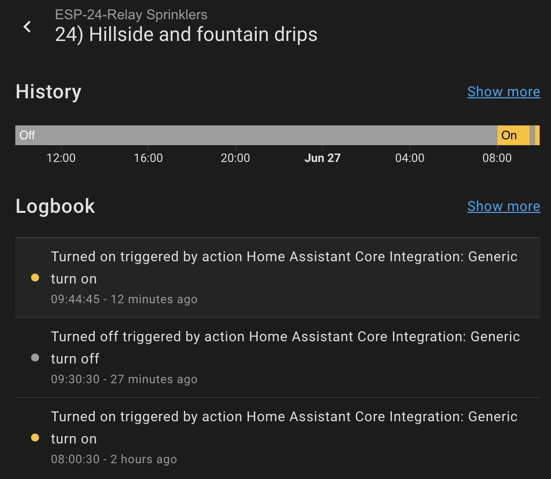

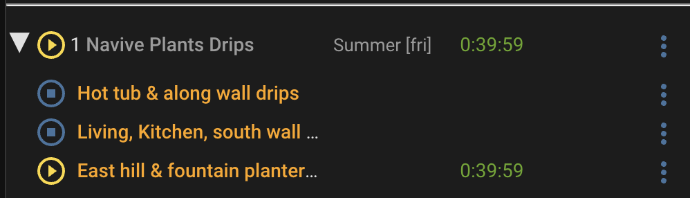

Is nobody else seeing this odd behavior where a sequence can’t be stopped?
Today I got a notification that a sequence had finished:
which is for this sequence (which is now running again).

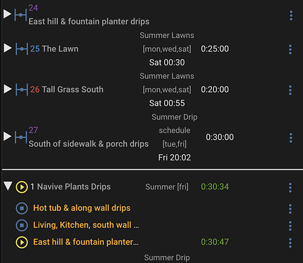

My wife had disabled the first one by mistake (she wanted to disable the second one). So I enabled the “Hot tub…” one and then the East hill started up. Again.
And now when I click on Cancel on the “Native Plants Drips” it doesn’t stop. But, I have addiional “Irrigation Complete” notifications in Home Assistant.
You can see here on the logbook for the physical valve swtich that it first turned on at 8:00am and off at 9:30. But, then at 9:44am is when I re-enabled the “Hot tub & allong wall drips” and then that zone started up again.
Canceling the sequence does not stop it. But, I was able to cancel the individual zone 24 (which then turned off the valve), but the sequence is still running:
And the controller now shows an hourglass.
Here’s the sequence.
    sequences:
      # 1 ------------ New low-water native plants -------------
      - name: "Navive Plants Drips"
        delay: 30
        # Default for each zone is one hour
        duration:
          hours: 1
        zones:
          - zone_id: d1   # Drips at hot tub and wall
          - zone_id: d20  # Living planter, gas meter, and south wall.
          - zone_id: d24  # Hill and bottom of fountain
            # This zone's defult is one hour thrity minutes
            duration:
              hours: 1.5
        schedules:
          - name: "Summer [fri]"
            time: "07:00"
            month: [may,jun,jul,aug,sep]
            weekday: [fri]
          - name: "Spring/fall"
            time: "07:00"
            month: [apr,oct]
            weekday: [tue]
            # This is total run time for the sequence
            duration:
              hours: 1

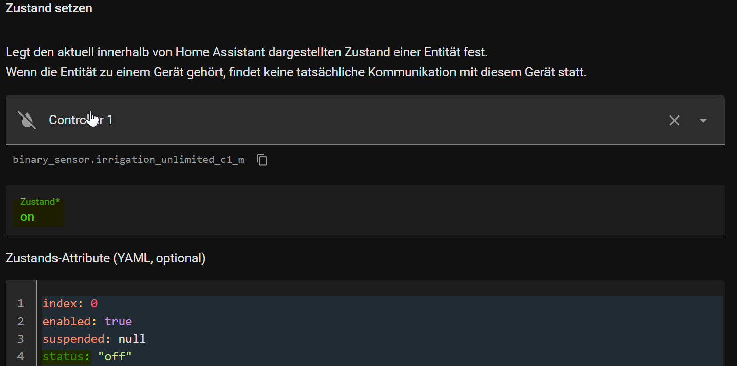

thanks for this great integration!

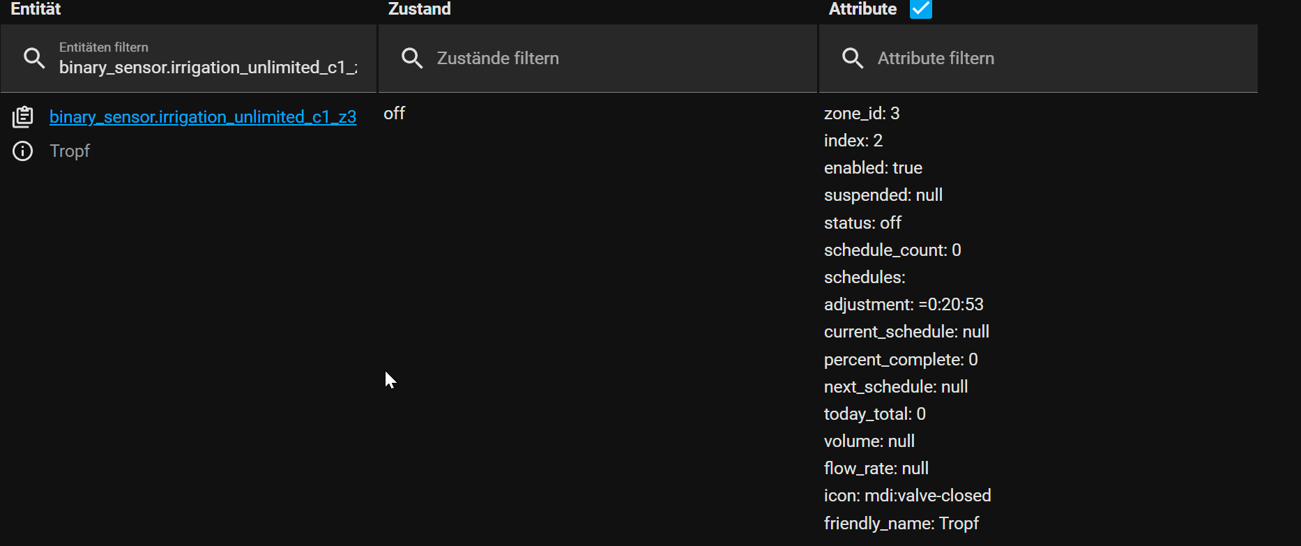

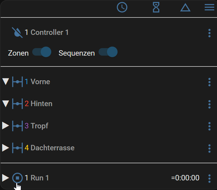

I am struggling a lot currently with irrigation unlimited.
For some reason, the automatic watering seems not to be executed.
I notice, that my automations that connect smart_irrigation with Irrigation Unlimited do work.
An update in smart_irrigation updates the respective sensor in IU.
The sensor looks like this:
This is the general configuration:
  controllers:
    zones:
      - name: "Vorne"
        entity_id: "switch.bewasserung_vorne"
      - name: "Hinten"
        entity_id: "switch.bewasserung_hinten"
      - name: "Tropf"
        entity_id: "switch.bewasserung_tropf"
      - name: "Dachterrasse"
        entity_id: "switch.bewasserung_dach"
    sequences:
      - delay: "00:01"
        schedules:
          - name: "Nachts"
            time: "23:35"
            month: [apr, may,jun, jul, aug, sep]
        zones:
          - zone_id: 1
            duration: "00:10"
          - zone_id: 2
            duration: "00:10"
          - zone_id: 3
            duration: "00:10"
          - zone_id: 4
            duration: "00:5"
What is notable: The card also does not display the durations:
Do you have any idea, what could be wrong here?
Greetings,
Hendrik
Edit:
the state of the controller was “off” previously (no idea why).
Now I set it to on
but it remains off:
index: 0
enabled: true
suspended: null
status: "off"

Was that the issue?
The times are still not displayed in the card though…

What is still unclear for me is the meaning of what the card says:
this integration has been working fine until it’s not. I guess it may have something to do with recent HA updates…(?)
Usually there was future watering time displayed in dashboard card and now, card remains “empty” and watering doesn’t start automatically as per schedule (and adjustment is now over 100%).
It is still possible to run it manually.
And I don’t see in logs:
Setting up irrigation_unlimited
I’ve reinstalled it (HACS) and still is the same. How to fix it?
