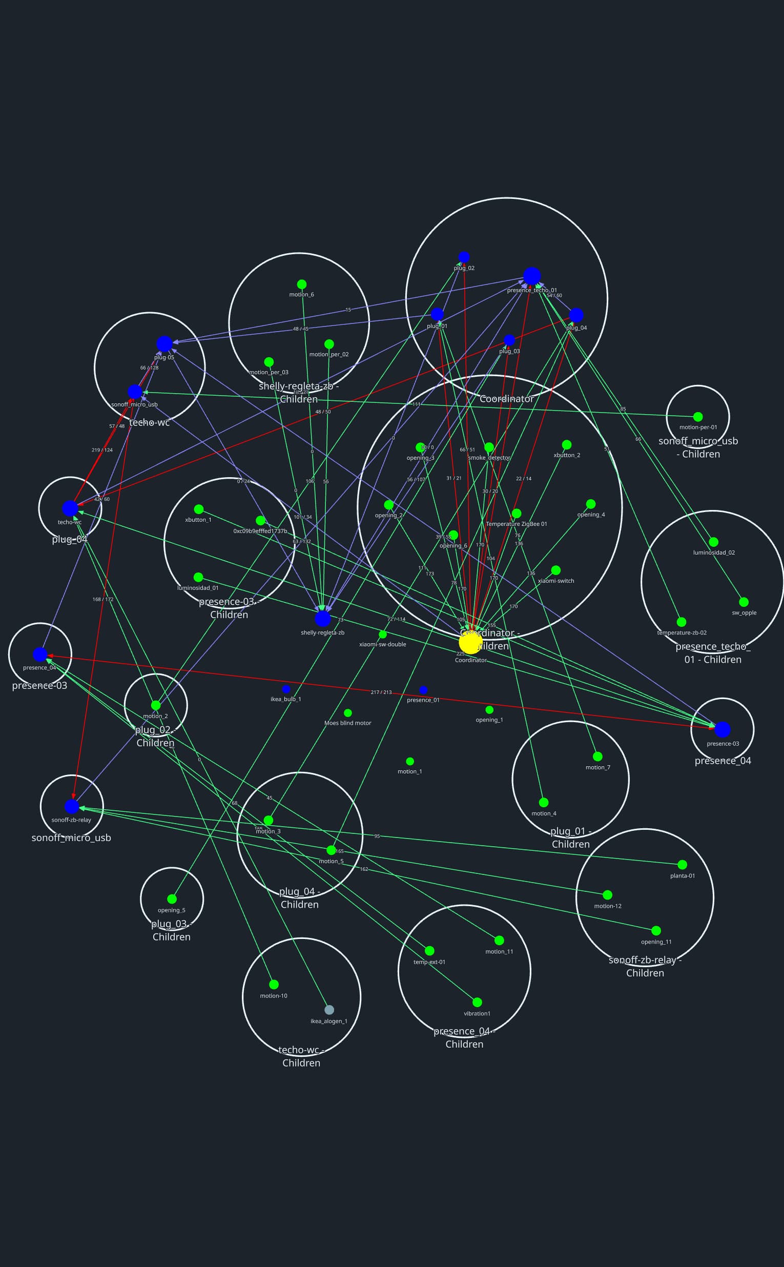

THis is how my network looks like:
(if there is a better way to export it other than screenshot, please let me know)

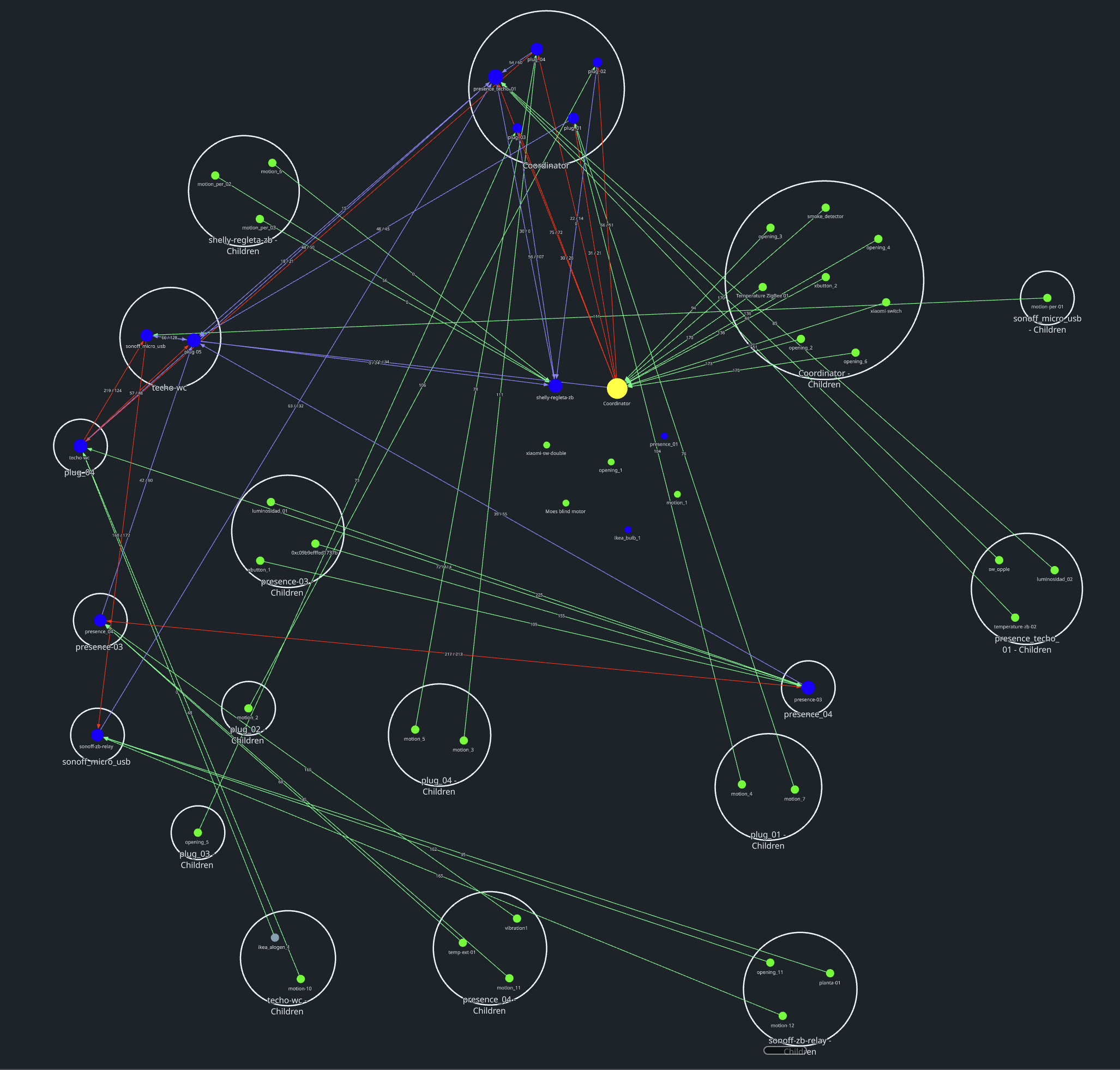

EDIT:
O, here is a better export of the map:
My point was that looking at startup times and how many seconds / minutes you waste every time you need to reboot is probably the wrong way to attack the problem. You want to figure out why you are forced to reboot every month, not shorten down the boot time :slight_smile:

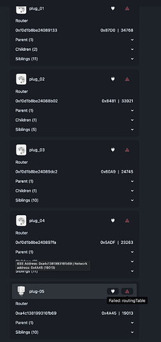

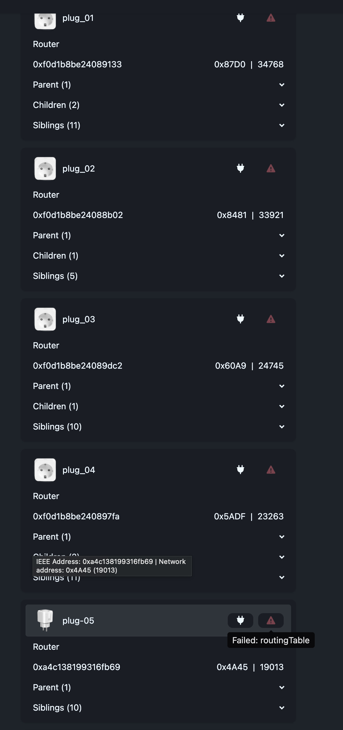

Some of my plugs are showing this warning whent rying to get the map:
The routing table error is probably due to a weak mesh. From your picture it seems that you have poor meshing overall.
I’ll try to post a little map of where my devices are and see if people can help me figure out why my mesh is so poor, because I don’t think they are that much apart from each other.

I think the combination of the router/end device ratio and that the coordinator is placed isolated from most of the network is what you want to look at. You could try moving the server and coordinator temporary more centrally (if that is an option) to see if that helps on the mesh.
