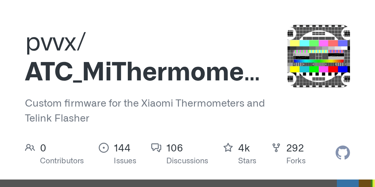

Not quite right. Digital thermometers (also hygrometers) with displays can be owned if one actually cares. Therfor it is possible to calibrate them directly on the device. :raised_hands:
But obviously that is not the case when just buying random stuff. We have plenty of this xiaomi thingies which are running pvvx firmware and allow local calibration beside many other features :thermometer:
It goes even that far that states from HA can be shown on the display which is quite a usefull addition we make use of :ok_hand:
