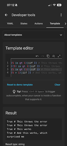

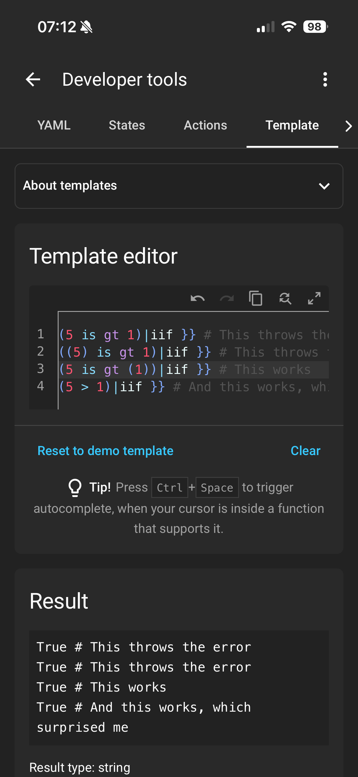

{{ (old.warnings|count is gt new.warnings|count)|iif }} # This throws the error
{{ ((old.warnings|count) is gt new.warnings|count)|iif }} # This throws the error
{{ (old.warnings|count is gt (new.warnings|count))|iif }} # This works
{{ (old.warnings|count > new.warnings|count)|iif }} # And this works, which surprised me
Both new.warnings|count|typeof and old.warnings|count|typeof return int and they are valid numbers that I can add and subtract etc. with reckless abandon.
So WTF don’t I understand about the comparison that makes the second part of this expression not work? And yes I reversed them to see what happens, it’s the second value that fails each time.

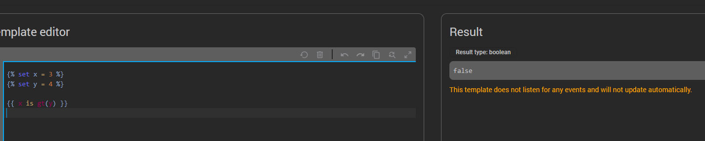

{% set old = {'warnings': [1,1,1,1,1]} %}
{% set new = {'warnings': [1]} %}
{% set x = old.warnings|count %}
{% set y = new.warnings|count %}
{{ (x is gt y)|iif }}
