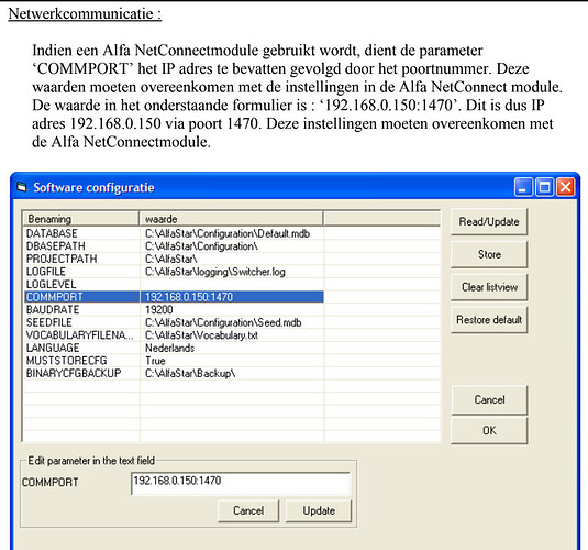

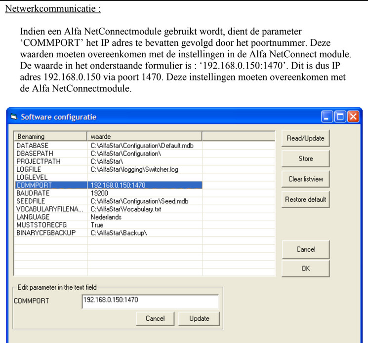

The manual states the following under communication:
(I have provided a translation below the image)
If an Alfa NetConnect module is used, the parameter “COMMPORT” must contain the IP address followed by the port number. These values must match the settings in the Alfa NetConnect module.
The value in the form below is: “192.168.0.150:1470”. This is therefore IP address 192.168.0.150 via port 1470. These settings must match the Alfa NetConnect module.

What happens when you point your web browser to that address 192.168.0.150:1470? How about 192.168.0.150:80?

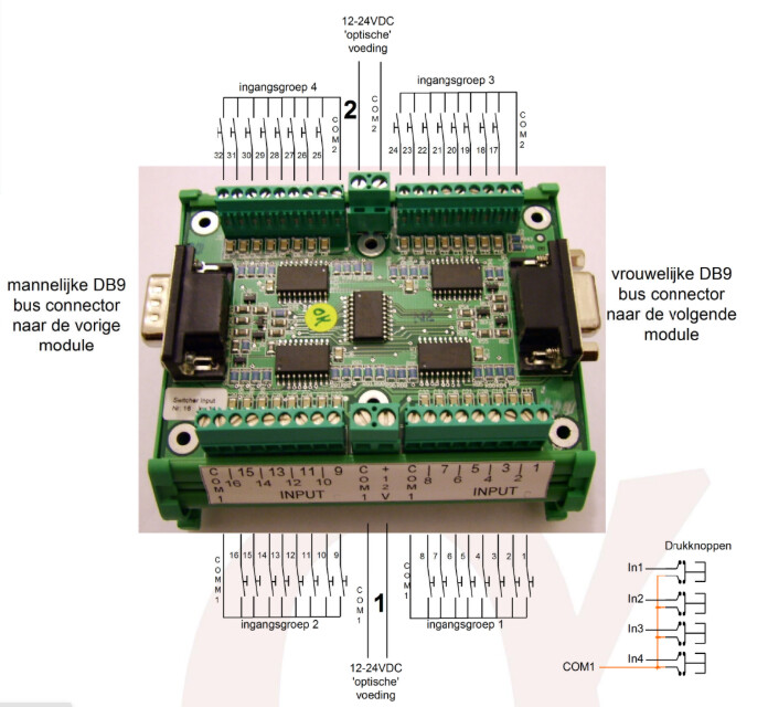

Hello, thank you for your answers. I’m glad you want to help me further. I contacted the supplier and he was willing to share the protocol. You can find the link to the PDF here
In the beginning, there was an app. The information/manual about this app can be found here.

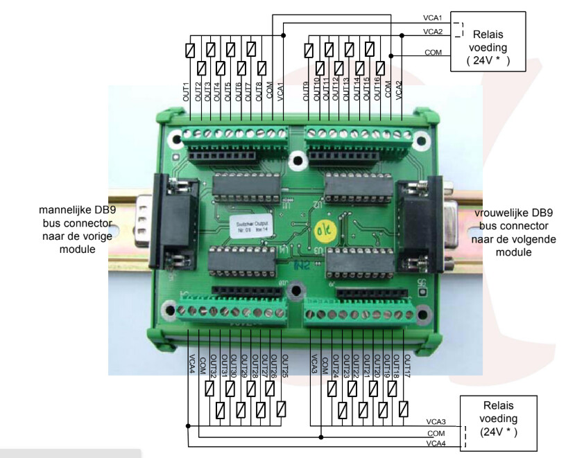

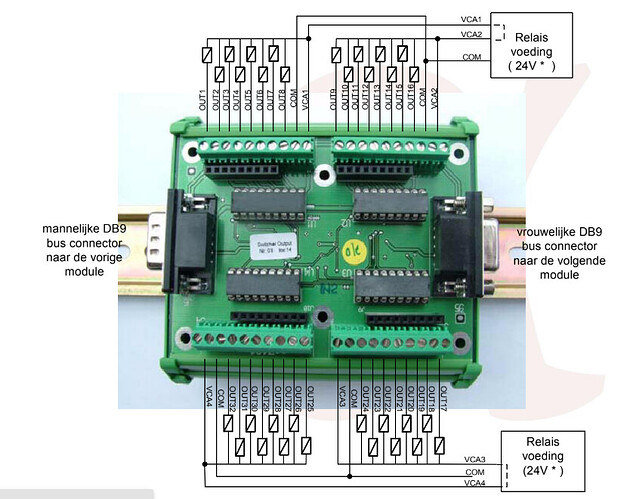

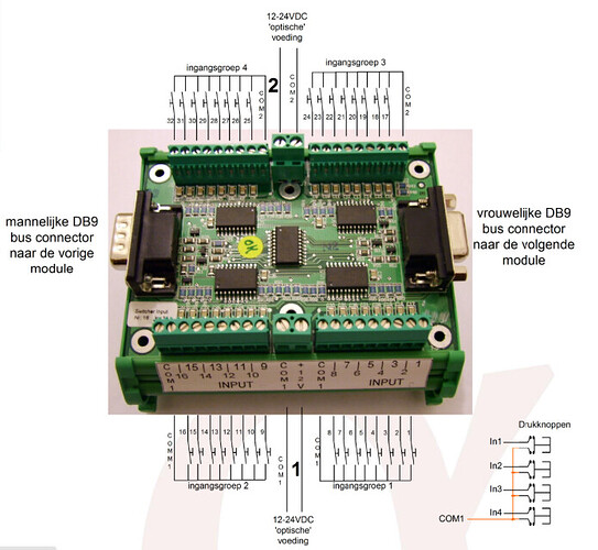

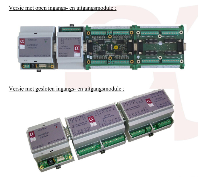

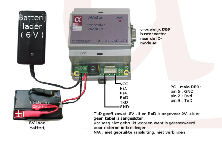

Here some pictures of the hardware:
I’m not an expert so take what I write with caution.
There is an exposed low voltage serial (the bottom right white connector) so adding a WiFi device like esp8266 board is simple, then you need to use the provided PDF to craft the correct commands and send them via the esp to the controller.
If I had to do it I ‘ll try to program the esp (esp home??) to espose REST API that translate GET and PUT to serial read and write commands to the serial…

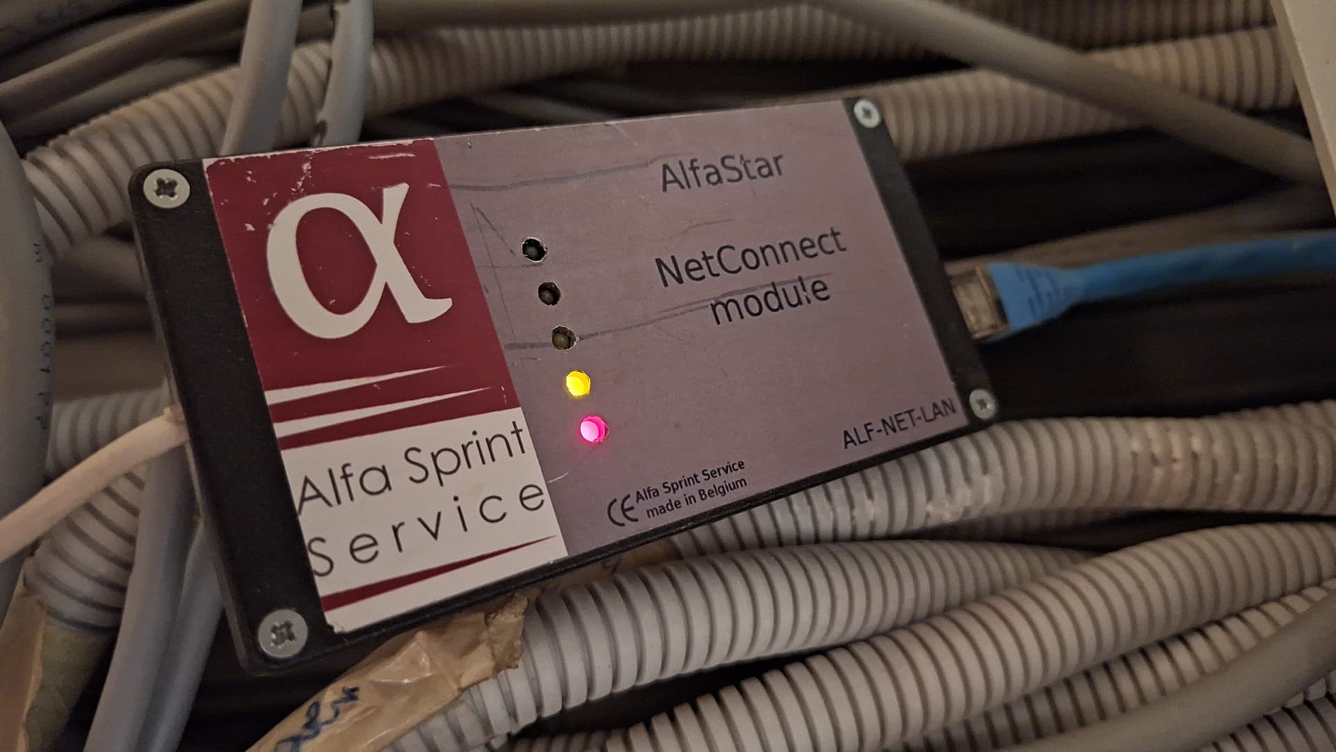

The controller module is now connected to my network via this network module.

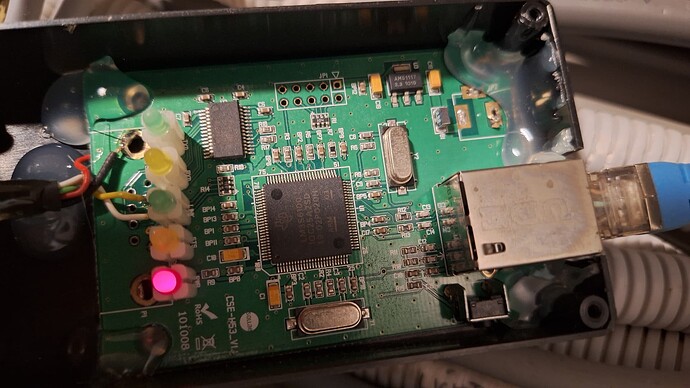

I opened the netconntect module. It looks like this.
For what I understood the netconnect is only used for programming so I’m not sure is the right way to integrate.

You have been lucky the developer has released the documentation for the codes to address the I/O Modules, which appear at first glance to be fairly generic DIN mounted digital/analog 24V input and output multiport devices.
I presume the 8 volts on the serial port should be able to be decoded by a simple RS232 interface which is +/- 12volts for true RS232 and not 0v/+5v for cheap Chinese knockoffs. Alternatively, it may be a RS485 bus.
English is my first language so I have difficulties reading the Dutch notes in the diagrams, but they look to be modules that are driven by commands over the interconnected serial bus according to the English pdf file you have linked to.
Your challenge is to examine what is connected to each port on these devices, and what commands related to that device are used for command and device response.
You should be able to build a state lookup table that you can then convert to Python to make a driver for your system.

A closeup photo of the various ICs on the NetConnect, and input and output boards to identify the interface chip numbers would be very interesting for me. The five on the input board, the four on the output board, and the two big ones on the NetConnect board. Any closeup photos of the inside of the controller/power supply module to the far left?
