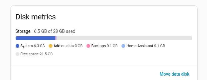

So, given a rPi4 with >=2GB of RAM, you probably have a suitable box to make into a home assistant. My HA reuses a 32GB micro-sd which had booted that same rPi4 previously and presently occupies about 6.5GB of it. To write from that rPi4 running raspbian on a second micro-sd, to a micro-sd on a usb micro-sd adapter, I’d used Raspberry Pi Imager from the usual raspbian desktop.
I’m doing things slowly and thoroughly - a wifi smart plug has kept me busy so I cannot comment on sd storage usage for bigger tasks. By default, a couple of hundred entities retain a data point at noticeable changes to their number or state, with programming effort on the part of HA having tried to evade too many writes to the database. It is storing less MB than I’d expected and retaining histories for almost two weeks, it would seem.

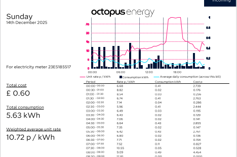

I created automations to schedule an ordinary fan heater on the smart plug to run at times of lower electricity price. Attached is an example page from my electricity bill.
That chart by Octopus energy shows one day of “Agile” variable-price (pink), with DCC smart metering by halfhour intervals as dark bars. Taller bars were HA controlled activations of the fan heater.
