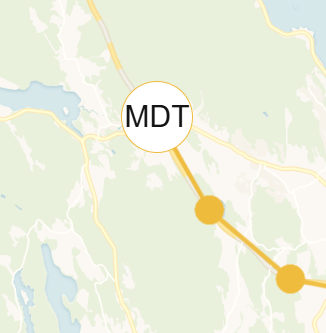

Is it not possible to use a template in the title for the map card?
I have a few map cards for my electric car, and I would like the titles of the maps to include the electric range, so I won’t have to jump up and down to check that while following my wife from charging station to charging station on longer trips, or the one today, a long trip in cool weather (just above zero - not the weather an EV enoys most) with a big trailer… :joy:
I tried this:
title: "{{ sensor.mastiff_range_electric }}"
But that only shows this:
Moving the quotes inside the curly brackets gave me “object object”. So does that mean that the title simply doesn’t support any templating?
It would be even better if I could exchange the name on the car from MDT (Mastiff Device Tracker) to the sensor value, but maybe that’s not possible either?
